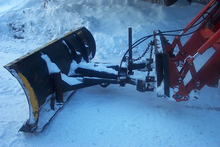

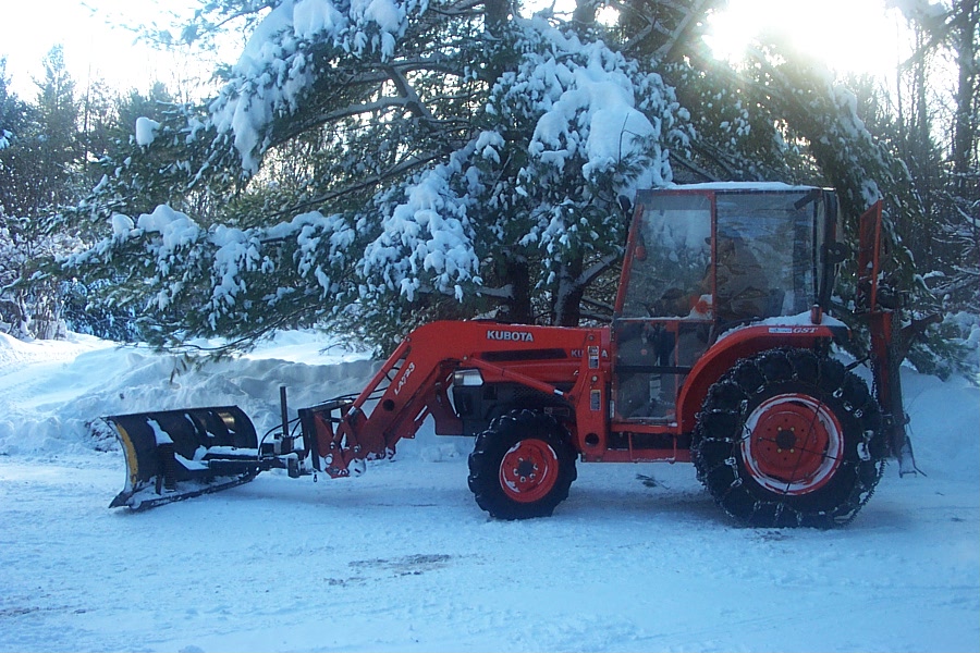

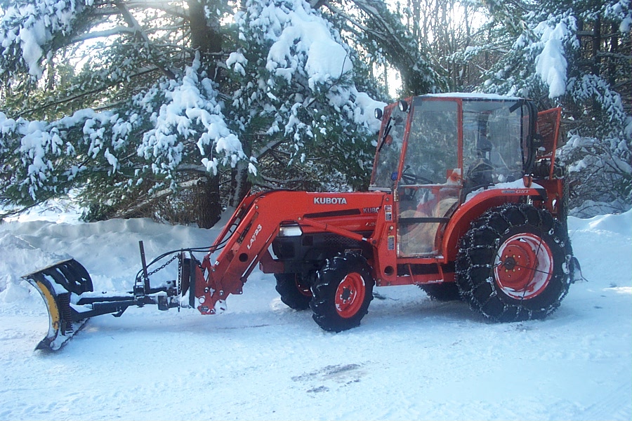

/ snow plow #5
This is what mine looked like when it was on my L 3830.
/ snow plow #6
That is what I don't like about loader plows.... they stick out 8' beyond the front tires. Easily push around especially on ice. On a frame mount I can angle the blade and have it within an inch or two of touching the front tires.
/ snow plow #7
I was plowing 2 feet of snow last winter and it never pushed me around. I used that rig for 5 years and the only time it pushed me sideways was when it dug into unfrozen ground.
/ snow plow #8
Is this to say that by having the plow closer to the front tire that you will not get pushed around.
/ snow plow #9
As long as you have your shoes set on the plow so that the blade doesn't dig in you won't have a problem. At least I haven't yet. The other plus is the farther it sticks out, the farther you can push it over a the edge of your drive or snowbanks.
