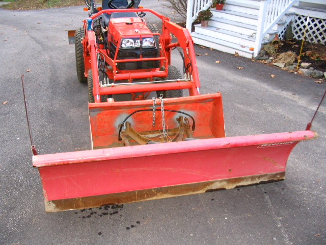

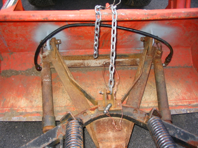

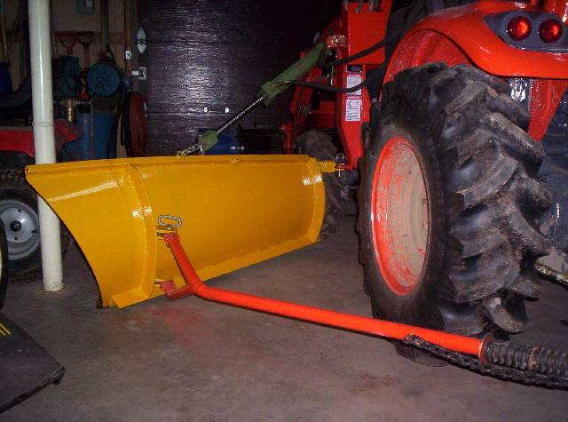

I agree with your own conclusion about the torque issue..also the added uneven stress on the blade mounts...
How about a wider blade? Either a rear blade or a front mounted blade. With the wider blade you can push the snow further to the side and keep the wheels on the road. I picked a used on up for $200 and did some quick welding..Works great...even if you don't weld ..a shop will be able to do this sort of mount in less than 30 - 60 minutes..
Even with the snow plow., I still occasionally have to do the " clean up" push back... I wait for a sunny day and do it at my leisure..
Oh yeah, since this photo I've added hydraulic controls for the blade...But be carefule you don't torque the FEL arms with an angled plow...Plow strainght and then clean up the banks angled...

I use my loader as well all winter, thats why I made my quick mount plow.. leaves the loader in place, and really make snow plowing more efficient... Good Luck..
