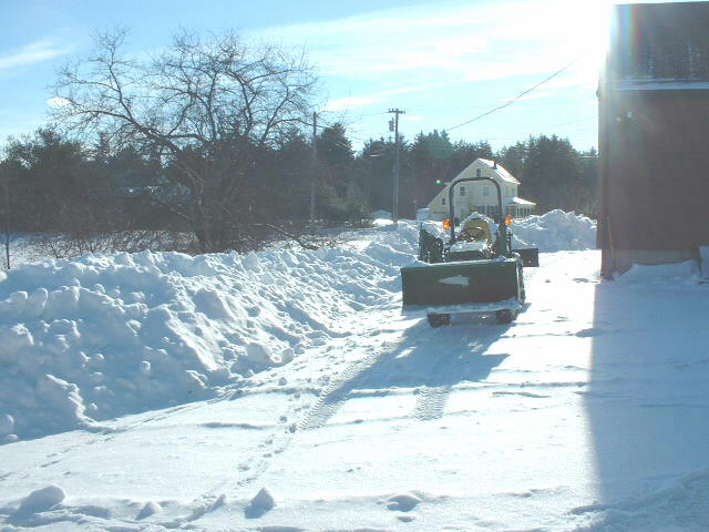

R4 tires and duogrip chains work fine for me. /w3tcompact/icons/grin.gif
DFB
