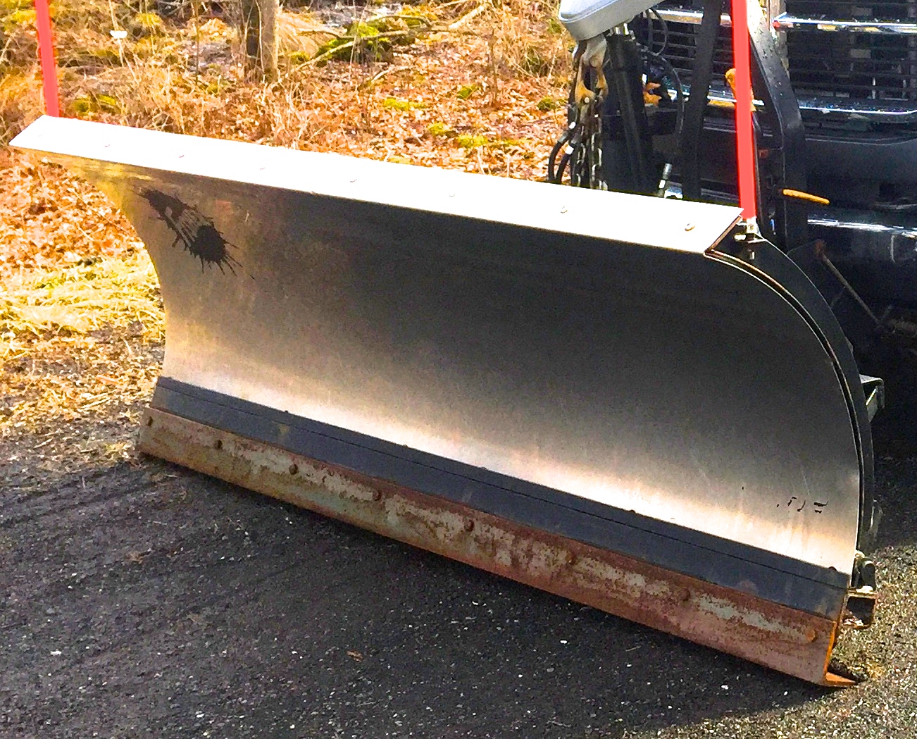

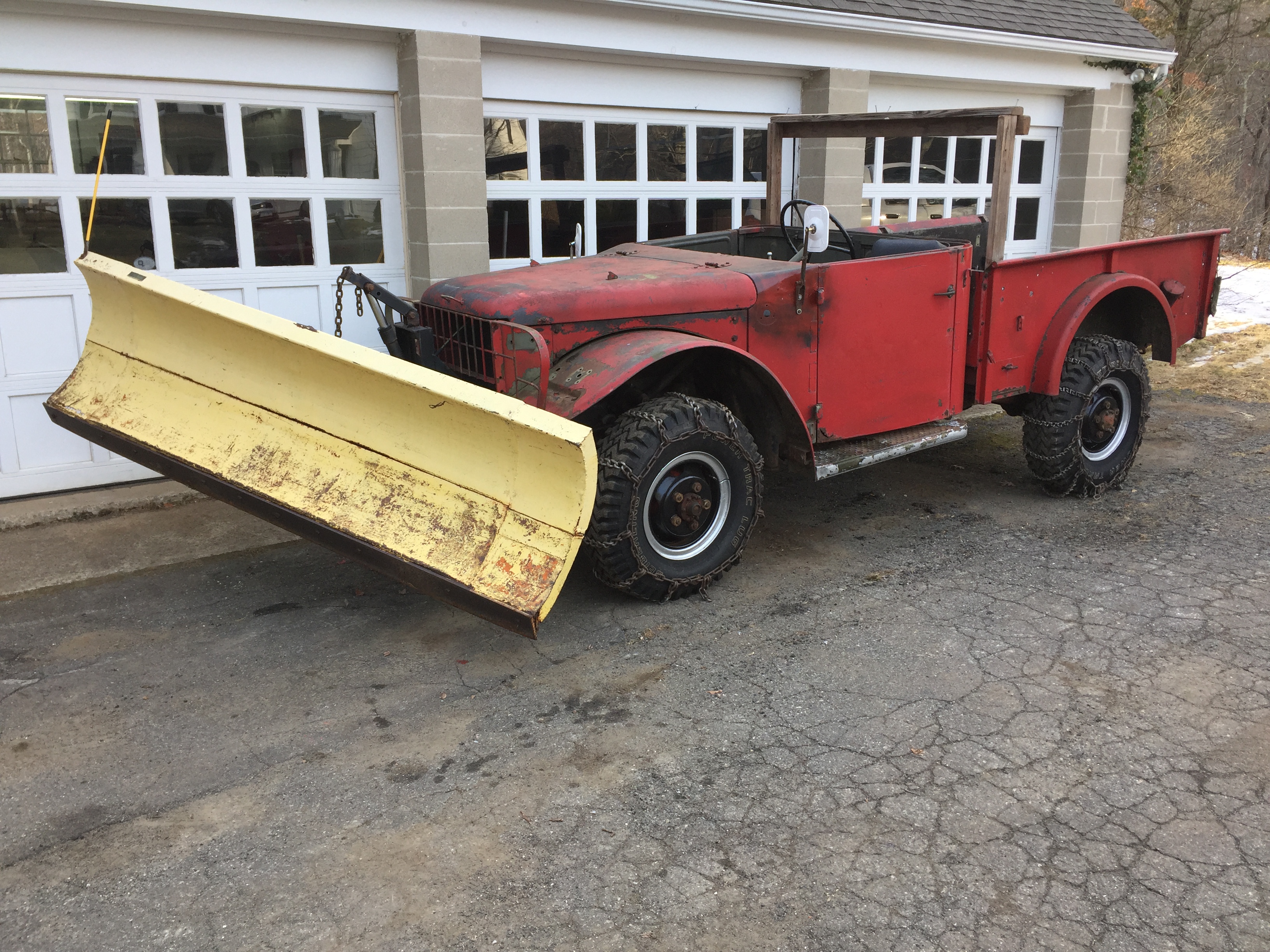

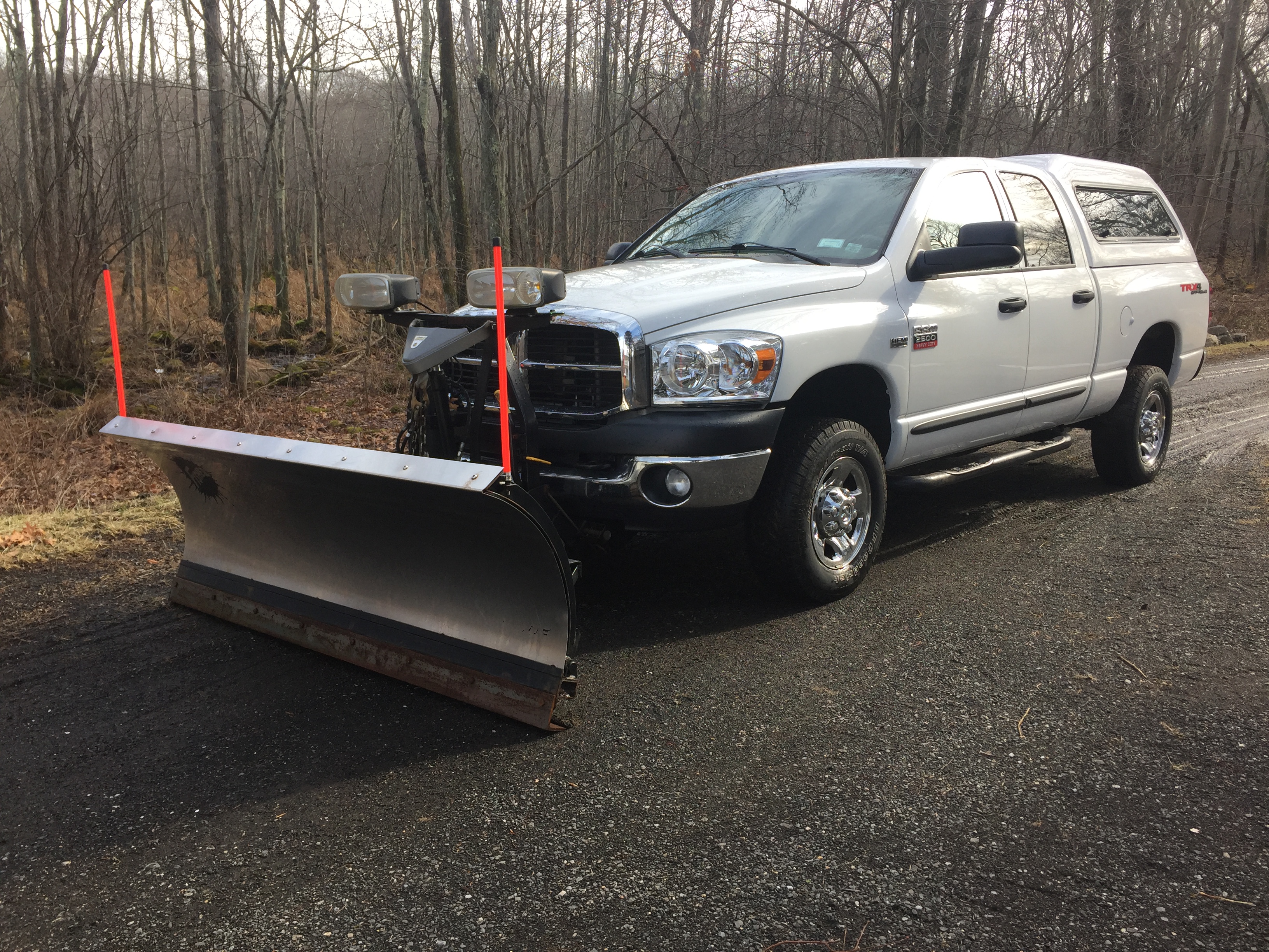

The gravel drive solution is simple. Replace your cutting edge with a heavy piece of angle. I did it on my new 90" Meyer Minute Mount with a 4x4x 3/8". You can grade anything smooth in the Fall and Spring. I also have an old 9' Meyer dirt drive plow from the 30's that works great on my "Monster M37".
