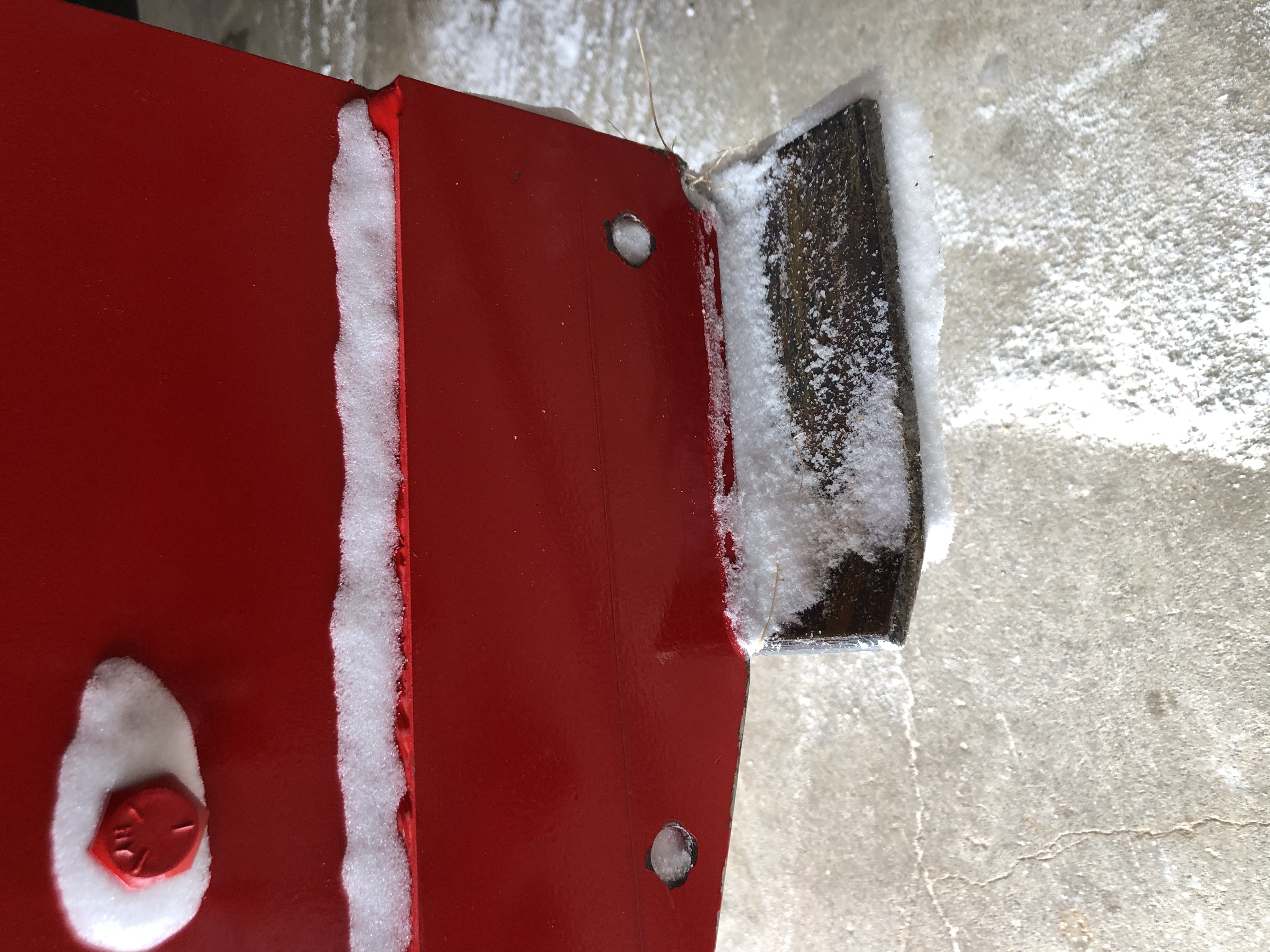

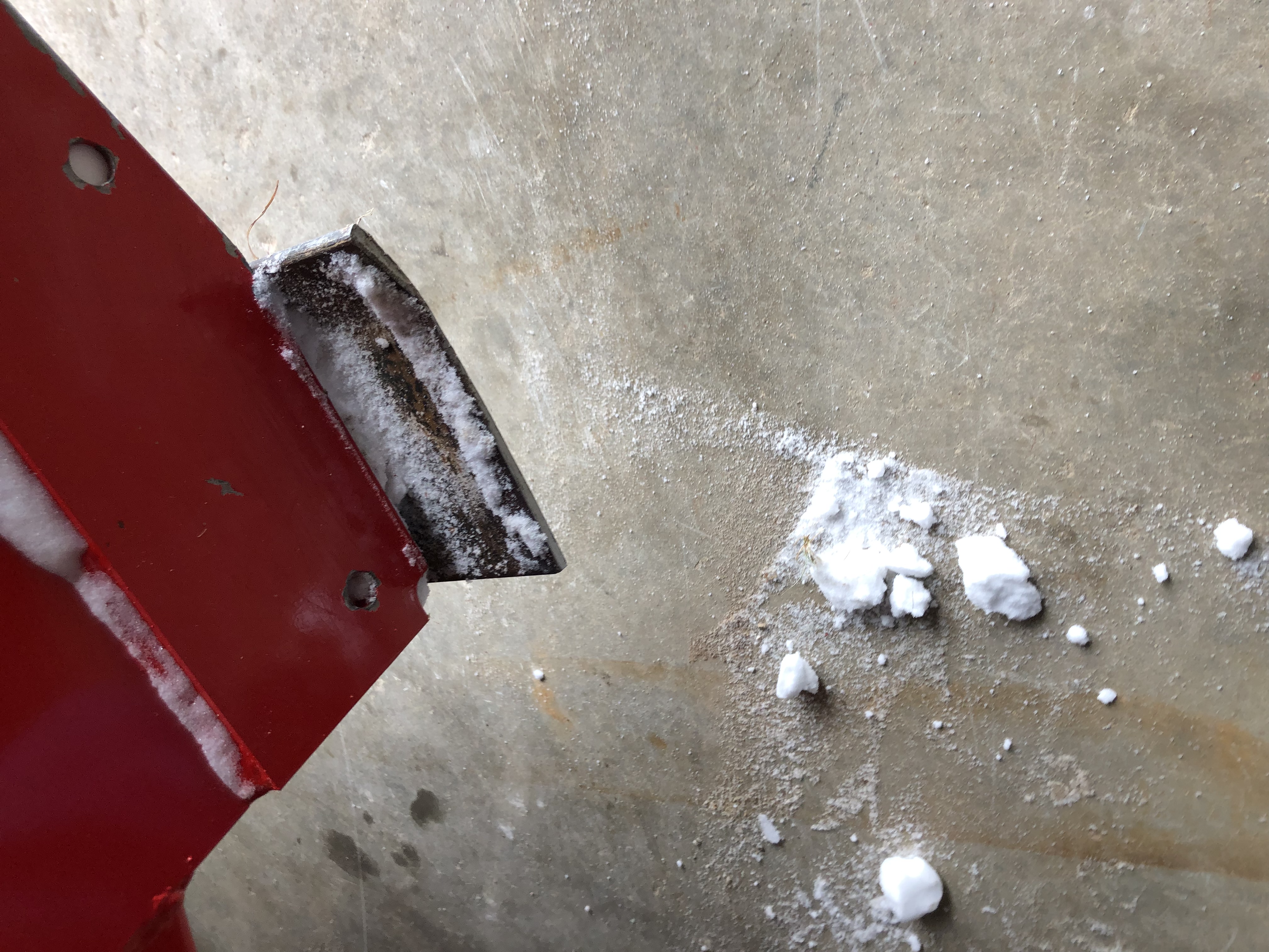

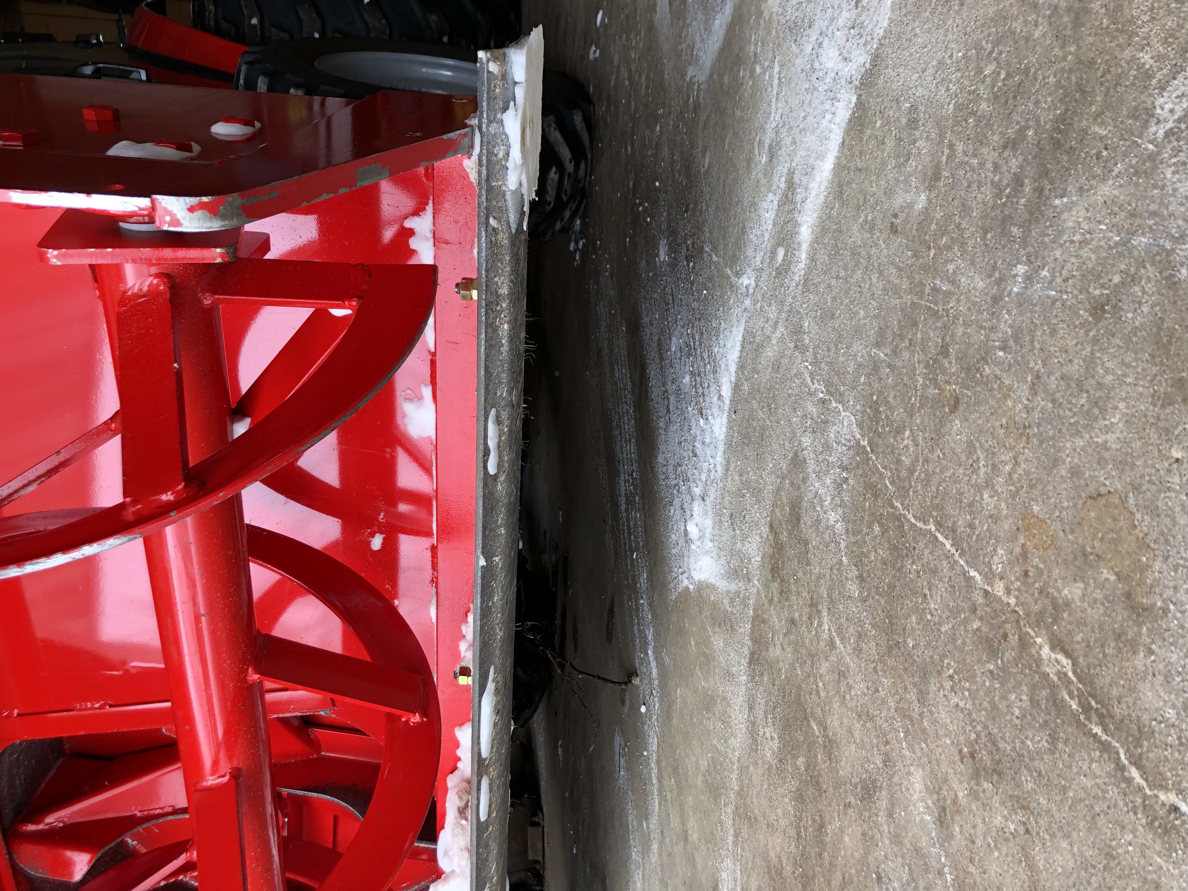

Heres some pics of my solution, and it works perfectly. (6 foot front mounted blower)
I had the local steel supplier take a piece of 5/16 by 6 flat stock which was 74” long.
I had him put a 30* bend 1 1/2” from the front edge. It looks like a ski, 6” front to back, but 74” wide.
This was attached under the regular wear strip under the blower. I used (4) 7/16 plow bolts. I drilled these extra holes so the skid was demountable without having to remove the original wear strip bolts.
I had a hard time countersinking these holes for the plow bolts, but got it done.
The steel and the bend was around $40, and I had several hours in drilling, countersinking and mounting.
I had a tough time countersinking those bolts, but it really works. I can go on rain soaked, unfrozen grass during the first few snowfalls, and it doesnt EVER dig in. It also does not ride up except on the hardest of blown in drifts. In which case, I use down pressure and if I need to adjust course, I just have to stop, lift, correct the course, lower and down pressure, then proceed again. But I only had to use that procedure once in 2 years
I had planned to remove it after I built up a base of frozen snow, but it penetrates well enough that i havnt removed it in 2 years.
