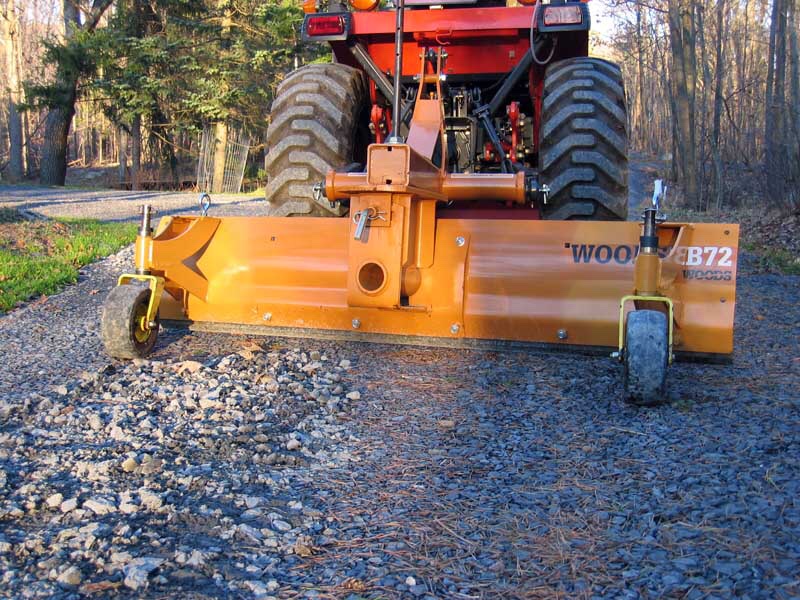

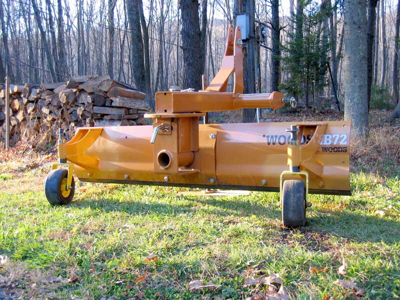

Rear blade with adjustable bush hog gauge wheels. Set the 3pt in float.
   / Snow plowing on soft ground #46
I always thought this setup would be the best for removing snow on soft ground. Pull the pin and let it float side to side as well as float up/down on the 3pt, with the gauge wheels keeping the blade out of the gravel. IMG_1446.JPG IMG_1447.JPG

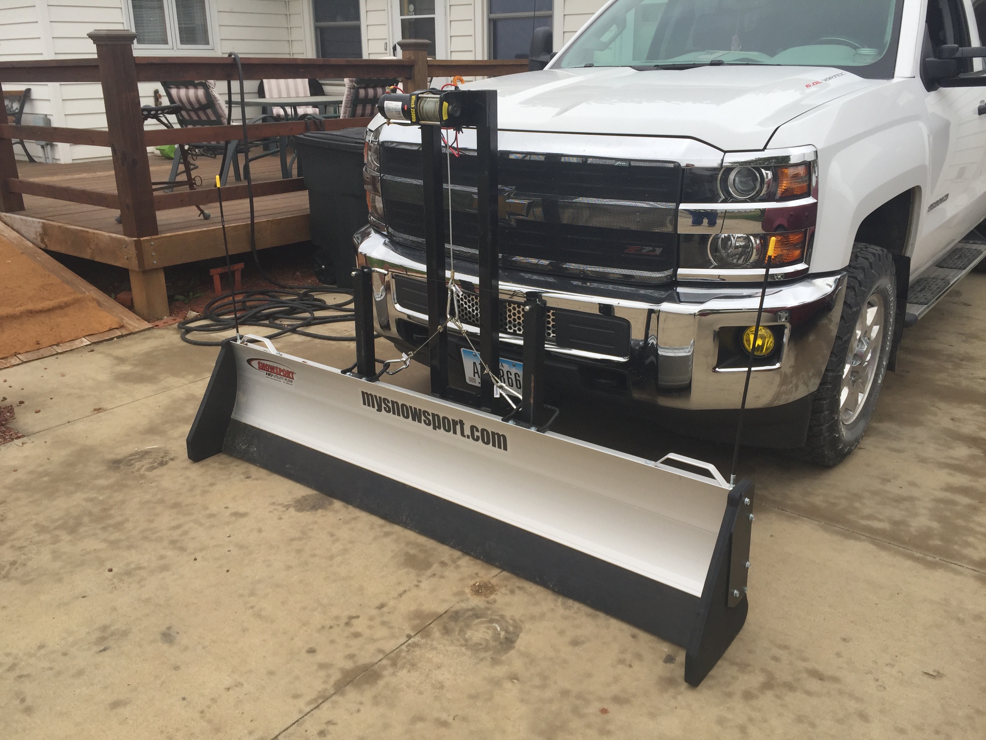

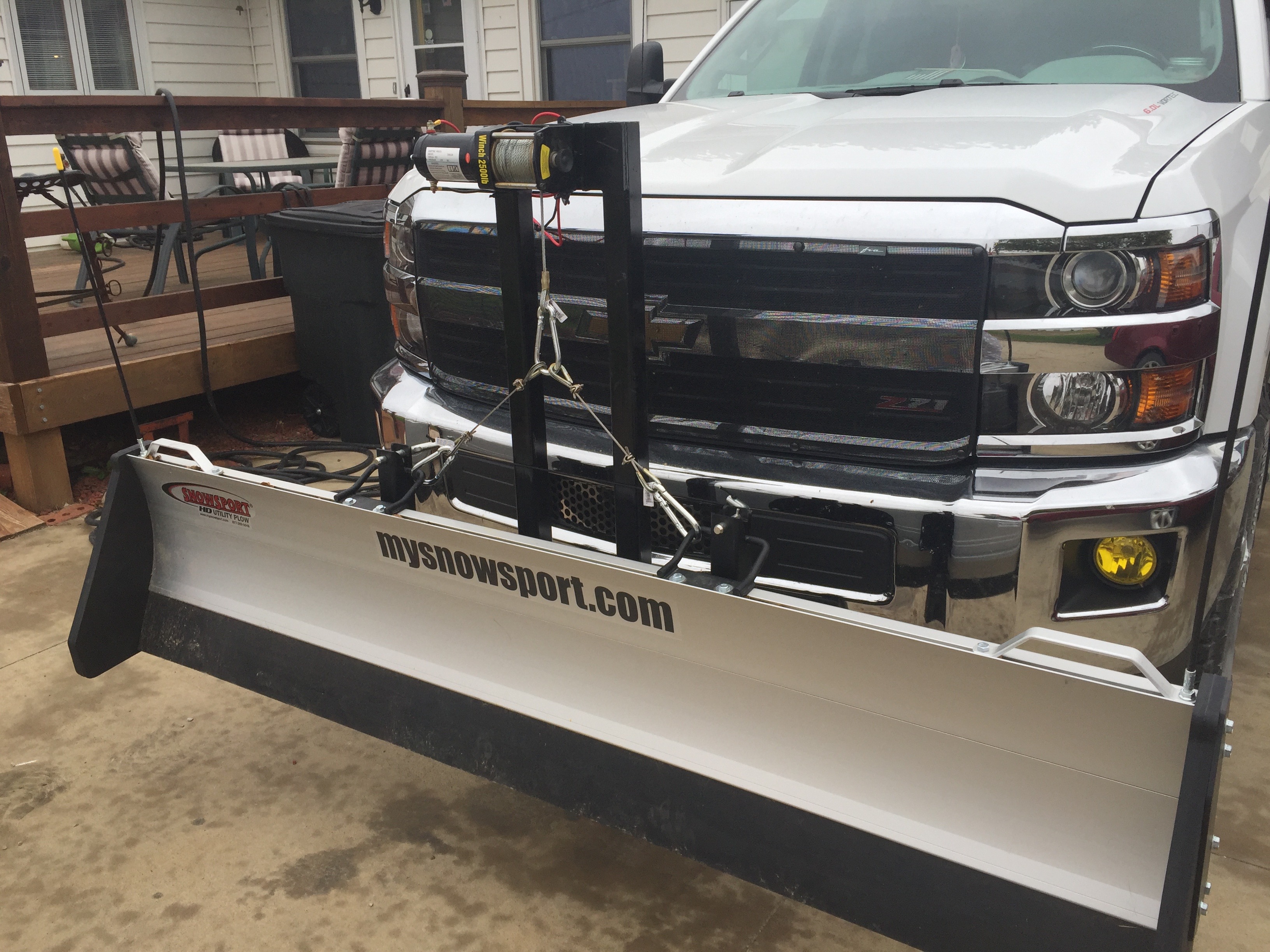

While it is not some sort of commercial grade plow, I have had excellent results with my SnowSport HD snow plow. Very cost effective and has done a great job. Simplicity can sometimes be a good thing. I never worry about taking out the gravel on 900' drive and I can push right on up into the yard around the out buildings and never worry about scalping the grass. To look at it, it may seem "cheesy", but it works very well. I had a local welding shop build me a winch frame for it and use a $60 winch I got off of Amazon to lift and lower the blade. All that is required on my pickup is a Curt 2" front receiver hitch.
SnowSport HD Utility Plow | Truck Plows & Snow Blade
This vid shows it working
SNOWSPORT(R) Utility Plows - YouTube
This vid shows how it contours to the landscape
SNOWSPORT(R) HD Utility Plow Testing - YouTube
Here it is on my 2015 Chevy 2500.....
