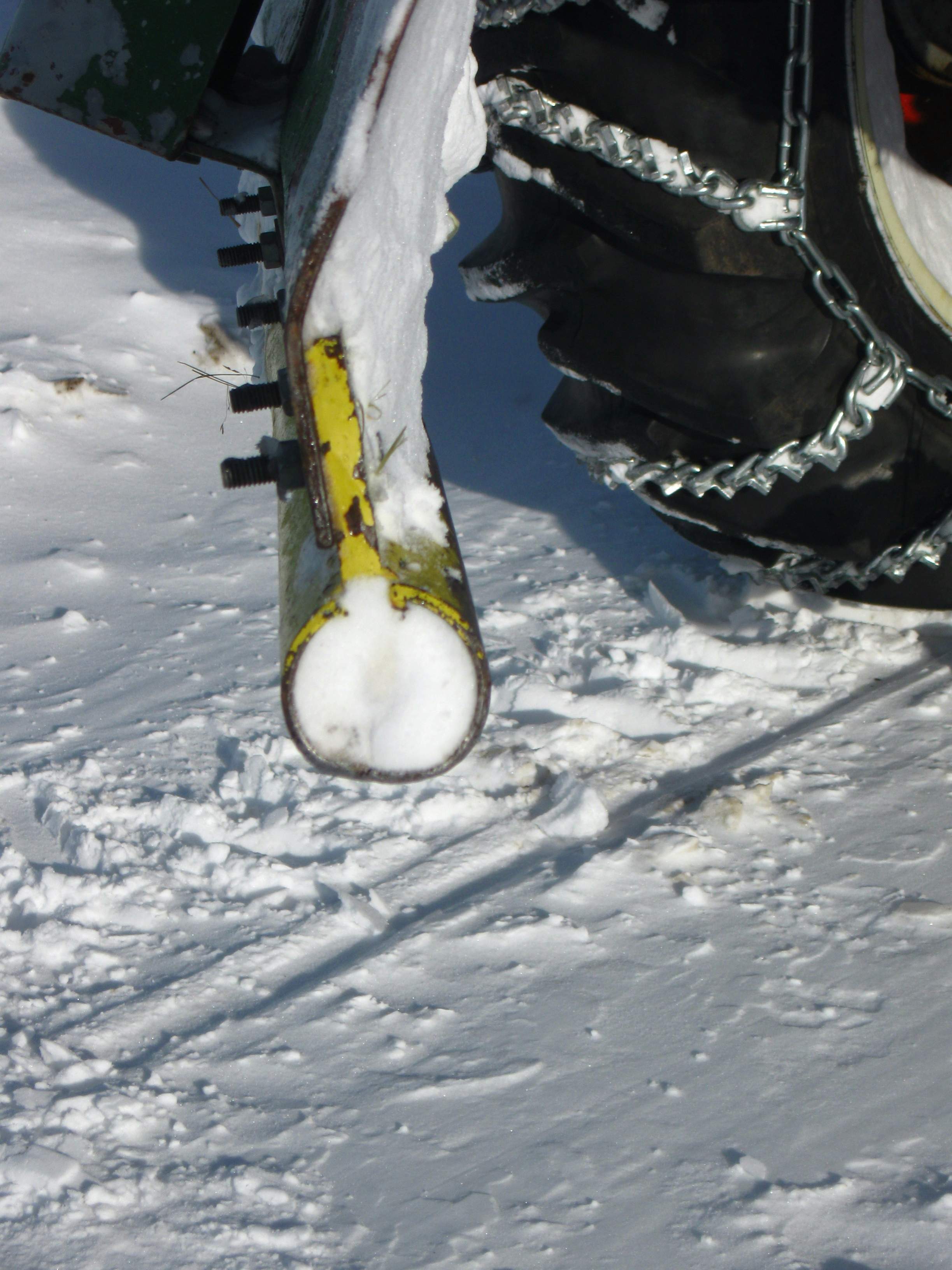

I just bought a new Kubota B2320 and will be using it to plow my limestone driveway. I have been doing alot of research on what to do in order to not scrape all my stone into the yard. In doing so i came up with an idea of my own so i figured i would ask those with more experience before i go to the trouble of building it.
I will be using my 60" woods grader blade. I was thinking of taking a piece of 1" or 1 1/2" steel pipe and welding tabs to it that would attach using the removable cutting edge bolts. That would pretty much act like the pvc pipe that alot of people use without the problem shattering in cold weather that some have talked about.
I can't come up with a reason this wont work but it seems to easy. Any thoughts?
You mean like this? I designed this up in 1989 when I took a welding class and I have used it ever since. Works like a champ!
Slitting the pipe was the easypart. I used a torch on a track to slit it straight. Dealing with the residual stresses in the pipe that made it twist up took some work. The welding was the easy part.

Yeah pretty much. I built it a couple weeks ago ill try and remember to take some pictures tonight.
