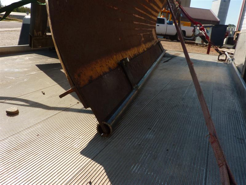

I just took this picture of my slit steel pipe on the blade of a Meyer FEL plow. The pipe was slit with a plasma cutter and was driven on from the end with a hammer.
The welding shop put steel "tabs" on the pipe and set screws which bite above the cutting edge on the blade. This is a bit different than we had talked about doing.....but it should work. I'm hoping this pipe will provide a skid-shoe effect.
The pic is not very good best...but the assembly is getting sand-blasted and painted now. More pics when its done and mounted to my tractor.
I must be missing something.What holds the plate wityh the pipe on to the plow?
Jerry.....I am a little skeptical about how that pipe was attached too. My welding shop concocted this arrangement after we talked about welding a nut on the outside of the slit pipe (for a jamb-nut). (There is a 1/4" x 1 1/2" strap about 18" from each end, with a jamb-nut which rests above the plow edge....if you look real close.)
He claims it is going to hold, and his advice is normally sound.....so I let it be good for now. BUT....I could not lift my plow to wiggle around on the tube to verify his point....so it's gonna have to wait till I mount the plow.
I have the plow at the sandblast and paint shop now......after-which I will mount it on my tractor. If it looks like holding the slit tube in place will be an issue.....I may revert back to my original intent and weld a nut on the outside of the tube. :thumbsup:
