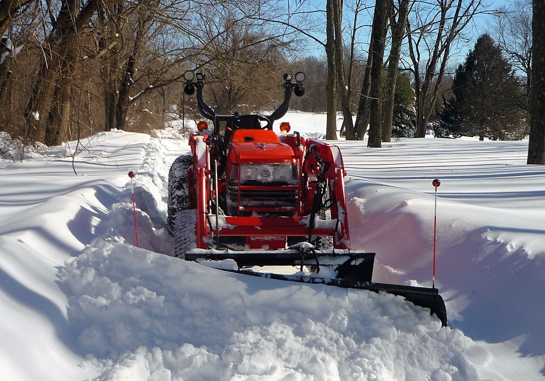

As you can see from my photo, I use a 78" HLA snow plow on my SSQA loader. I plowed a well-established gravel lane, about 1200' total, for years with it. Now, the lane is paved to our house, nobody lives beyond us, and best of all, the rich neighbor's groundskeeper runs his plow up to our house after it snows. Seems like the days of 30" snows are behind us, so I haven't even mounted the plow for 3-4 years, to clear our little drive and around the parking areas. But, the plow, with its shoes, didn't throw enough gravel to worry about. If the snow was really deep, I just plowed twice, first time half way down, then a finish pass. I found spreading the rear wheels 4" total helped with the tractor being pushed, and chains if things got really gnarly. A cab was the only thing I really lacked.

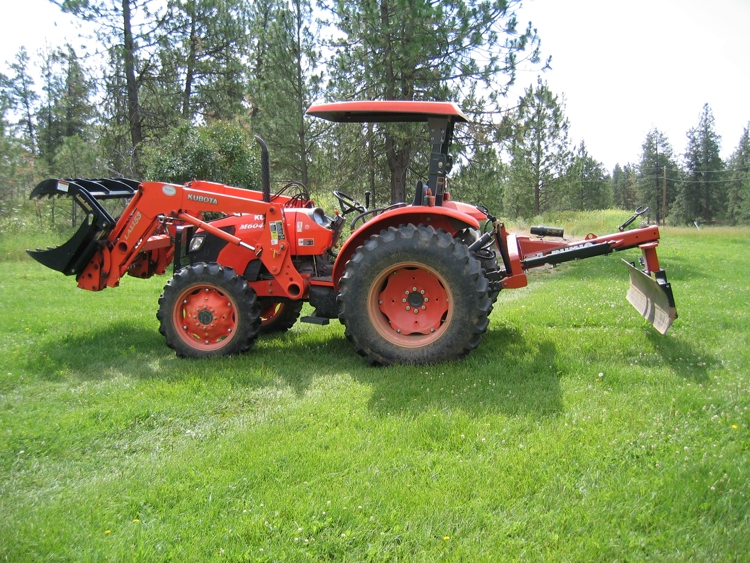

I have lots of years of gravel road plowing experience. Anything front mounted will remove your gravel along with the snow unless you leave a few inches of snow on the road. For heavy snow I hold my loader bucket about 3 inches off the road surface and have a rear blade attached with the moldboard rotated 180 degrees, so I can skim the road in float. The front bucket pushes the heavy snow and the rear blade removes the few inches left on the road. With the blade facing backwards it will ride on the gravel but not move it. You will probably get a lot of people who suggest a snow blower, but that’s an expensive piece of equipment to buy and maintain for just 2-3 times per year of use. For heavy weekly snow, yes a blower is worth it. My 2 cents.
A lot of thoughtful approaches in this thread, but I have to agree with the quoted recommendation from jyoutz for the circumstances the OP describes. Now going on 30 years, I've maintained a mile of private access road of crusher run stone ("21A" here in Northern VA: nominally 3/4" down to fines). Maybe two to three plowable snows each winter, typically 4 to 8", but occasionally 10" to 12". Very rarely, but sometimes much more over a two-day period. In 2010, Snowmageddon dumped about 30". (Seriously?? In Virginia?! 😲)
If accumulation is over 5 or 6" of wet snow, I'll usually lead with the loader bucket two or three inches off the surface as jyoutz describes, to "break track", followed by the angled, 3-pt mounted snow blade. If the gravel isn't frozen, I'll turn the blade 180 so the back of the moldboard and cutting edge move the snow. For the past eight years, I've used a 7' Woods HBL84 scraper blade, 550 lbs (with offset capability). If the gravel is frozen hard, I can mount a pair of Woods OEM skid shoes, then use the blade in forward orientation. Still, though, the skid shoes can sometimes scrape shallow ruts. I also have hydraulic top 'n tilt, and I've swapped out the manual adjustable offset arm on the scraper blade for a hydraulic cylinder.
From the OP's description in his original post, I think this approach might work well for him, without the need for a more specialized setup.

Nice looking machine!

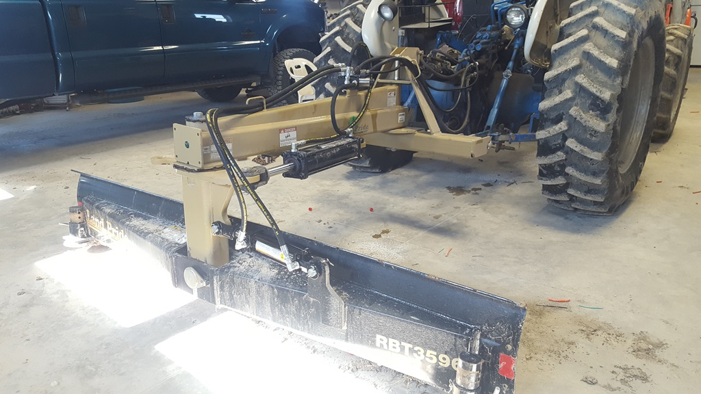

Buy a hydraulic angle rear blade. I paid $2,000 for this one. Has hydraulic angle and hydraulic tilt. I also have a hydraulic top link. Using a diverter valve to run 3 cylinders from 2 rear remotes. Has adjustable shoes to protect your gravel.

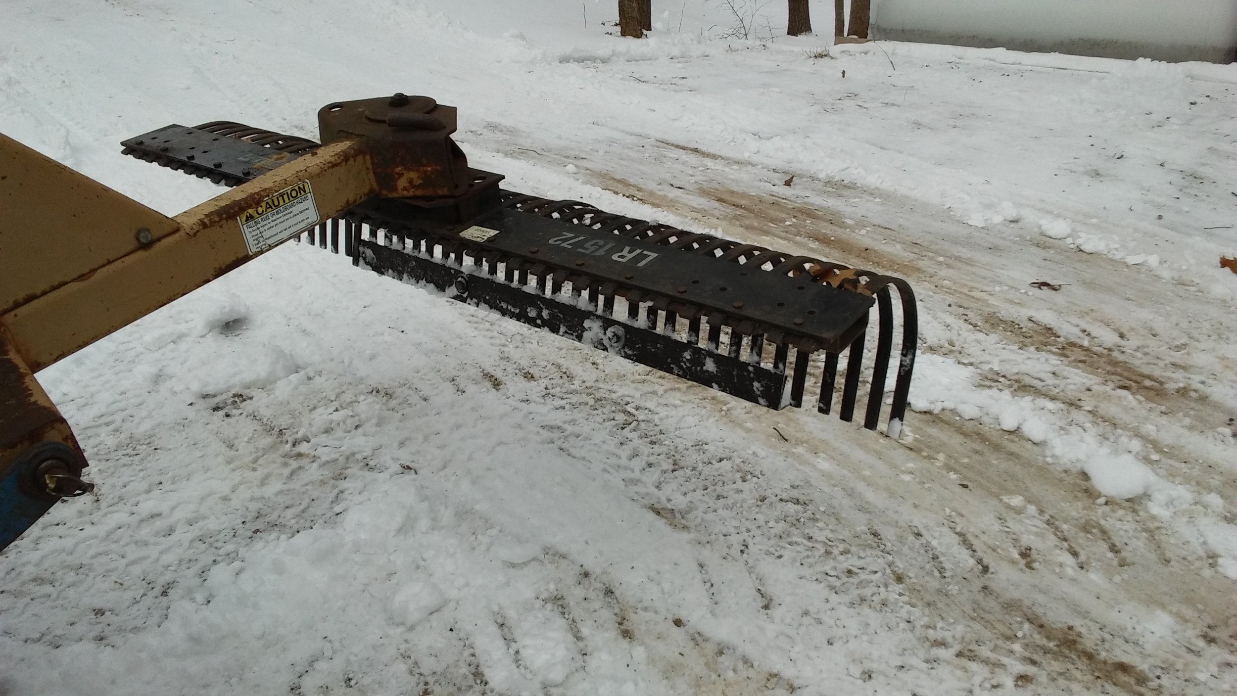

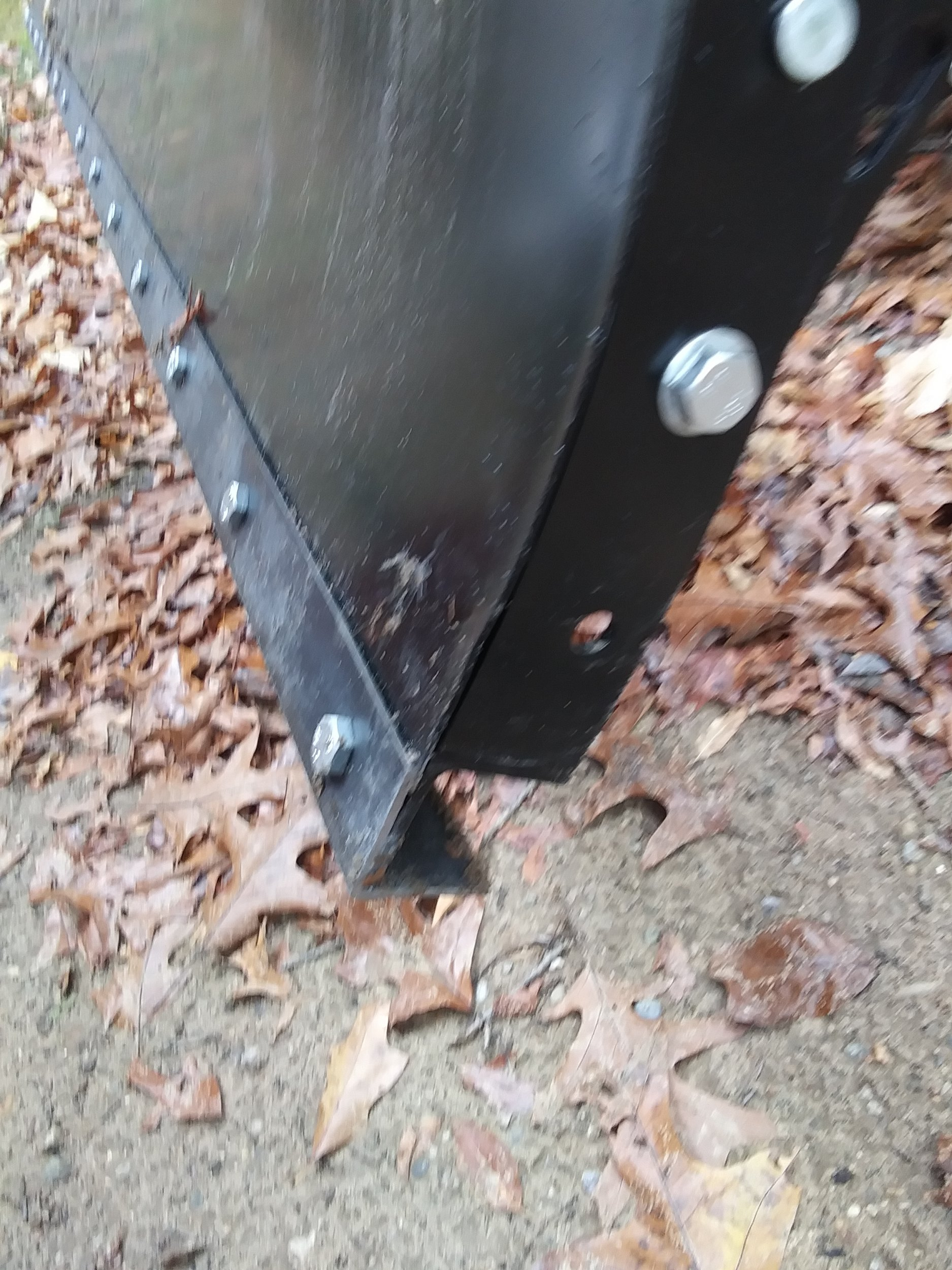

In my mind you don't get enough snow to warrant a blower.
I do around a mile of private road & drive, all gravel.
The most heard complaint about plowing gravel is getting it into the grass.
I tried plow shoes, they just dug into the dirt as the ground isn't usually frozen the first couple and maybe the last couple times I have to plow.
PVC pipe was suggested, tried, it broke in cold weather.
Steel pipe is really hard to cut lengthwise and harder to attach.
Ended up using angle iron bolted to the cutting edge.
(In pic., bolted in place of cutting edge because holes were already there.)
Easy to attach & take off.
I can even plow paths in the yard with NO damage come spring.
2" x 1/8th" seems to be enough.
Works as well on front or back blades.
I even strap one on my york rake & use that to plow surprisingly well.

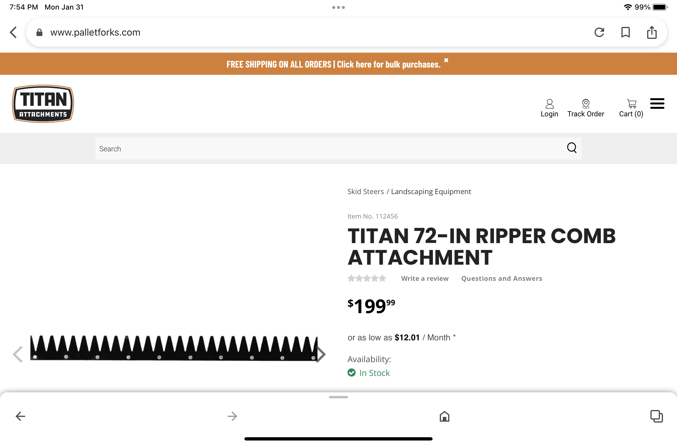

Like the yard rake transformation. Always wondered if that would work. Thinking (see attachment) of trying something like this on my yard rake to help on raising the gravel on driveway.
