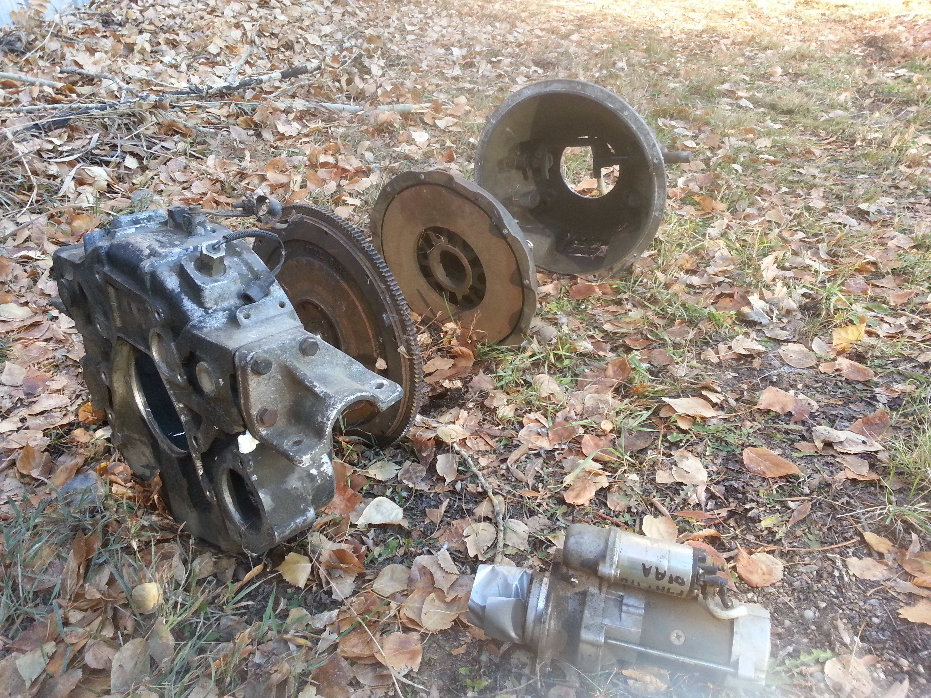

/ Snow PUMP #105
ATTACH]
This is my SAE 2 or 3 bell housing and adaptor for a B series. The back piece is the one that bolts to the engine. It's for bolting an Eaton/Fuller transmission to a B series.

I had a hunch about the 4bt stuff, thank you, it's nice to hear confirmation! I'm looking at two issues with respect to this engine-rear. One is that since it came out of a '94 dodge that same standard tranny/tx-case would be a primary candidate with the auto following. I also hear from the grapevine that the reason that Allisons in GM's are so cheap is that nobody needs replacements, they're that tough. The other is that in any belted solution I'd want a support right by the flywheel on each side in addition to any others that might avail. I've seen some flywheel adapters with such mountpoints but only on the bigger Cummins engines (so far) and have zero experience in automotive mixmatching. I could probably make an adaptor plate with such mountpoints added to it but finding one used is always an easier solution. Mounting on a hosting truck really opens up many new options but I will likely just start by adapting to the present rig for one season, to get some hands-on time with the engine before taking the ball another yard. The existing rig includes many constraints. All this may change at any time if I happen upon the right truck at the right price.
/ Snow PUMP
#107
ATTACH]
Really neat the way you stood the pieces up with sticks, it speaks of an ability to communicate clearly :) Is that flywheel housing the 'adaptor' you talked about? I like what looks like mounting provision although being in aluminum I'd have some questions about the brute strength.
/ Snow PUMP #108
Ok so I finally got around to posting the same setup from the other side which is what i wanted to do in the first place. Now the front piece is what bolts to the engine. Don't worry about it being aluminum it'll be strong enough for what you want to do with it. This bellhousing is from a medium duty single axle truck. I picked it up on eBay for a project that i haven't got around to yet. This afternoon if i remember I'll take a picture of an automatic transmission setup that i have laying around. It's a bit different than this. I'll post it so that you can get an idea of what a factory manual or automatic belhousing looks like.

Thanks very much for your help. I spent an hour last might looking at the transmissions used on dodge trucks and spotted an nv3500 with some really interesting ratios. This was developed in response (supposedly with a lower number following?) to complaints that the nv4500 was geared too high. By low and high meaning hight ratios and low ratios respectively. So as I read further it said that the nv4500-HD was made specifically to accommodate the 6bt torque around 400 ft-lbs, a little detail which I think also means that no automatic nor other manual could handle the torque. This was back in the day, I presume that today the situation is different but it's food for thought, don't look too good for automatics.

An nv4500 is borderline for a Cummins. They are rated for 400 ft/lbs and stock torque was 420 ft/lbs. I wouldn't get too excited about a nv3500 at all. They were never available behind a cummins. I do think that a snowblower would be easier on a trans over going down the road but I'm not an engineer so I don't know for sure.
Actually if your aiming for 1000 blower rpm and 2000 engine rpm then a 2-1 reduction once would do the job.
Edit to add that since you really don't need overdrive then a good stout highway truck trany would do the job too.
