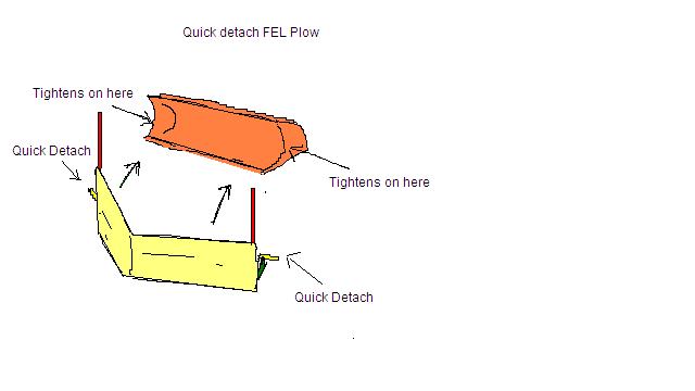

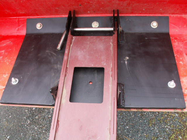

Scootr2d.
"someone would manufacture V shaped insert that inserts into and cover up the front of FEL opening and uses a QW Attach"
Sub frame attach to bucket,one pin to install/remove plow.
V-shape plow,equipment auctions etc...most plow v-plow comes w/frames.
Hi Thomas , please expand , are you saying a company already does do this So you can just insert or attach and not have to remove FEL?
if so do you have their name ?

scootr2d.
"please expand , are you saying a company already does do this So you can just insert or attach and not have to remove FEL?"
I've seen snow pusher for larger hp tractor for sale,but nothing yet 50hp or less.
High % snow plows attach to buckets gentlemens have made there own or had made.
TBN member Haystack just finish making outstanding snow pusher..custom build,plow/blade section worth checking out.

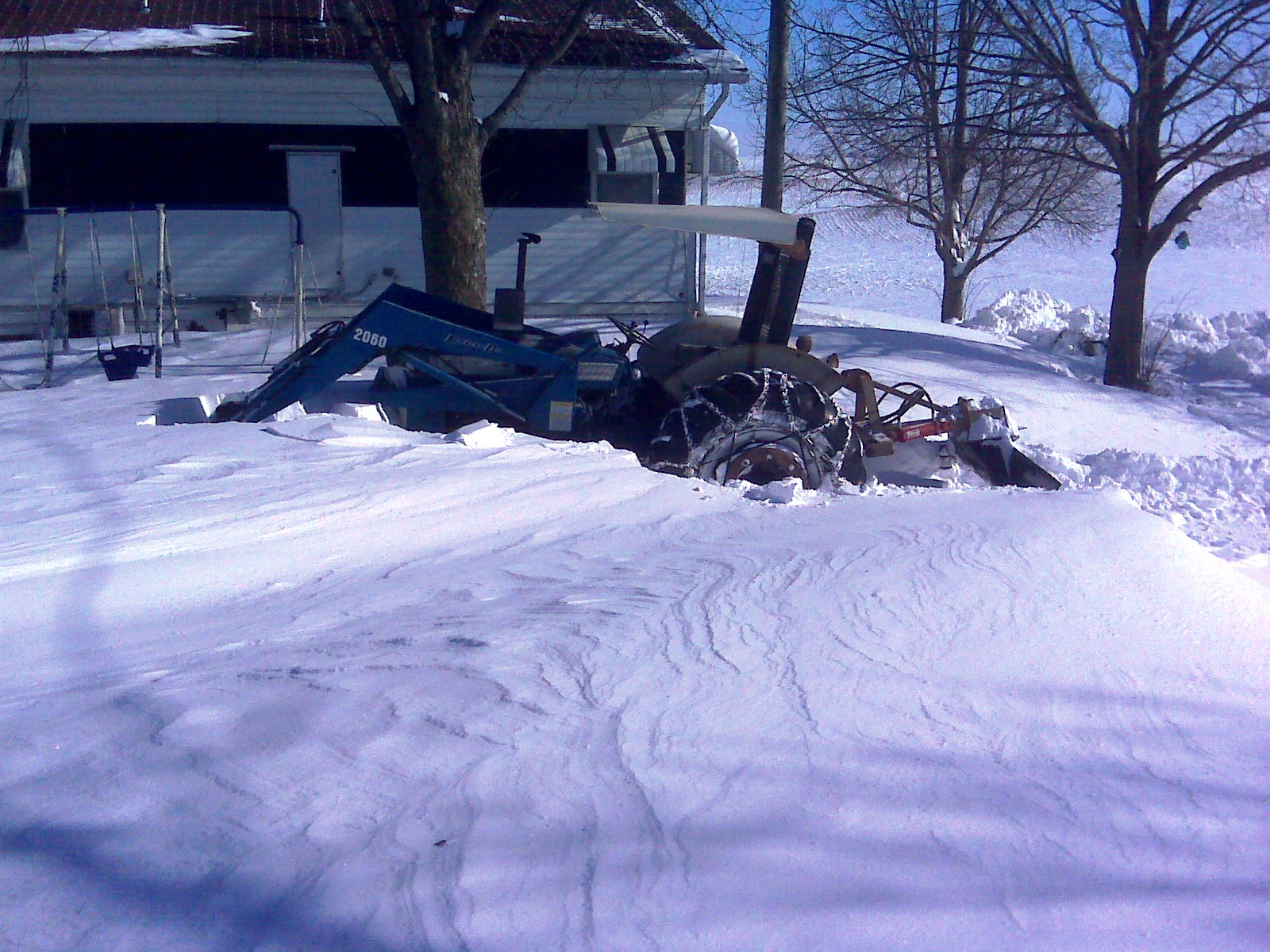

Have moved alot of snow with a FEL and and a rear blade. Not the best, but beats a scoop. Front snow blades do have some down sides. You have to be able to push it somewhere, and if you're using an angled blade and the snow is deep or hard, it can/will slide the front end sideways. With a loader, at least I can scoop through the deepest stuff, or drag it out with a rear blade if you can lift it high enough to get over the bank. I had to move most of this drift 1 bucket at a time, couldn't push through to make a path to start with.
Because of the big drifts I get, Have picked up a 6' blower for this winter. If all goes well, won't have to use it much.
