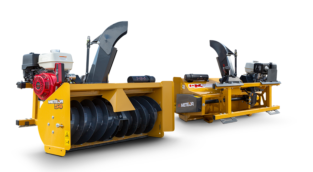

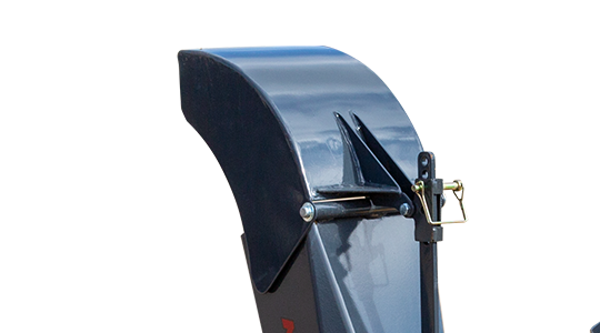

We started with a combination of free/available equipment and since I've purchased the tractor. I don't want to duplicate my tools, but what would your first choice be if I had to could add one more tool to the mix to handle the banks and larger storms. If there is a better way to use what I have that works too.

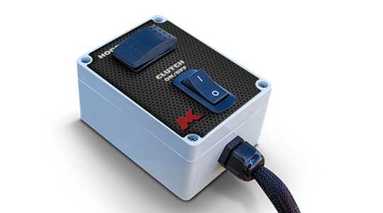

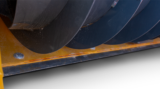

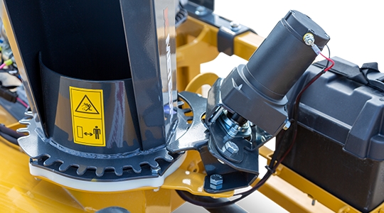

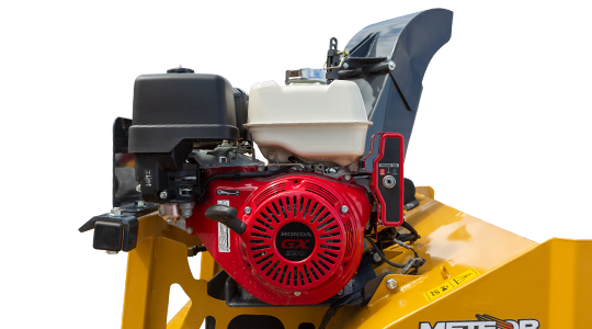

The only thing I would recommend is a motorized snow thrower for your
RTV900 since you already have a winch on the RTV specifically because
of your need for simplicity in operation and snow clearing ability as it could
be mounted on the front loader with a longer control cable and use it equally
well on the RTV900.
There are number of 2 stage snow blower brands and models for sale, but
in saying that they have many, many, more parts for their drive systems and
require more horsepower to use and will weigh more.
The mk martin folks offer 2 single stage snow thrower models that attach to an SSQR
plate. You would need an adapter hitch to use it on your RTV 900, I am sure they are
available for sale though.

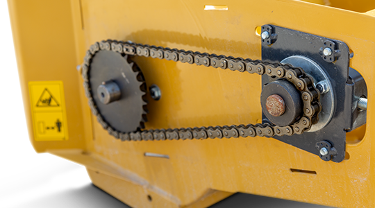

A single stage snow blower is not a complicated piece of equipment to use or own as it has
a simple final drive system using a roller chain drive and 2 sprockets.
The snow blower rotor spins at a very high rate of speed and discharges the snow through
the chute at a very high speed to get rid of it.
The 2 models of single stage snow blowers offered for sale by mk martin employ a honda
GX390 engine to provide the torque needed to create the centrifugal force needed to spin
the dual drive belts that are connected to the drive sprocket that spins the roller chain that
spins the larger driven sprocket that is attached to the snow thrower rotor.
The snow blower rotor and the driven sprocket are supported by two open bearings flange
bearings that are bolted to the side weldments of the snow thrower.
The only things I would change with either of these snow throwers offered by mk martin are
1. change the fuel jet for a much larger one
2. replace the muffler with a catalytic converter
3. purchase a set of armor skids to mount on the skid bars
The engine exhaust will be blowing around in front of you and that is why I suggest that you
invest in a catalytic converter for the GX390 engine.
I had a GX390 on my Timberwolf TW5-FC commercial wood splitter and the fumes made
me very sick even after warming up the engine and 25 gallons of hydraulic oil with my
space heater for over an hour.
The Foley Engines catalytic converter I had on the honda 390 engine I had converted the
exhaust to carbon dioxide and water vapor and had almost no odor to speak of.
The prices I had for these 2 models of single stage snow blower are almost three years old
so you would have to call an mk martin dealer for the current 2021-22 prices for these units.
The S1054E model weighs 470 pounds and has a 48 inch cutting width.
The S1060E weighs 545 pounds and has a 53 inch cutting width.
Both models use a 16 inch snow blower rotor with 4 center paddles welded to the snow blower
rotor to lift and throw the broken up snowpack through the chute at 750 RPM.
Edit today: 21, January 2022
I neglected to add that the two models of Single Stage Snow Throwers use a 12 volt electric clutch for the V belt drive.
Disclaimer: I am not affiliated with mk martin or have any financial or ownership interest
in mk martin.

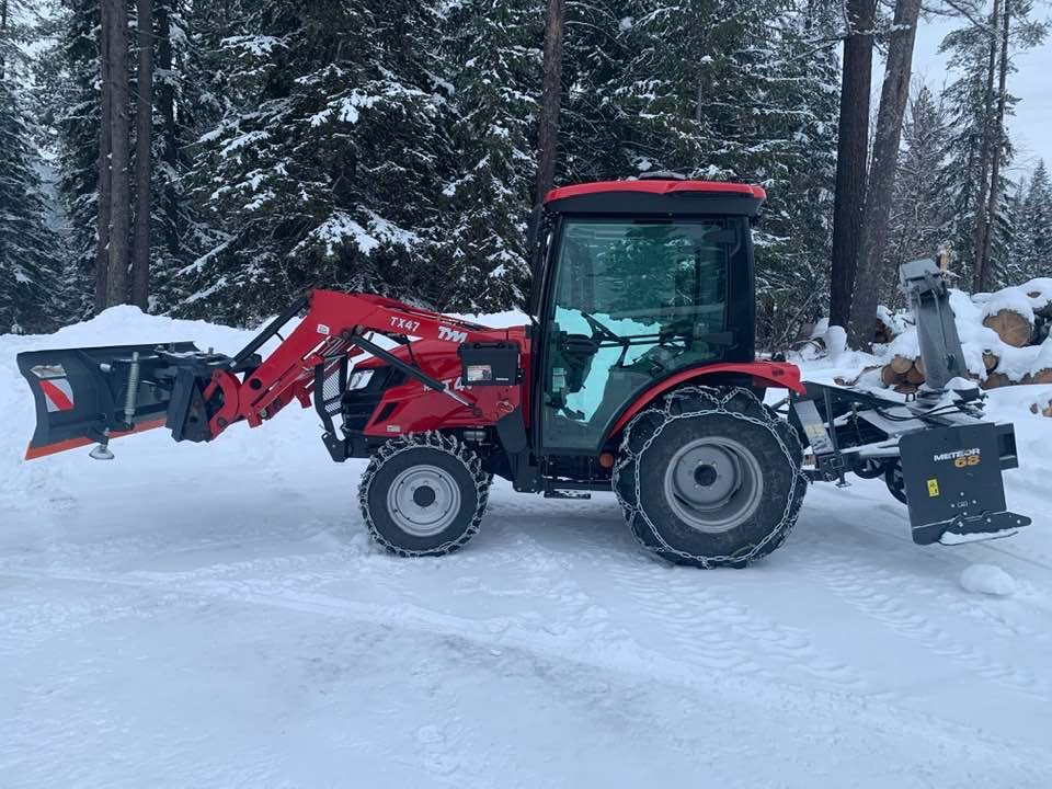

I have 400+ feet for a driveway plus a good size parking area. I have tried an atv with 5' blade, tractor with bucket and back blade, tractor, bucket and rear blower and now front blade with rear blower followed by atv with 5' blade to polish things off. I really like the tractor with front blade and rear blower.
That combo feels like it would be about perfect, I wish it was a bit cheaper of an option
