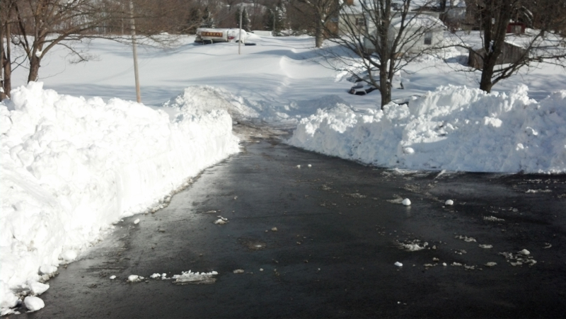

If you are concerned about tearing up paved or concrete try the rubber chains. I picked them up this year and had no problem unless ice under the snow on my hill but nothing will help on ice.

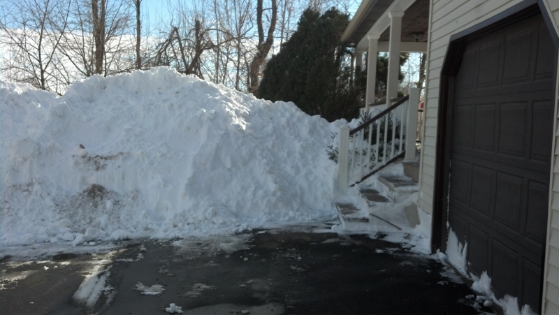

I called them if you are not happy with the chain after 1 use the will refund 75% when I got them. Just spent a fortune on new drive way didn't want to rip it up.
After 28 inches of snow with 40+inch drifts this is what my driveway hill looked like. Also had no problem piling it up.
When I ran out of snow I did the street just for fun!
