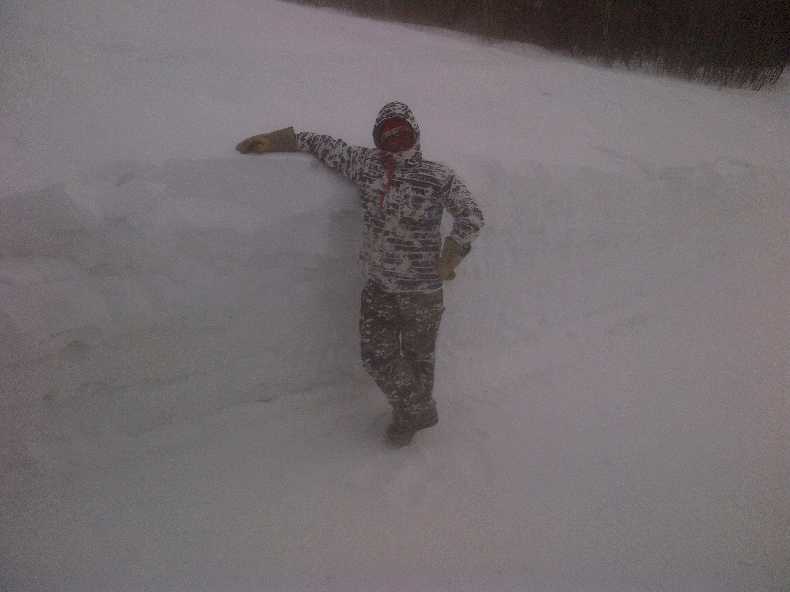

Snow blew in, and the FEL wouldnt make a dent. 7' two stage snow blower was grunting behind the 70 horse 4WD White, but it got through.
Fluid filled tires, no chains, about 12,000 lbs for tractor, plus blower.
Here is a pic of my 6 foot son standing beside the end results.

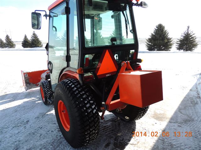

This counter weight has served me well.
