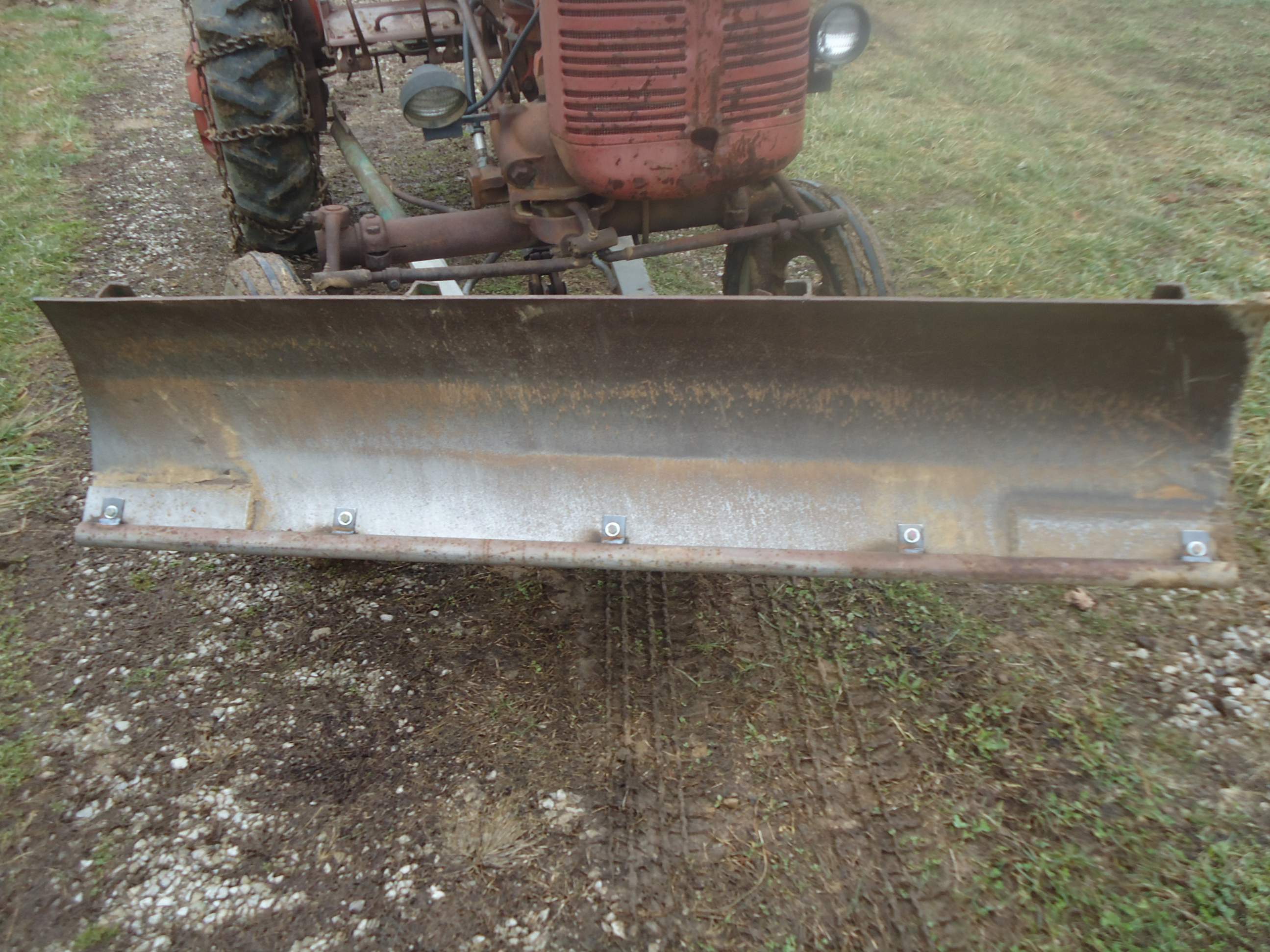

Although it is a front mounted blade, you could make the same thing for the 3pt. one.
I slit a piece of 1-1/4" steel pipe to slip over the bottom of the blade and welded tabs on to bolt it on.
So far, it has worked great, because we haven't had enough snow to warrant using it. If I had known it would work that good, I'd have done it years ago....!!
See my post in page one of this thread!

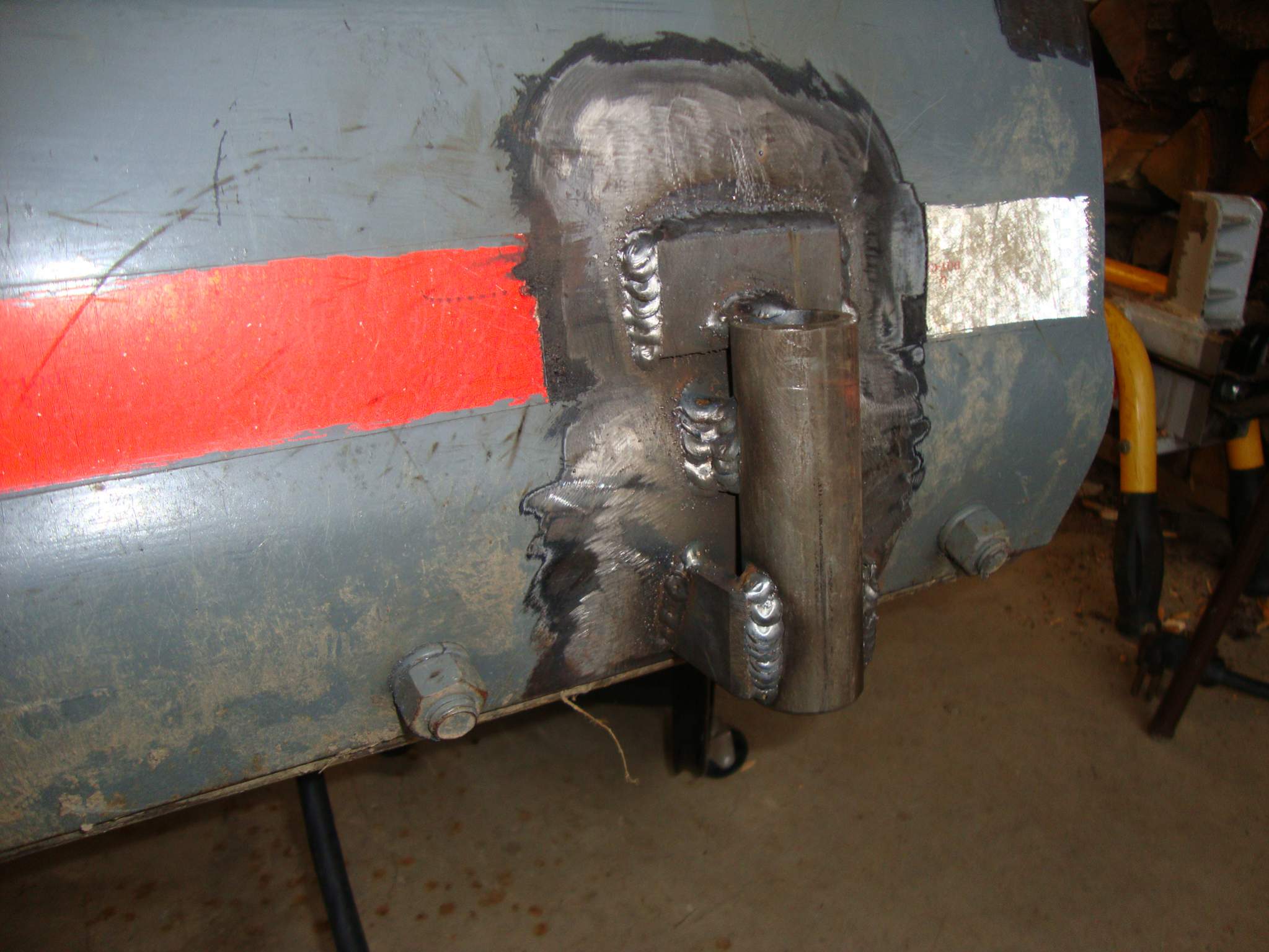

Here are a few more pics of the mounts I built if you're inclined to go that way.
Sean
