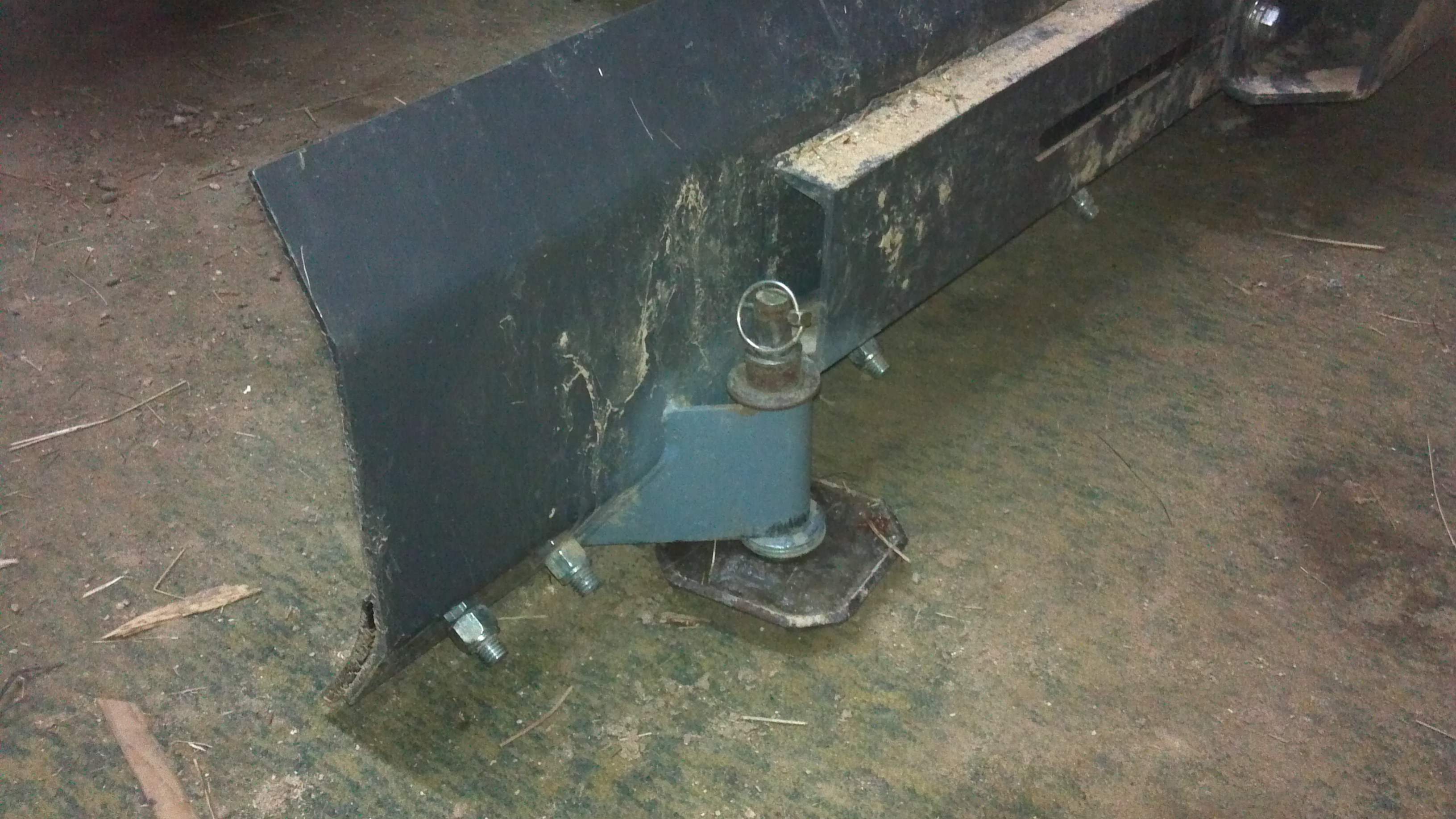

I had a local shop weld on some brackets so I could attach plow shoes.
I did this because the blade was just taking a beating when getting caught on the protruding rocks that were frozen into the ground. This helped a lot, now of course as it thaws the blade is so heavy that it pushes the shoes into the ground. Although the shoes were homemade and don't have enough surface area. See attached pic.

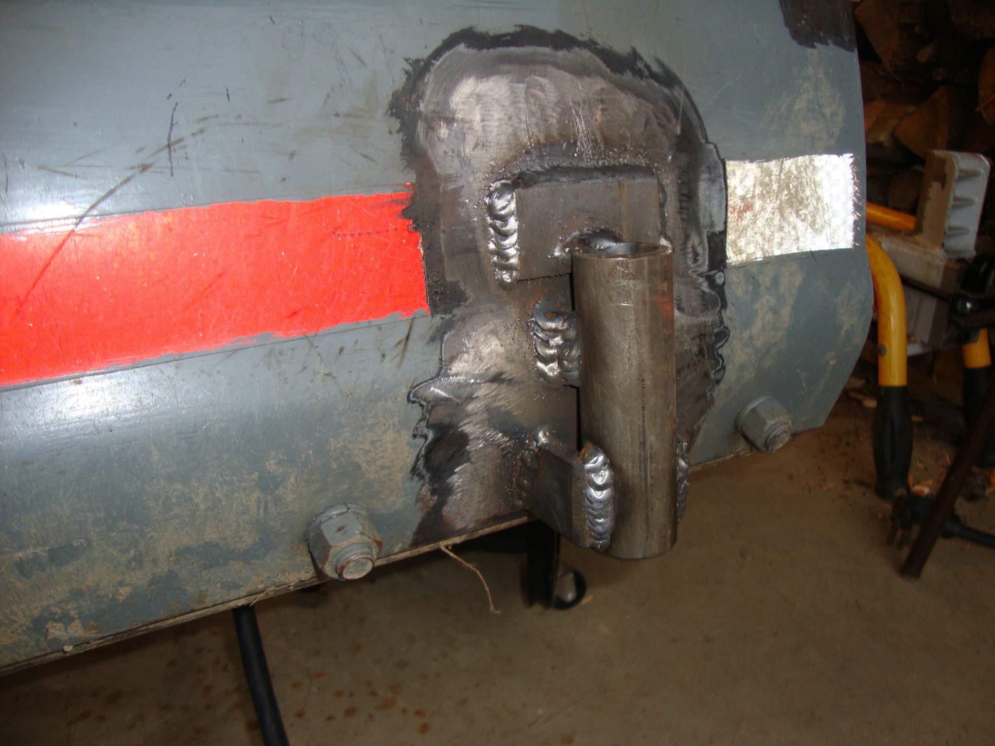

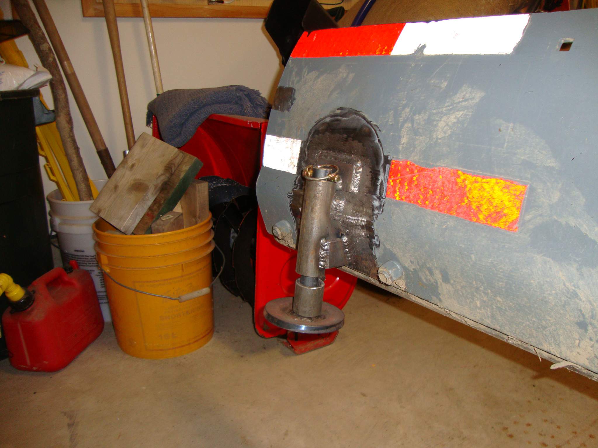

I did pretty much exactly what Tvanharp did with his blade. I made the skids about 4.5 inches in diameter and dished them with a hydraulic press.
Adjustment with washers, and they work quite well. Mine come off in the summer, the pipes they run up and down in are above the grader blade cutting edge so they don't interfere with dirt work. Not the best photo, I'll try to get a close-up if you're interested.

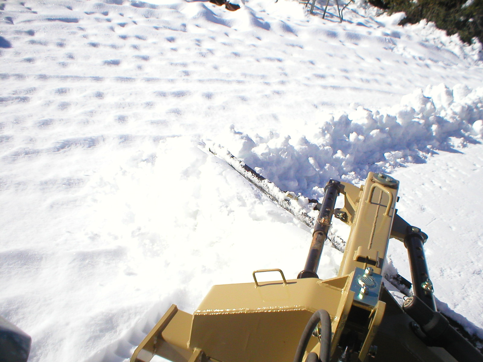

If you get everything just right, rear blades work great for clearing snow. Although a person would probably be in trouble if the snow was to deep.
MVR, does your rear blade swing left to right..?? or is it an optical illusion

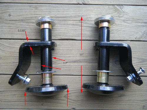

Here is a picture of my skid shoe that I am getting ready to install. They were ordered for my Frontier RB1072, AKA Woods RB72.
They are quite beefy weighing in at 36lbs each.
Not sure that I understand your question? :confused3: All rear blades swing left and right. My boom will offset up to 35" to the left and right which I guess is what you are asking, but in the picture the boom is straight back and the picture is an optical illusion. A lot of my grading or plowing pictures are just me holding the camera and snapping an action shot. So the camera is not always in the best position when the picture is taken. :eek: ;)
