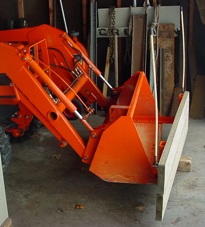

I fixed up this snow "Pusher" for my FEL. It's permantly angled, five feet wide, with two treated 2X8's tall. When the bottom board gets worn I first reverse it or just replace it for three bucks. The wood is much kinder to asphalt and concrete. If I need the FEL, four bolts and it's there. I still have the six foot Woods BB on the back too.
