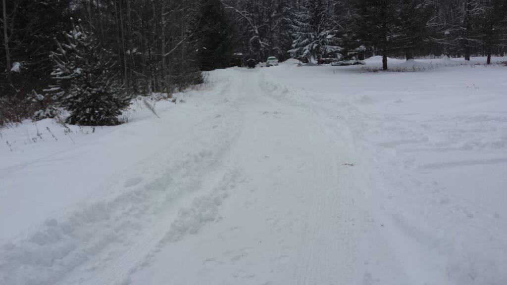

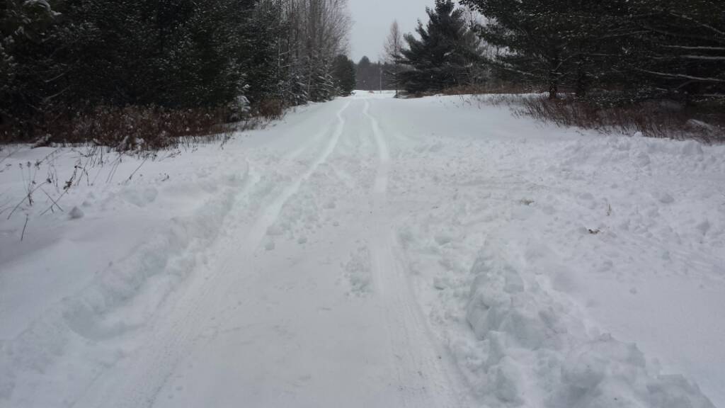

The snow looks pretty wet in those pictures... Wet snow will get you stuck more easily, but there are several things you can do to help yourself.
Use reasonable tire pressure. I set the fronts at door sticker pressure most of the time. If the truck only plows your drive, or does only infrequent short trips, drop them to 45psi. The rears should be run at not more than 45psi for an empty bed. From there, add 5psi for every 500lbs of cargo you carry. If you're running 70psi in all four tires, they're not able to deform any, and traction suffers greatly. If you never leave your drive, you can easily run the rears at 35psi, and you'll have much improved traction. If you refuse to heed this advice, don't bother reading further, because you're already setting yourself up to fail, and it won't make much difference...
DON'T SPIN!! If the snow is wet, and you spin, it's ice. That fast. If you have really aggressive tires, and there's non-frozen dirt under the snow, spinning might help get down to the dirt, but on previously plowed driveways with some packed snow and ice, spinning just gets you stuck in a hurry.
Use momentum. Don't drive into deep snow, stop, drop the plow, and then try to go. Drop the plow while you're moving. And if you're making a run for the road, don't stop right in the snow the county plow leaves... That crap is really stiff. Blast through. I used to make these runs in reverse, so I was set to drop the plow and head back into the driveway immediately, since I lived on a busy road. That seemed to help a lot and left less snow in the road than driving out forward.
If you find the back of the truck sliding around, put some weight at the tailgate. Start with 500lbs. It makes a HUGE difference. I cut a board to fit the slot in the bed just behind the wheel wells, then toss sandbags or whatever behind the board. That keeps them in place pretty well. Oh I see you have weight... Plenty... :)
Finally, if you're still having issues, get a set of chains for the front. You'll probably have to stick with cable chains on a Silverado, since there isn't much clearance even with 245's, but they'll make a huge difference if the going gets wet or deep.

Thanks a lot Chris I have about 80psi in all tires I'll drop all to 45 and see how it goes.

Good news I plowed all 1/4 Niles of my driveway!. Was back dragging one part but I felt the truck sliding so I plowed straight into the street to the drop off then plowed the rest into the drive that take you into my field. I will be getting snow tires be for more plowing.
