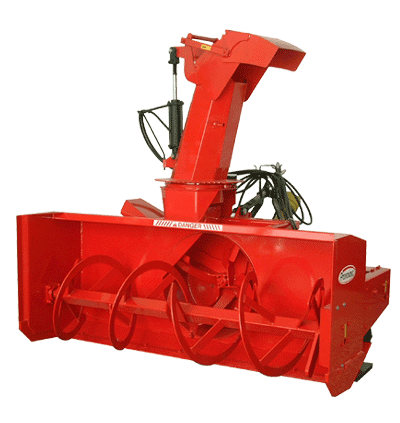

In all honesty- you should strongly think about a rotary ( snow blower) for your tractor or truck--
Why push it- when you can throw it!!
If you are talking about steep roads-- again why push it??? When you are pushing snow in a big snow event you can easily run out of snow storage along the road- -
-- Why do you think most DOT's have plows that will - throw-- the snow away from the road--.
I live in snow country as well- Wind River Mountains Wyoming-- I own a plow for my ATV and walk behind thrower- I always will -throw it- before I push it-
I wish I had a rotary for my JD :) My MTD thrower is great-- but again- why walk- when you can ride :)
