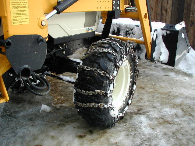

Boondox - I run truck style chains over R4s. I've not had a problem with them icing up. They just plain work good! I don't have hardly a flat spot on my property/w3tcompact/icons/frown.gif. I got the chains free from the fellows in our local town garage. They were ready to throw them away as they were too worn out to continue using them on their plow trucks. With a little work using a pair of chain pliers to make them fit my tires, they work real well for me, and I have a nearly endless supply of new 'old' chains! Tomorrow I'll take a picture of one of my front tires and post the picture so you can see what they look like.

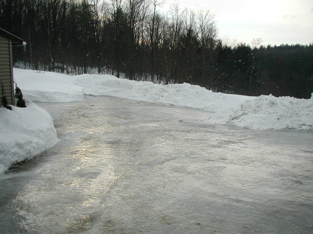

The attachment ought to show what I use for tire chains (if I did this right)!). They aren't anything fancy... Notice in the picture what the ground looks like. It started raining here last night and hasn't completely stopped yet. Any piece of ground that has been plowed, is now covered with ice.

Well, I attached the wrong picture..... now you have a good idea of what the top of my driveway looks like! I'm not going anywhere today.... Now I'll attach a picture of my tire chains... Sorry for the confusion folks...

Corm -- They certainly look free of ice! I also have two link spacing on my front chains, but mine clog up and turn into slick little ice cubes. I have the V-chain on the cross links, but run them on turfs. I wonder if your R4s provide enough "air" under the links to clear them...or if the weight of the tractor has something to do with it.
Our driveways look a lot alike -- slick!

Yep same over Corm.
My driveway just like a mirror /w3tcompact/icons/frown.gifand I don't think chains are going to help all that much.
Maybe if it snow and than turn cold it it would help w/this ice far as traction.
Be extra careful when using your FEL on this ice. /w3tcompact/icons/crazy.gif
