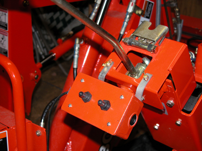

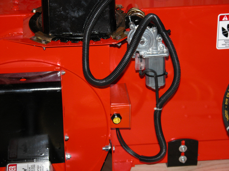

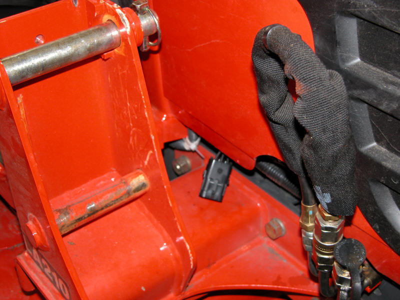

I added the electrics to my snowblower. I put the controls in a box. Wired the motors to a plastic J-Box and used a waterproof connector to connect the two. This makes it easy to remove the blower in off season. I tapped power from the fuse block and terminated at an automotive type connector as can be seen.
Took a day to do, but has been a good setup.
