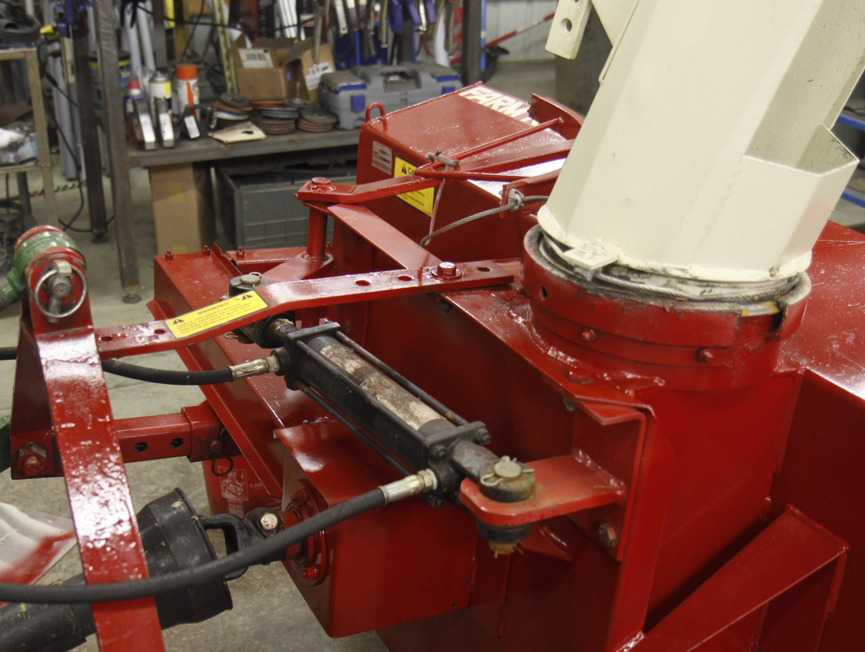

I found the post of my hydraulic chute rotator. I built it 15 years ago and I have never had any trouble in the slightest. As with any design prototype 2,3,4 would be tank grade and bullet proof. I think a 2" x 8" stroke on 8" chute gives me 240 degrees of rotation in around 1.5 seconds. Based on the small number of comments last year I thought I was off on a wrong tangent.

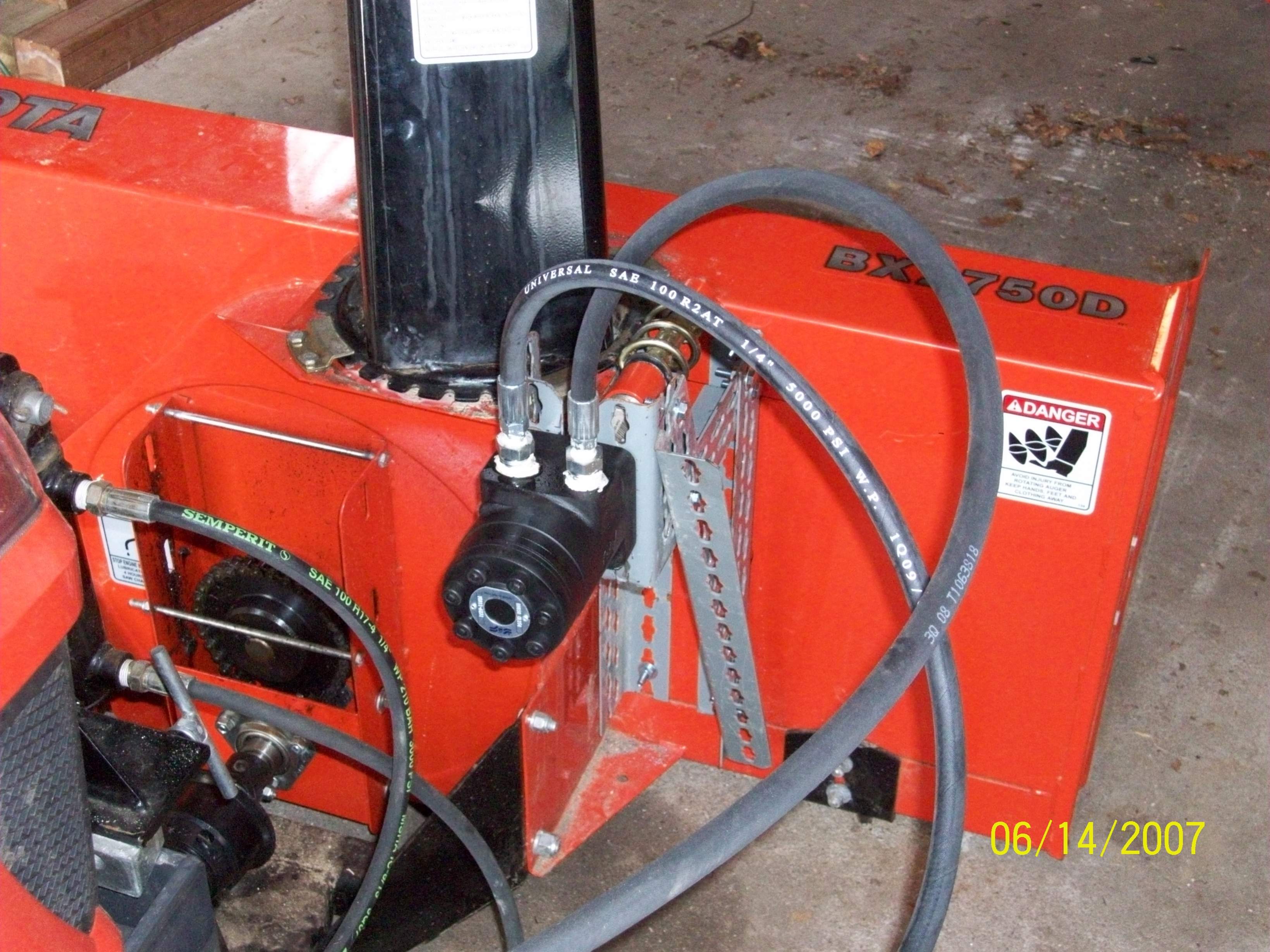

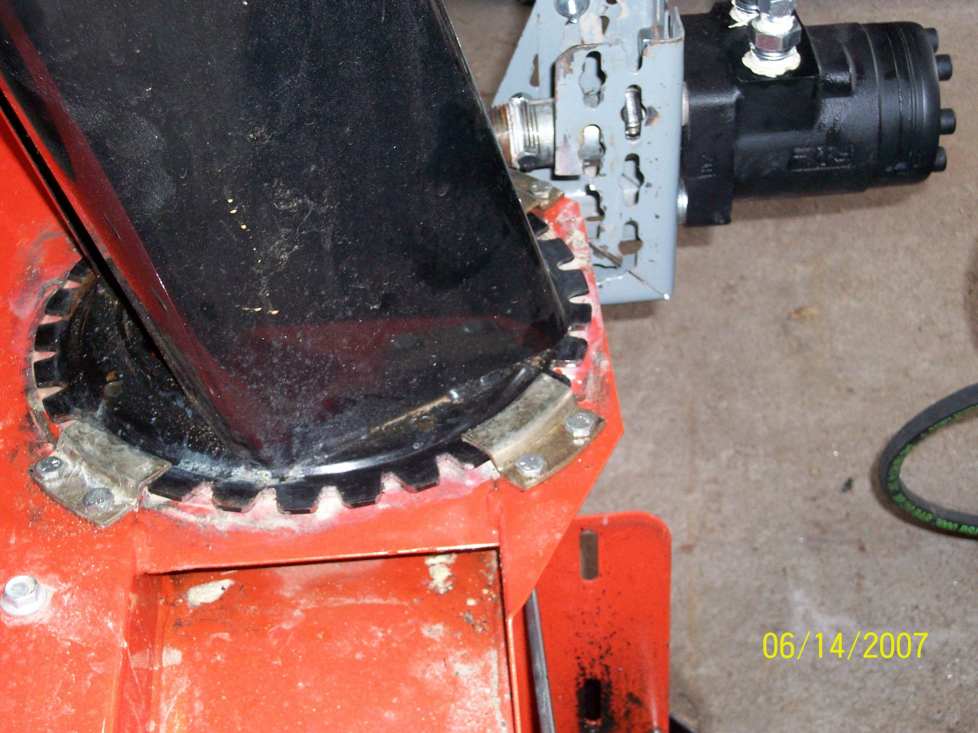

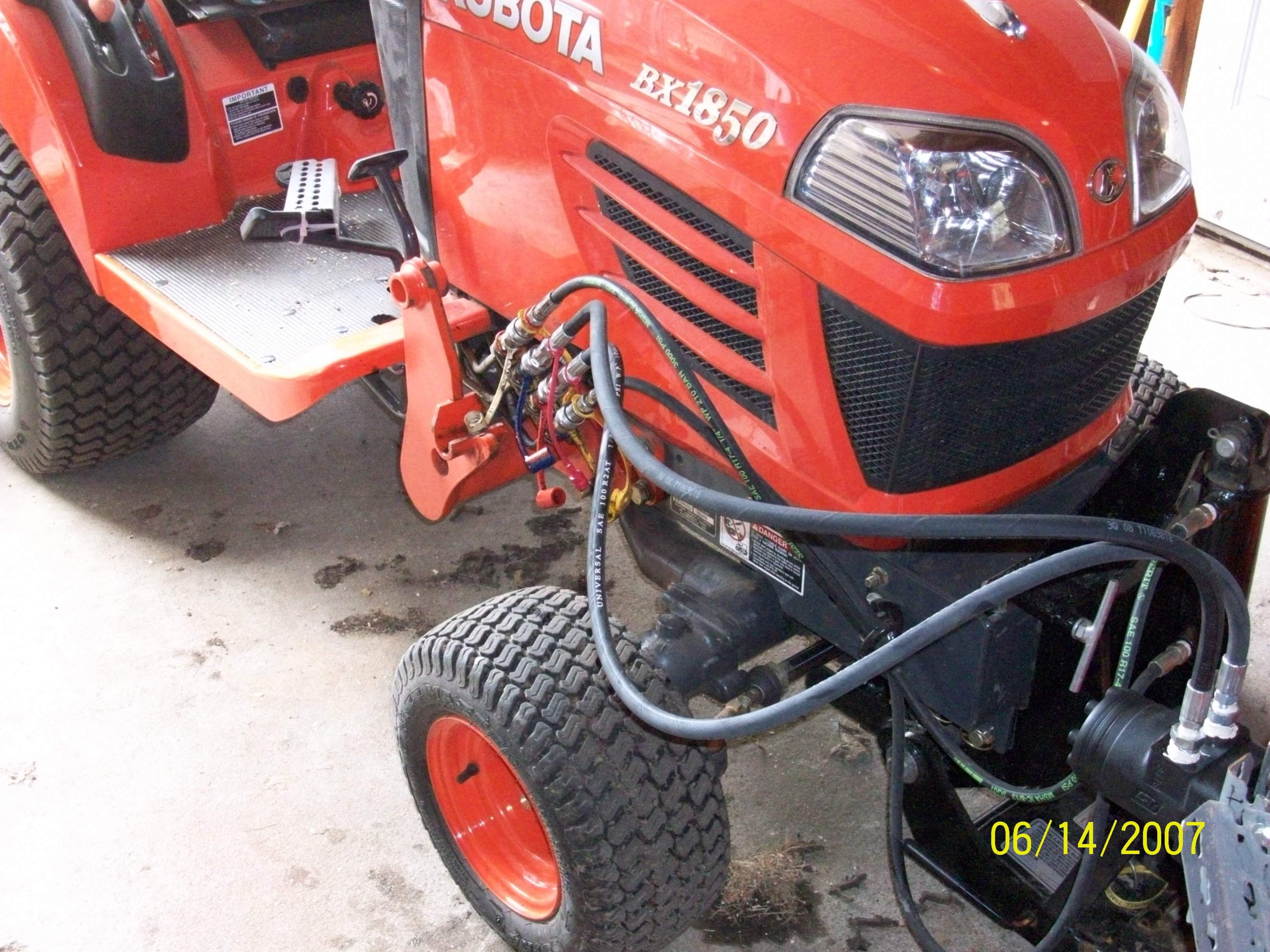

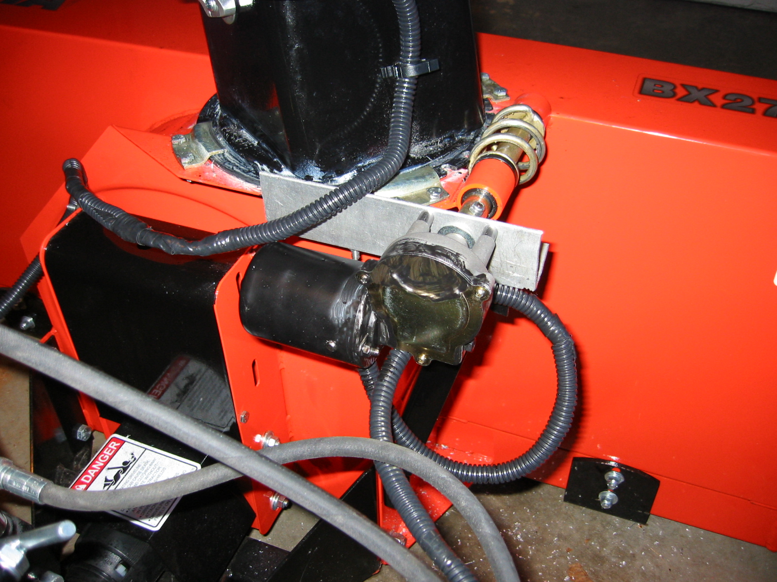

I built my own rotator this spring. I bought a hydraulic motor and a couple hoses and fittings on the internet, and built the framework with scraps I had. It uses the hydraulic connections for the bucket, and I connected the motor to the existing hand-crank mechanism, minus the shaft. It cost me $200, and wasn't that big a deal to do; it has worked great so far.

Well i kinda got delayed and side tracked. Dang work gets in the way everytime. Well i got the rotator arm installed and everything installed today. i used a 11" stroke 1" bore cylinder i got for 25 bucks. So i mocked up everything and test fitted it all up and it worked good. So i totaled it all up and im into it for about 100 bucks. But i think its worth it. I had the steel for the mount so it was free(bought a pile of good scrap for 40 bucks at a auction with lots of good stuff. Ill have to get some pictures up tommorow once i find my camera.

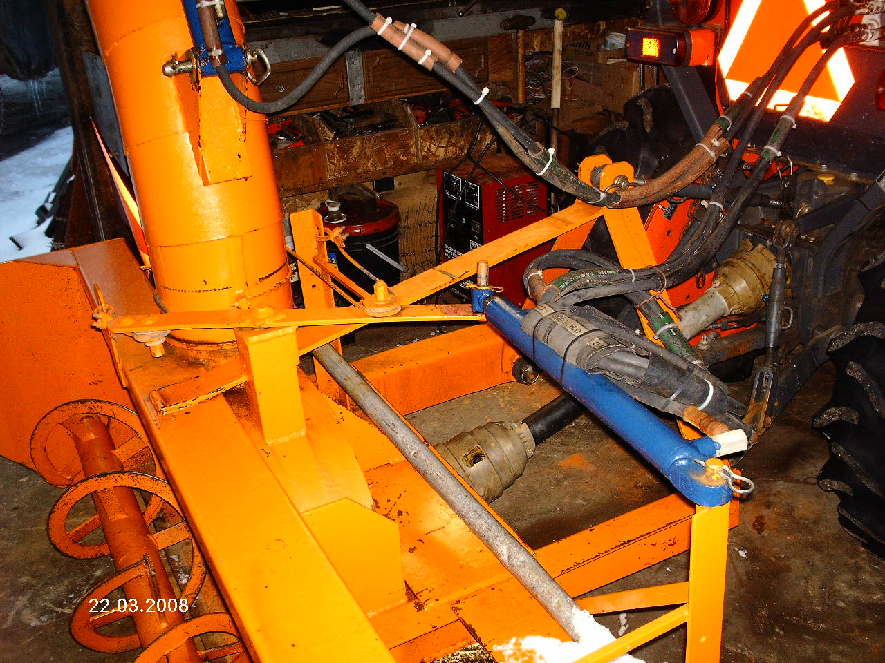

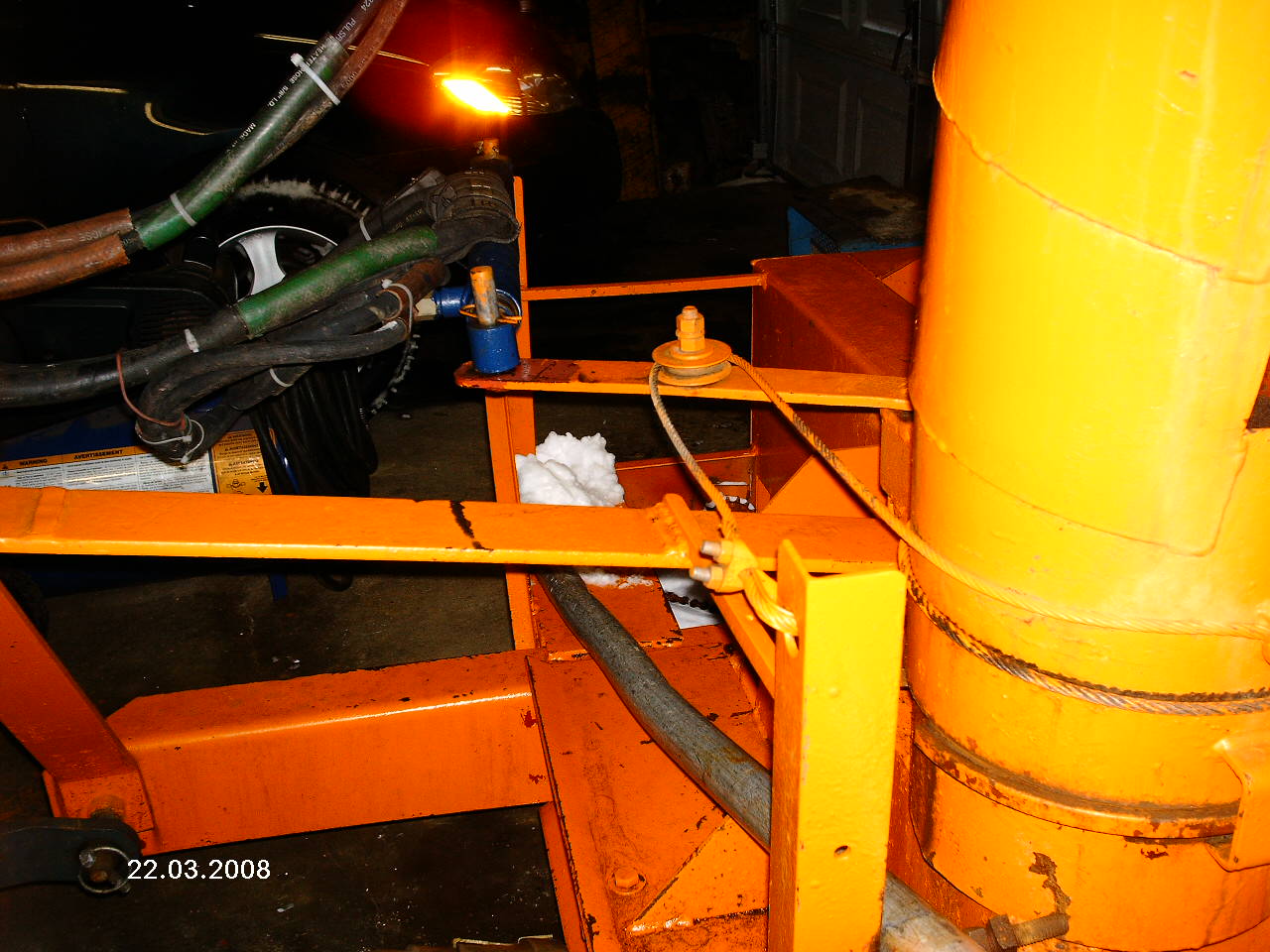

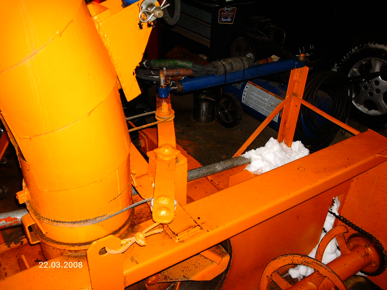

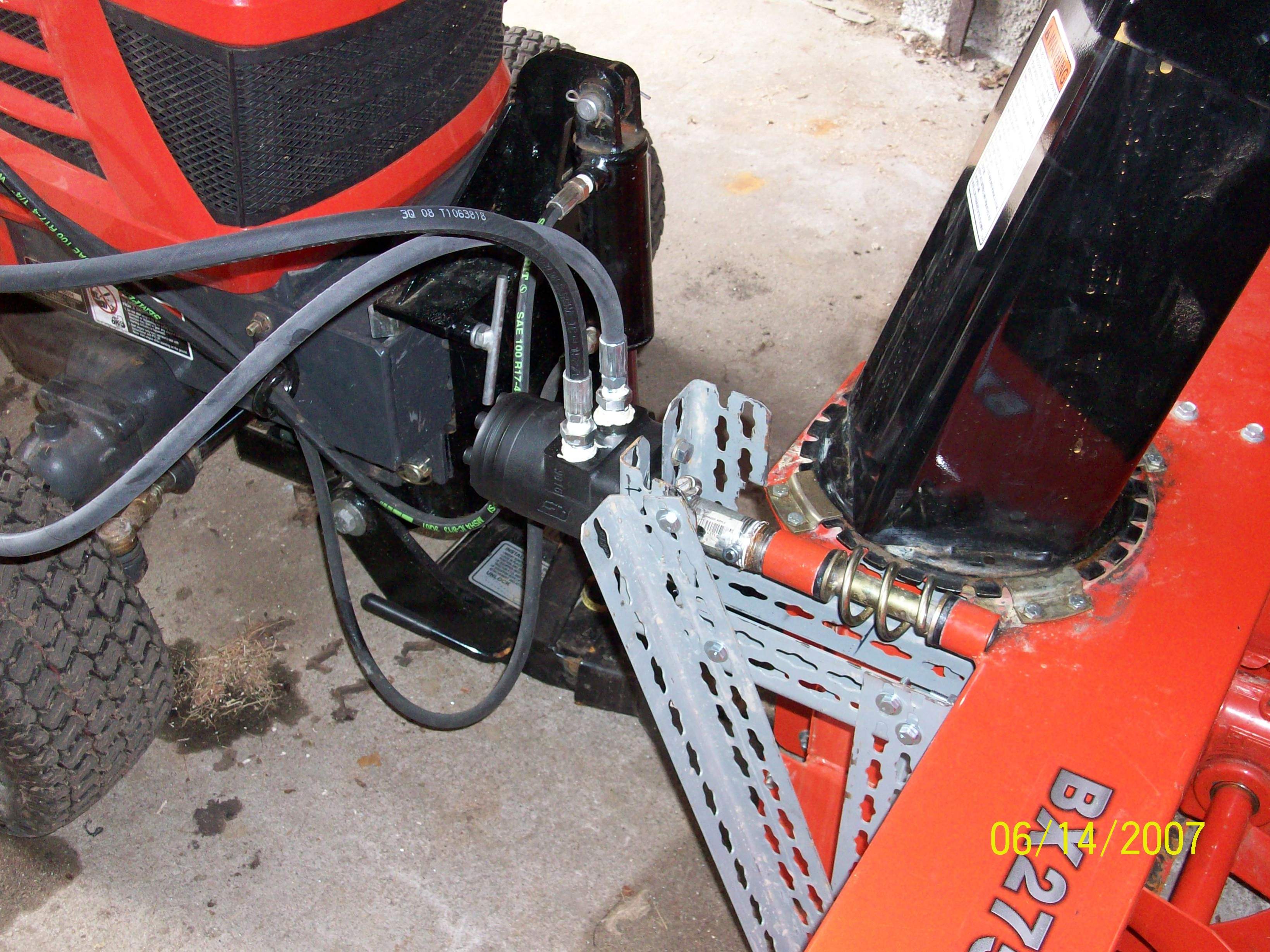

Here's my version I put together close to 20 years ago using a surplus cylinder and steel and cables I had lying around. The only parts I had to buy were the 2 pulleys and the hoses.
It has always worked great. On my previous tractor, I could rotate it well over 210*, but I had to reduce the rotation for the B7800 or the chute would hit the cab when the blower was raised. I did that by changing the pulley spacing.
The cable is a little sloppy now since I bent the cross bar the pulleys are mounted on by trying to rotate the chute when it was frozen up.:( (Snow had melted, water ran down to base of chute and froze chute to blower body.)
