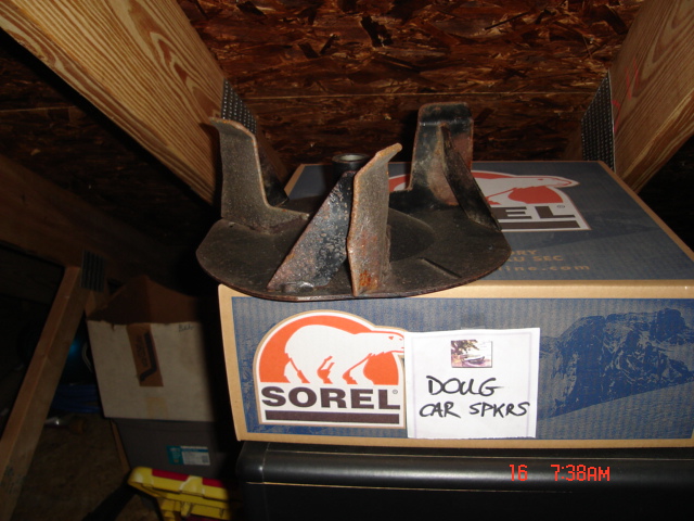

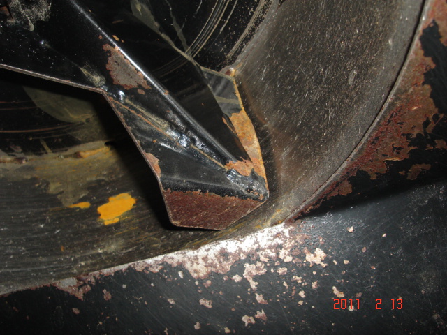

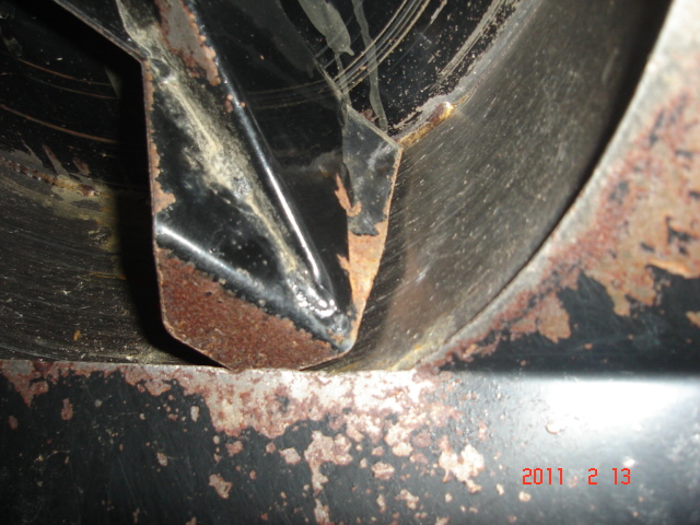

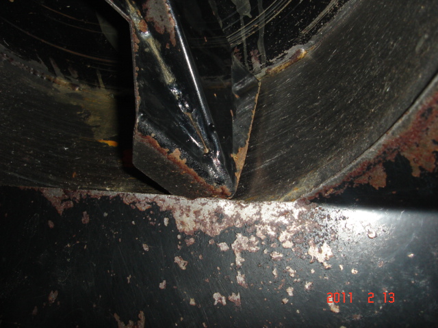

Here's what I was talking about... My driveway's pretty good, but when I go up to our dirt road to strip back the snowplow ridges so I can see oncoming traffic and the mailman can get to the mailbox, I occasionally pick up a good-sized rock that came from the middle of the road....:cool:
When that gets into the blower, it'll curl the fan blades back, increasing the gap between the impeller (fan) and the cylindrical housing. That will reduce the throwing distance real quick.
Had to pull the impeller on my walk-behind and beat the blades back into shape a couple of times before I gave up and replaced it; looks like my tractor blower's going to need a little TLC, too! Third pic is the one blade that has (so far) escaped being nailed by a rock; that's what it should look like.
Fourth pic is my old Toro walk-behind's original impeller- same curling on the tip of the blades.
So today, I'll see how to take the beast apart- anybody got any service info on the RAD Technologies M-F/Kubota blower? I only have the owner's manual, which doesn't show much.
