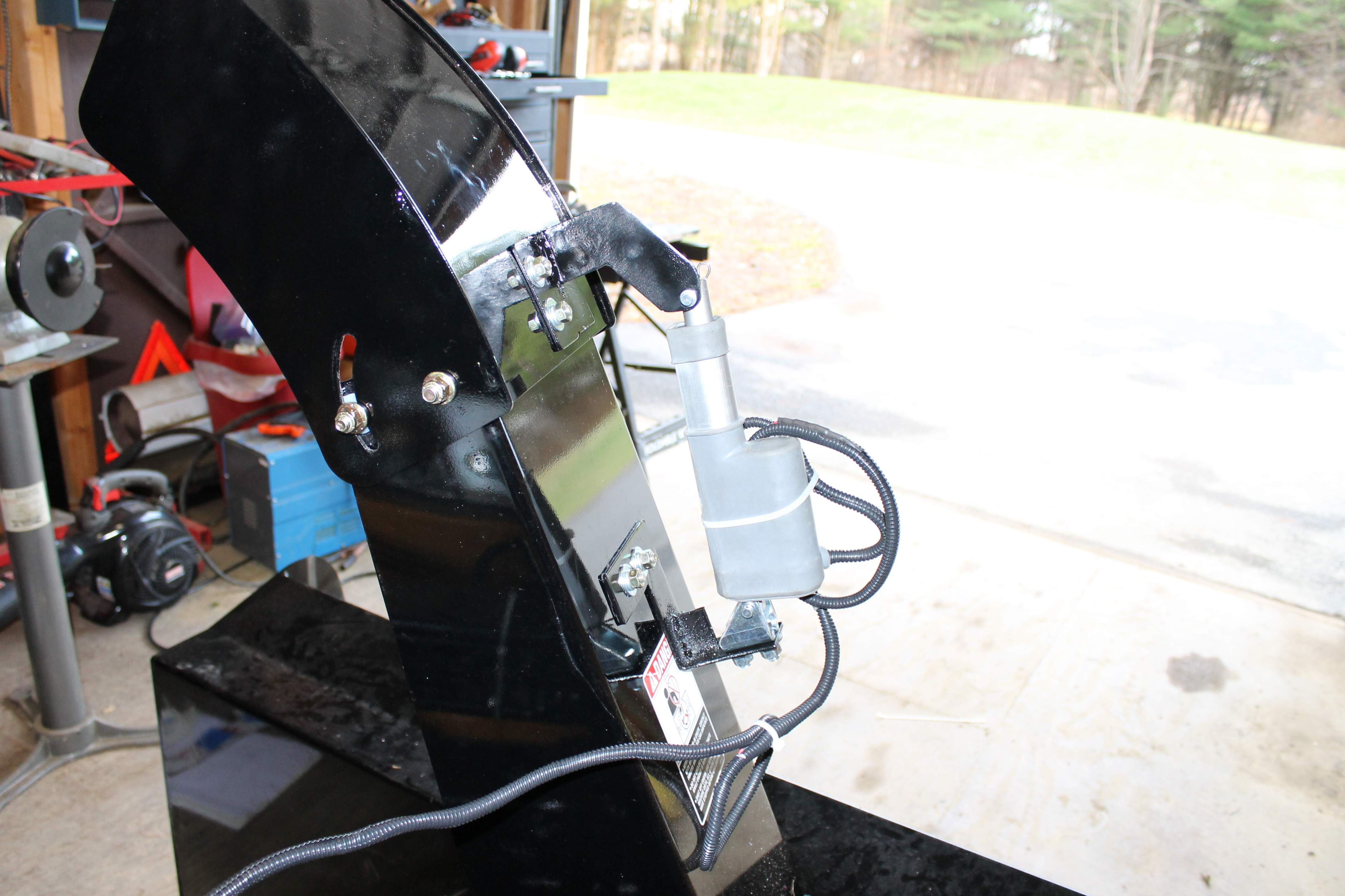

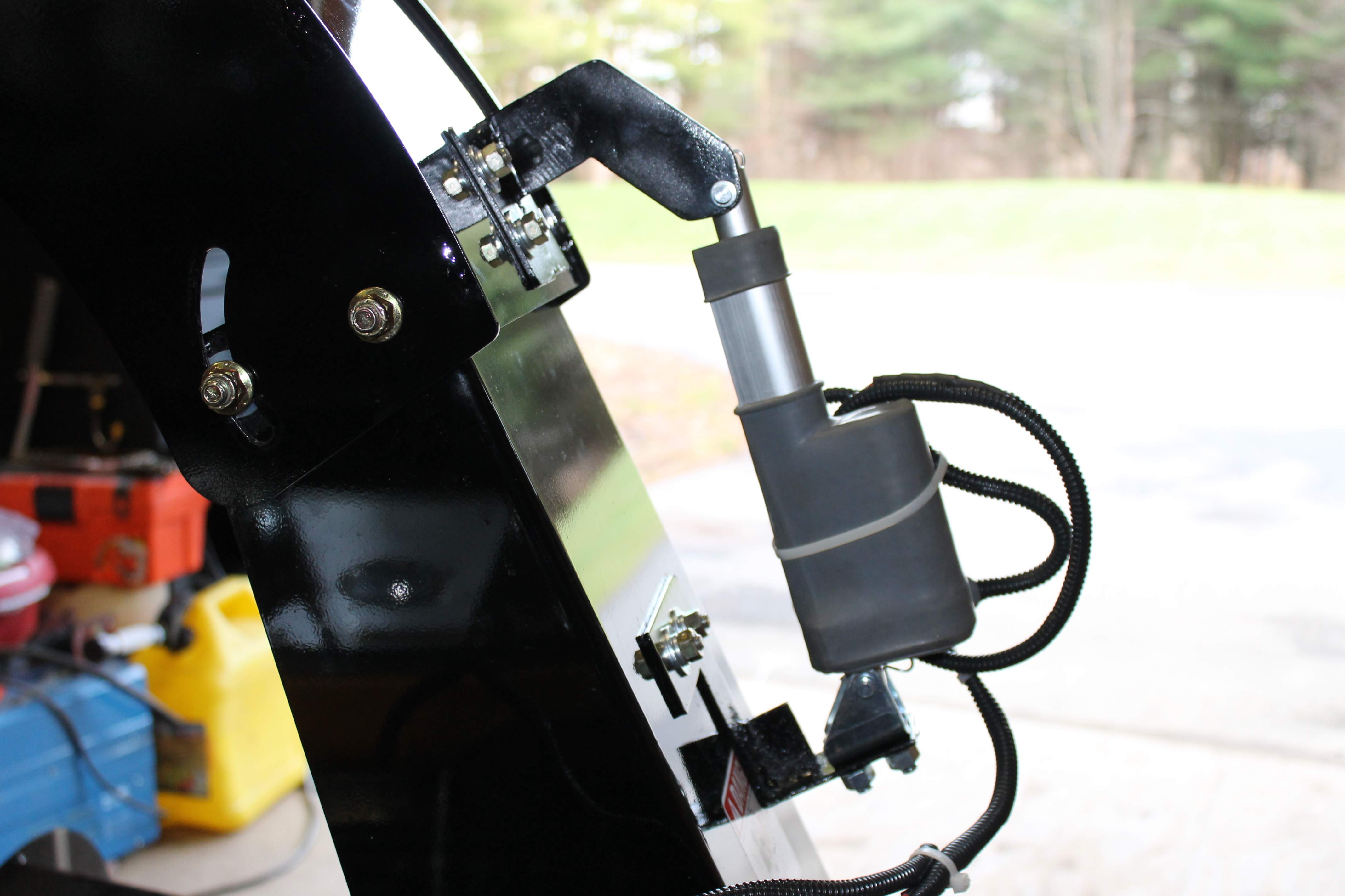

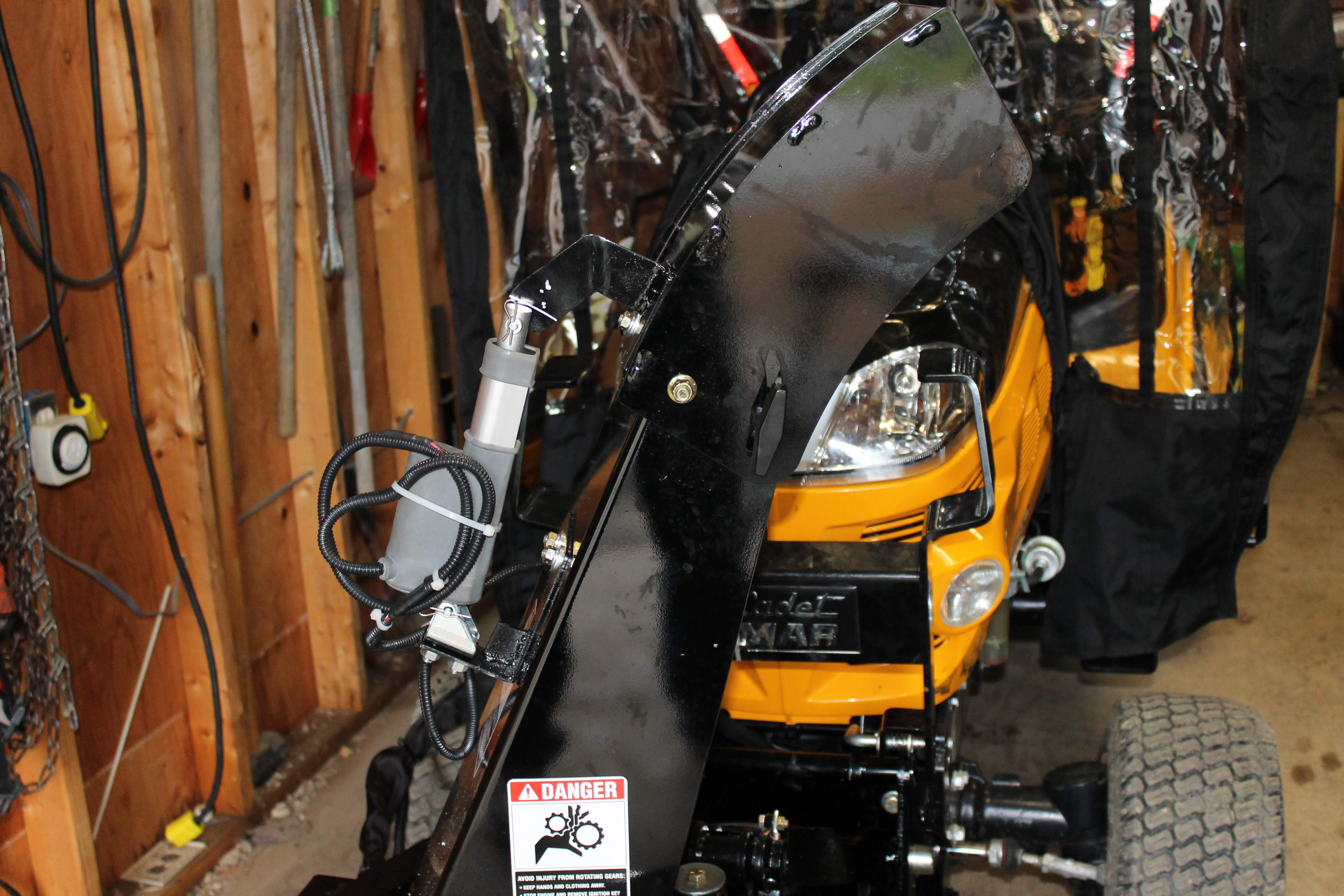

This is how I did an actuator on the SB52 blower.
There were holes already in the chute and made my brackets using these holes.

I saw some of your other posts about that. Nicely done.

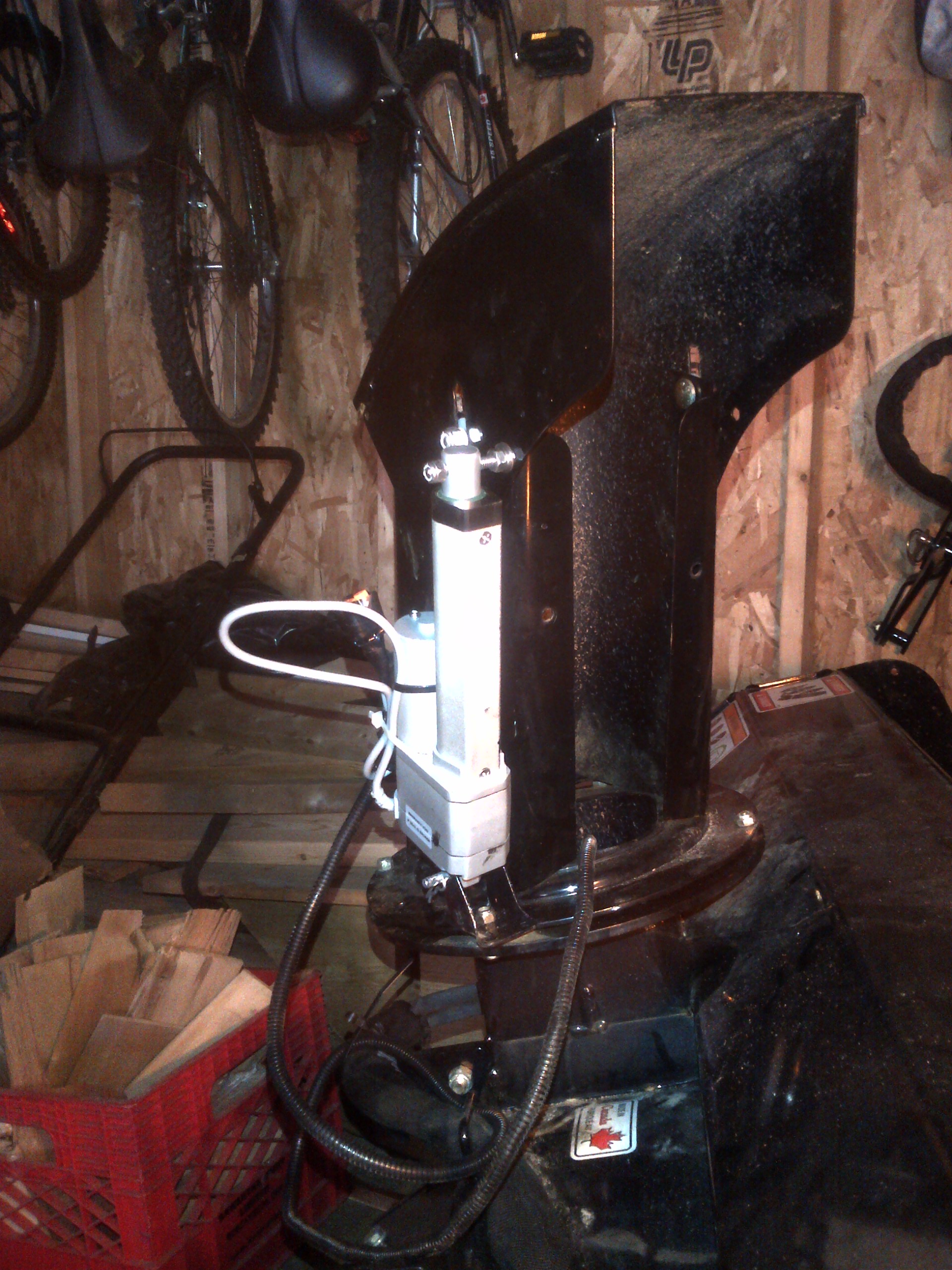

As a follow up to my BeroMac revieiw. I installed an actuator to control the final snow deflection. Holes were already in place. I bought the actuator on sale at Princess Auto for those in Cda. I got one with 4" stroke which left about 1/2" room at either end of the deflector, which means the actuator should never be stressing the blower flap. For the bottom bracket I bough a fixed caster (2"?) and took off the wheel. Drilled a small hole in centre of bracket, to fit to base of chute. Painted bracket black, looks and works great. I used the black and red wires only with a double-on momentary toggle switch ($4.99) to allow for reverse polarity to actuator. see pic. Final price was less than half than the kit from Bercomac would have cost
