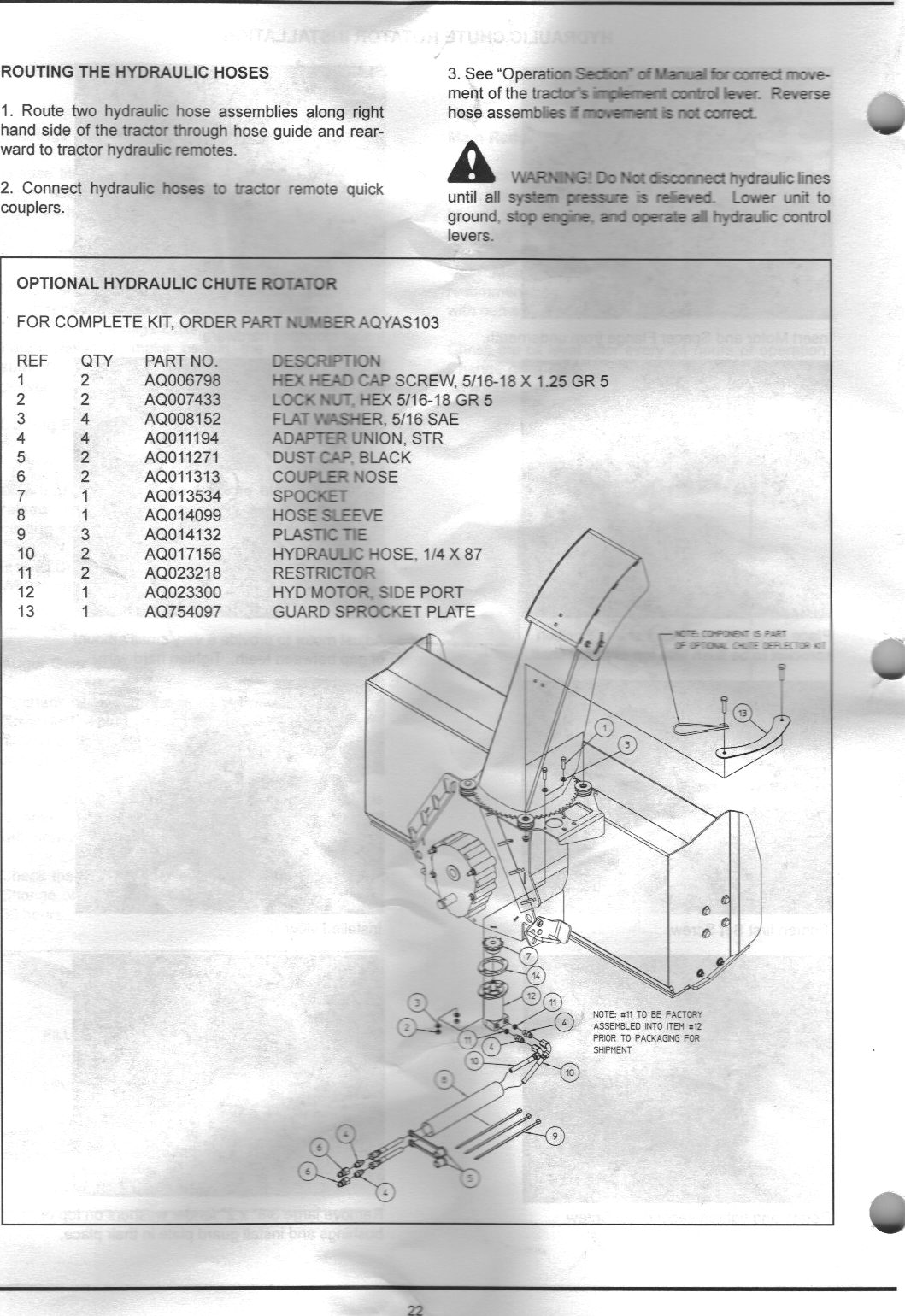

I did not ask if there was an option for the chute deflector, was going to try it this winter without any chute control but got to reading and seeing that people had made thier own.
I know their is an option for it, I was reading the manual that came with the SB52 snowblower that bolted on the guide bushings in an arm for the chute deflector option.
ericher69 said that Kubota wanted $800 fot their Hydralic chute control, I knew I could make one work for alot less.

I got the 12 volt from under the right side fender (if you are looking at the tractor from the rear) There is a 12 volt plug that runs along the right hazzard light wireing, This 12 volt plug has a positive and negitive connection. This plug is used for an optional work light the actuator that I bought is only .05 amps.
The measurments of the top bracket:
3" wide 3-1/4" long and the bracket going up to the actuator is 1-1/4" from the side and 3" high.
Bottom bracket:
4" wide 4-1/2" long and 3" high.
Does any of this make sence?
I built the brackets using the exsisting bolt holes on the chute.

I used the SB52" snowblower today, We had 3" of heavy wet snow. This is a fantastic blower. I never cloged and threw the snow a long way.
This is the first time all winter that we got snow. so this was its madien voyage.
The actuator for the chute deflector worked great also, was worth the time and energy it took to build it.
