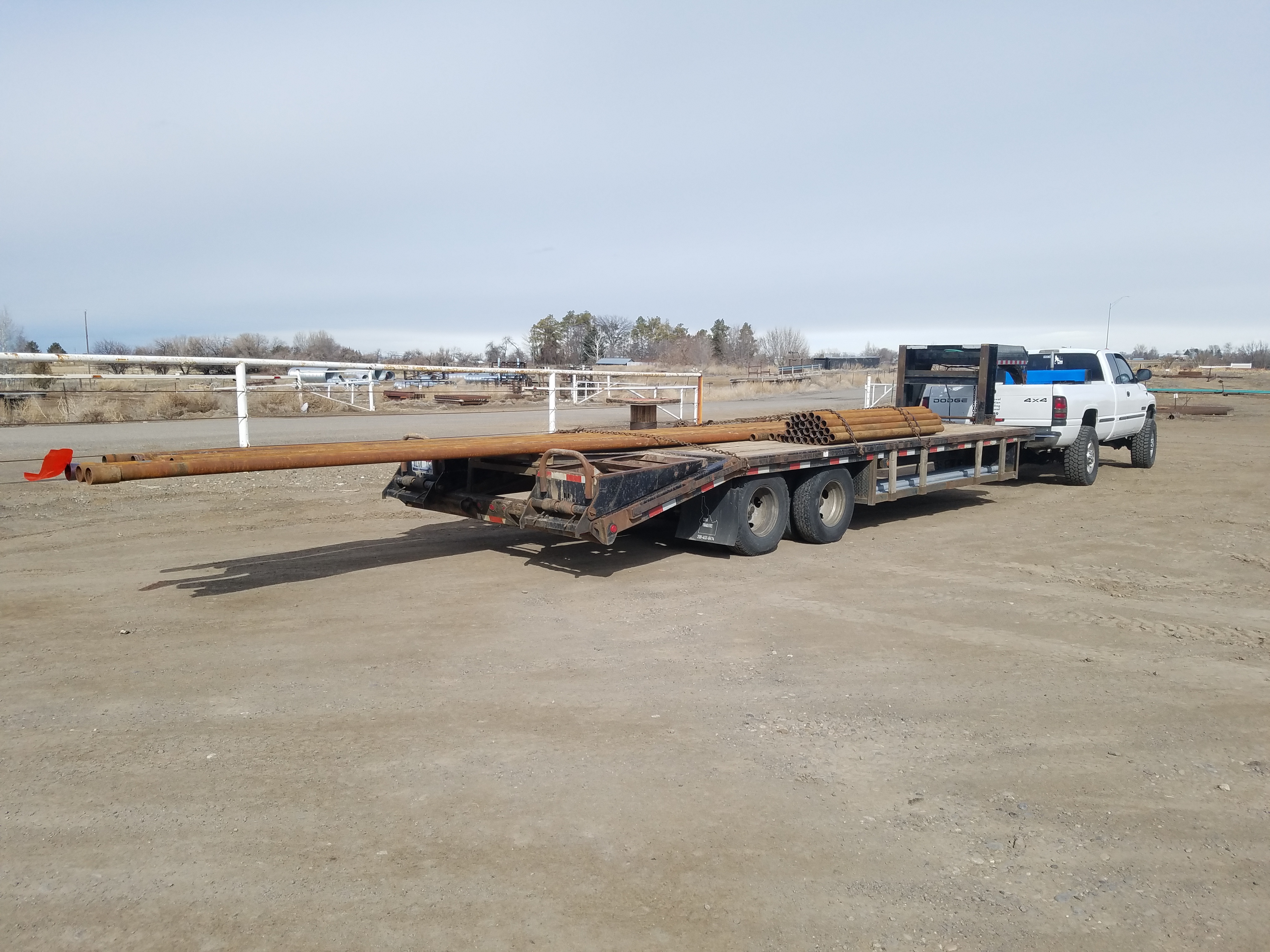

Horse fence on my property. Itl be a on going project
/ So it begins
Its all 2 7/8" cost for smaller only went down 100bucks fir about 375ft of fence.
/ So it begins #4
Looks bigger on the trailer
/ So it begins
Drill rod is 31ft posts are 7ft to make a 5ft tall fence.
372 ft to start. Have 2 acres to fence. This is just enough to go around the barn area

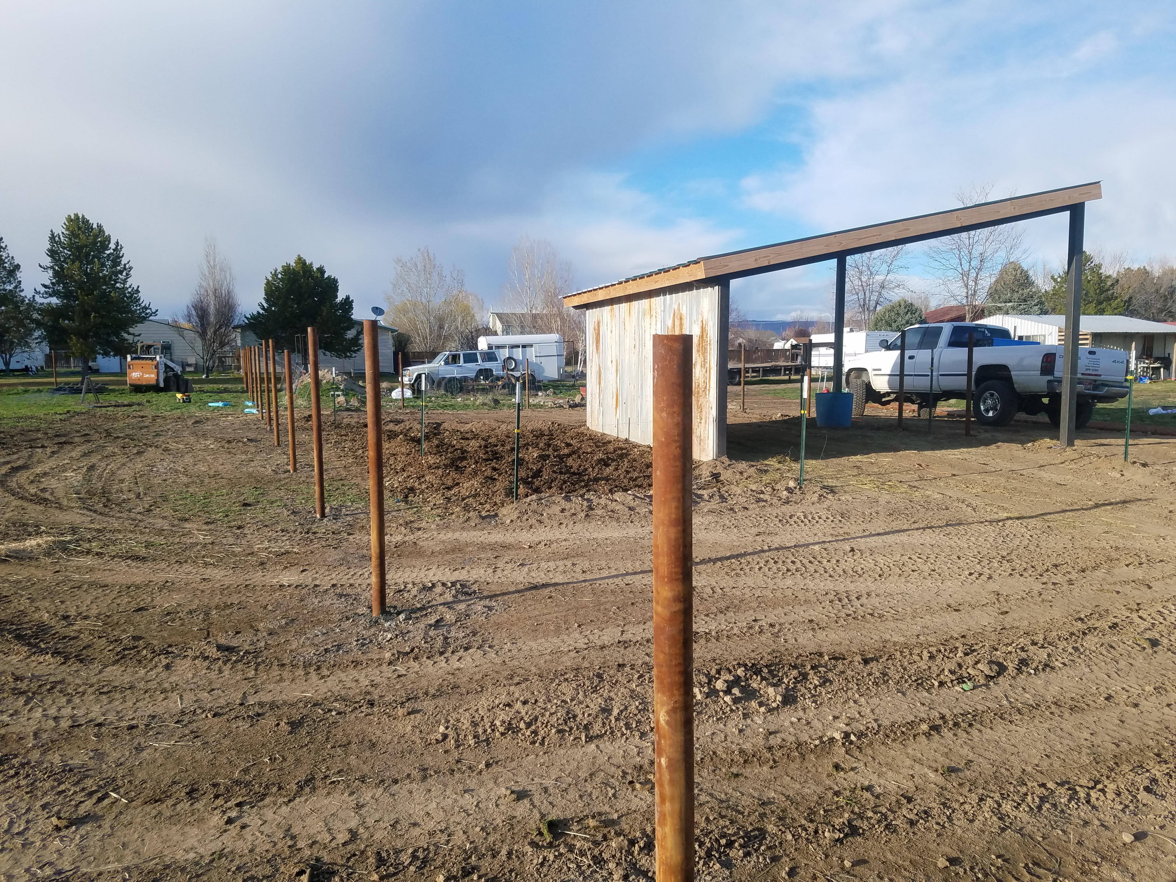

Had crystal chase a craigs list ad today got this torch for 100. Id planned to get 30air but that just didnt work out.
Im glad its not a victor. I bought brand unknown and site unseen. Headed home now to see if it works. Hooefully the bottles i bought 10 years ago didnt leak.

I guess those are too tall for the horse to jump over.
/ So it begins
#12
Bought 50", ive got some barb wire at 48" seen a few horses run through 4ft tall fence but never jump it.
Torch seems to work well. I bought 2 7/8 coping tool. The tool is awesome and im suprised how well the torch is working i make the cut then ooen the cope up with flap disc and its a perfect fit. I did 8 posts in about 2 hours and that was the wife and i figuring out top rail height. The barn front is set up for a gate in the middle. Itl eventually have posts coped off the top rail going up and then be sheeted in with metal walls and a opening in center.
The barn looks unfinished because that high point us the ridge. Some day ill ad on or build a 4 or 6ft drop down to creat the ridge. Were undecided on its size it may get a tack room exstended 10ft or so towards the camera.
For now its lean too with a fence going through it.
Torch was very much worth 100 to me. Came with extra new cutting tips a welding tip and im guessing a rose bud tip. However it does have a few leaks in 50ft of hose.
Have probly 2000ft to go ounce this 370ft is done ;)
