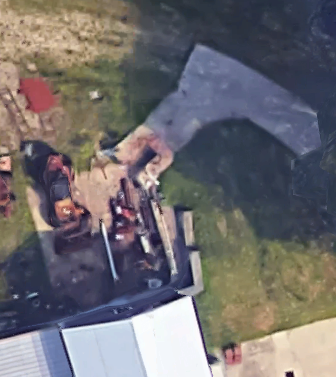

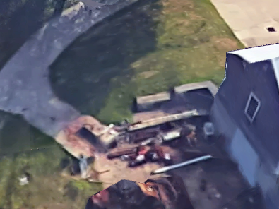

Oil pits aren't allowed here, but a friend's Dad has a shop building on a side hill, one leg of the driveway loops around as a ramp. When it gets to about 2' high, there is a level concrete section that runs perpendicular and meets the shop apron, with a gap in the middle.
Sorry the pic is a little weird, it's from google maps "3d".
   / So what would you have done different with your new shop? #49
Yes, they are a bit dangerous. I had a ramp like you show, built out over a driveway that was three or so feet lower than the one uphill that I could back out on and have a "pit" to service stuff. I don't have any slopes on my current place, however, so that isn't an option. It does work really well if you have the topography for it. Then there is this option for a "lift"
