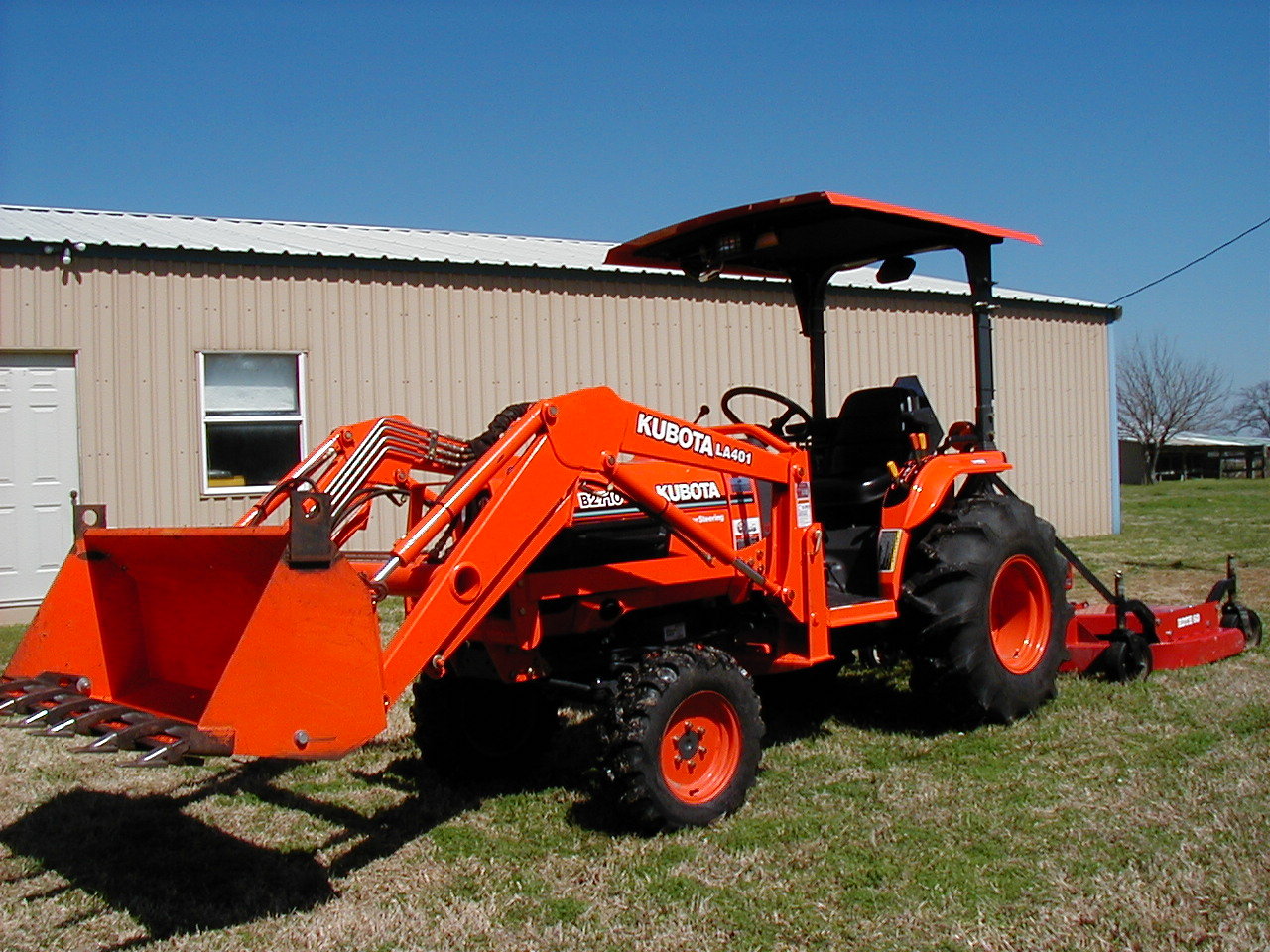

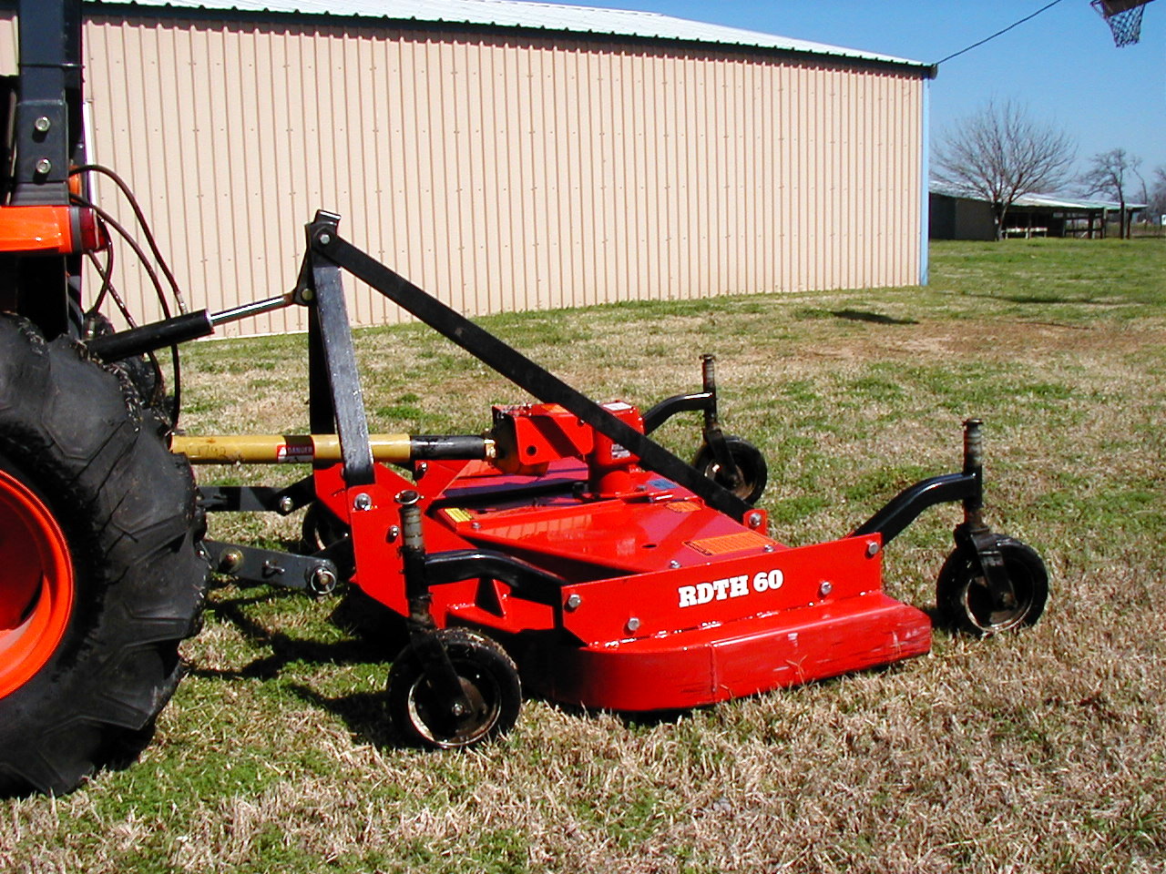

I have both a RFM and MMM for my 2520. I feel the RFM actually gives a nicer cut, probably because it follows the terrain better.
Also, you can get a RFM with rear discharge, which tends to spread the clippings out better than a side discharge. There aren't many side discharge MMM's around.
Another advantage of a RFM is that you can use it for ballast for the loader if you have one.
As here:
