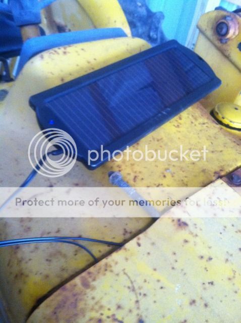

Would I still need a controller? What is the best method to run the wiring (type?) the 40 foot that would be needed. Will that length hurt anything?
   / Solar Batter Tenders #22
Well lets find out. with some basic math, some formulas and data we can look up, and let it guide us to a decision, OK, ready to start?
In general you are not going to need a charge controller for these small 1.5 watt trickle chargers, which is probably all you are going to need, but as for the 40 foot of extension wire, we kinda need to figure out what the voltage drop is going to be over 40 feet of "some sized" wire, you did not specify what gauge of wire you were considering. Obviously the larger the wire the less loss (voltage drop). Here is an example of a simple 1.5 watt solar charger.

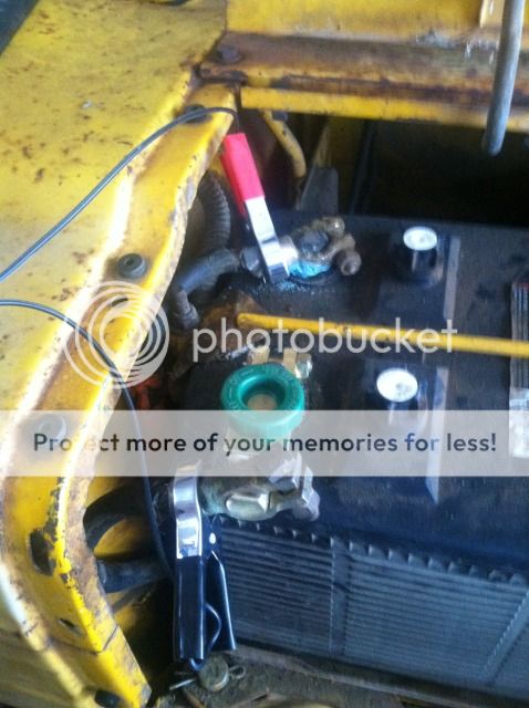

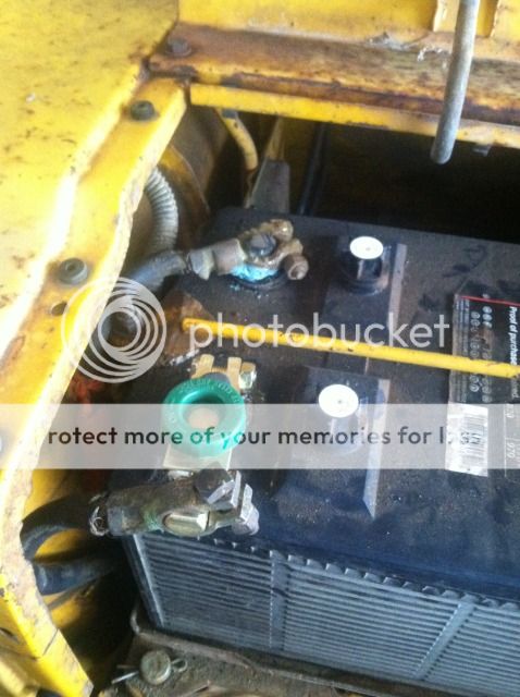

Wont get much easier of an install than this either
If there is a fuse in that holder, then the parasitic current draw is just going to flatten your battery again, even with the Green stud Off, or removed.
That fused Keep Alive lead is supplied with those battery disconnect switches so that if you have a specific load (say, an alarm system) that you want to always have power, then you can run a separate dedicated power line to that one load through that fused lead.
Just pull the fuse out, or remove the Keep Alive lead at least until you get the problem traced.
Rgds, D.

I would not be using that black wire that jumps across the disconnect. I have nothing I need to power on the tractor while I am not there.

So if I understand this right I can buy this
1.5 Watt Solar Battery Charger
and add 40 something feet of this
Shop 18-AWG 2-Conductor Thermostat Wire (By-the-Foot) at Lowes.com
and prevent any batter loss with this
http://www.harborfreight.com/battery-disconnect-switch-97853.html
and for less than 50 (would still have to buy the alligator clamps to hook it to the battery) bucks I will have a battery that is always topped off and doesn't bleed energy while I am gone.
Is the a valid understanding? If so I will pick up that solar charger TOMORROW, as they will be digging the footers on Thursday and I can get all this hooked up then. I have to switch to the grader blade anyways for incoming snow and I might as well do this stuff so I don't have to jump start the tractor the next time I am out there.
Good to hear - wasn't sure if that was your battery, or a random pic.
Rgds, D.
