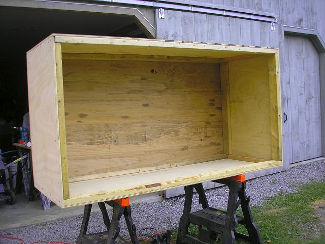

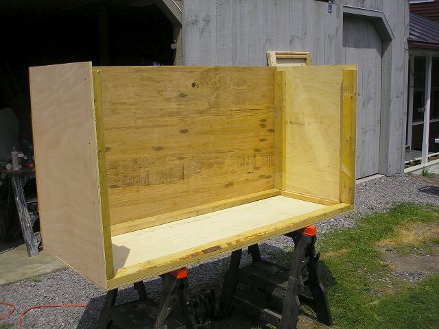

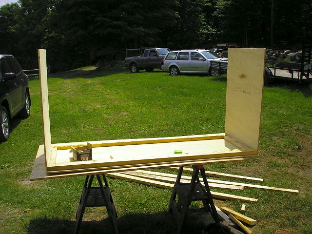

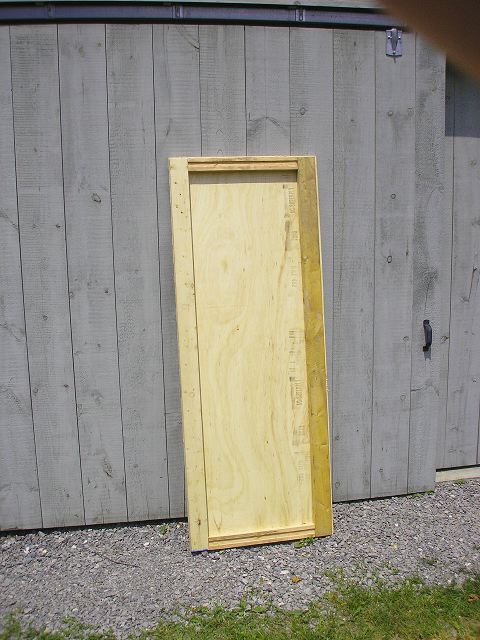

Before setting the battery box in position in the basement and dragging the batteries down, I wanted to be sure my approach to lifting the batteries into the box would work. The approach I'm following is to use an engine hoist to lift the batteries, roll forward, then lower them into the box. The hoist has retracting legs which enables me to get it close enough to the battery box with the lift boom hanging far enough over the box to reach the back row. However, counter weighting is needed to keep the hoist from tipping forward. I wanted to figure out the whole counter weight thing in the comfort of my garage and be sure it would work.
The first picture is of the box in the background and the lift in the foreground.
Next shows the inside of the box with a grid marked off for positioning each battery
Next are the two pallets of batteries covered in the yard
And, so we don't forget this is all about tractors, here are the batteries on the tractor forks on their way into the garage.
The last two show one battery being lifted and lowered into the box. I was able to reach the first row with an 80lb bag of cement on the back of the lift. To reach the second row I had to extend the boom further and with two bags of cement the lift was just balanced. I'll add something else to be sure it's fully counter weighted.

looking at the pics and reading the posts, I was wondering if you have enough head room to raise up the box higher so the batteries will still clear the top of box when installing/removing them and have the wheels of the engine lift will roll under the box??? may have to play a little slide around to clear the under box supports that raise UP the box but might be safer than the counter weights on the lift?
Nice post I been reading and watching it a while now.!
mark M
/ Solar Electric Project
#48
I wrote you a reply yesterday but fat-fingered it, so here goes again.
I like your thinking, but the problem is just as you suspect. I'm just going to clear the joists as it is now when I load the batteries. Any more height and it wouldn't make it. In fact, I discovered a little oops in my box design and placement related to this. It turns out that there isn't enough height to open the lid completely. I was hoping to have it open fully and park leaning back against the wall. I'm about 6" short on headroom. Darn :confused: . Fortunately it opens enough to load the batteries, though for the back row I'll need to lower them most of the way down in the front, then roll back and set them in place. If I need to replace a battery in the back row I'll have to pull the one in front of it first to gain access. If necessary, I'll segment the lid and use a second piano hinge so it opens/folds onto itself.

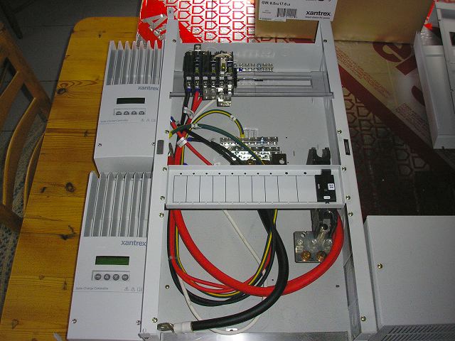

Then it was time to start assembling the electronics and get the conduit run between the battery box and wiring panel.
The first picture shows the breaker box. I placed it first so I could get the conduit run between it and the battery box. I had to move the box slightly to get the conduit in, but afterwards everything is in place to stay. The conduit run was critical because the battery cables are only 5 feet long and it's real close getting them to reach so every inch counted.
Then the rest of the gear gets installed. To the left are the two solar charge controllers, and to the right is the 6KW 120/240V inverter. I left the open panel space to the right and will mount the generator start controller and communications gateway there, plus other stuff over time.
