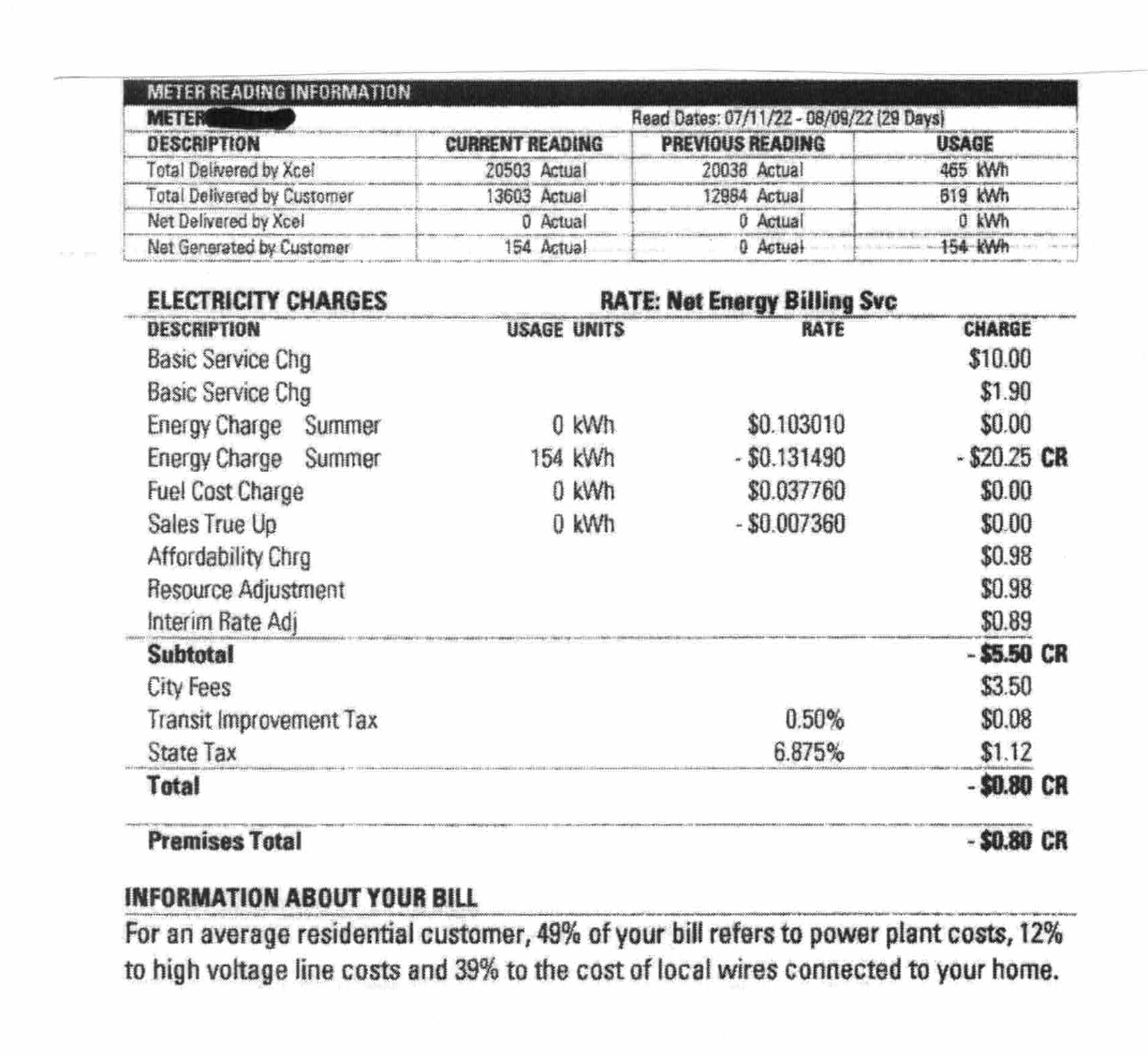

I have been told that I am the only thing getting cheaper nowadays. Whatever she says, I guess.
Here is latest electrical bill:
7.5kw solar array (no battery) average summer with90 degree days and humid too.
I realize we use less than normal kilowatt hours but I have been on a crusade to increase the energy efficiency for a
long time (replaced wall ac with split unit, led lights etc)
On the other hand, we bought a plug in hybrid last year so the demand here is fluid.
The solar production negates the utility supplied electricity so we end up with a credit.
The objective was to take a bill off the table every month.
