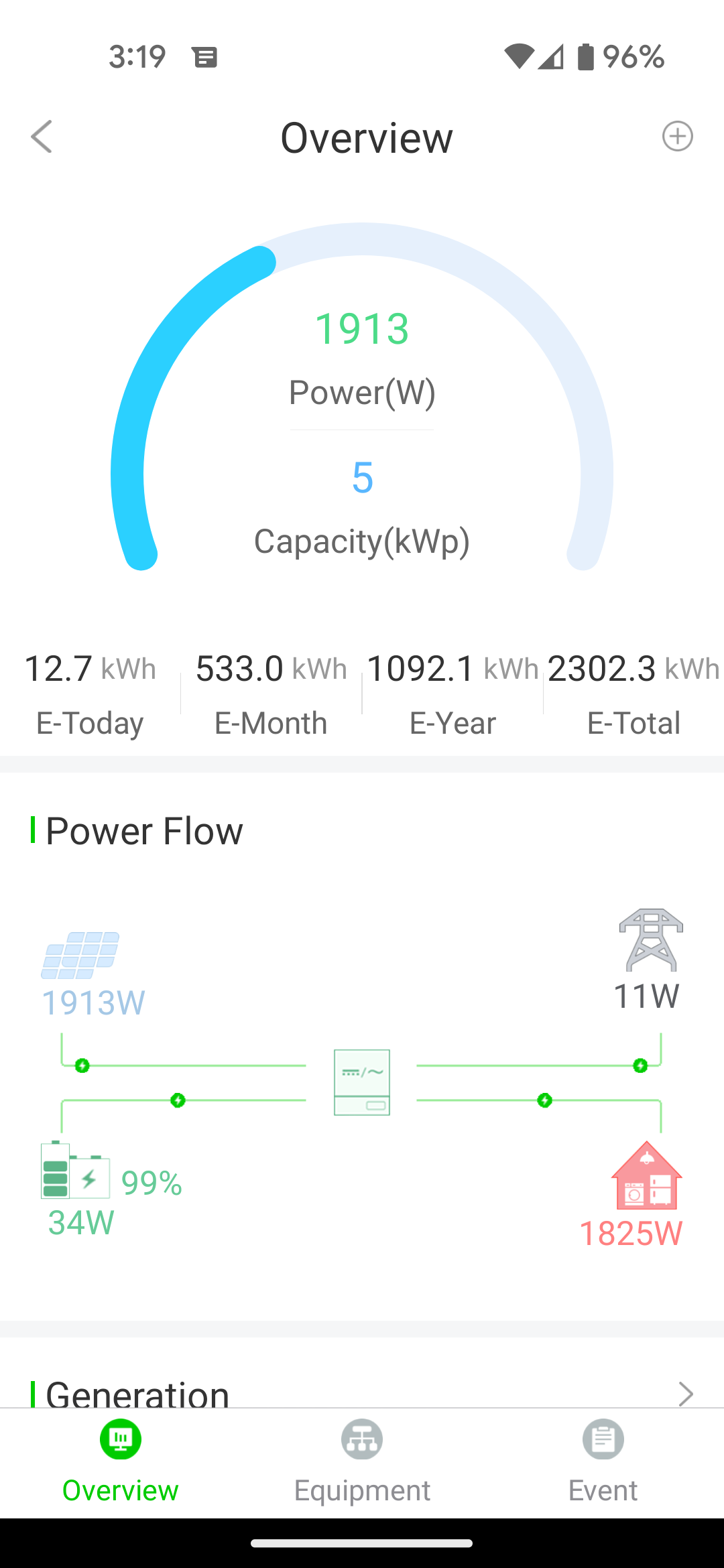

This is right now. 90° outside with a fridge, flat screen tv, and 2 mini split air conditioners running. 1100 sq. Foot 2-story house is at 73°. Screenshot_20220826-151958.png

I use more than that, but I only average about 400 kW per month that I have to buy from the grid. I do have a gas tankless water heater and stove that have been converted to propane. I have an electric dryer but only use that during the day when it's not warm enough outside to dry the clothes. I just put in a dishwasher about 4 months ago and was previously washing by hand. And again we only use the dishwasher and the microwave during the day if at all possible.
I put a screenshot below of my inverter for today. It's about 90° outside I run too many split air conditioners right now and the house is about 73°. It's an $1,100 ft² 1 and 1/2 story home.
Solar is fully providing for all of the energy usage of the home and has already charged my batteries for the day.
