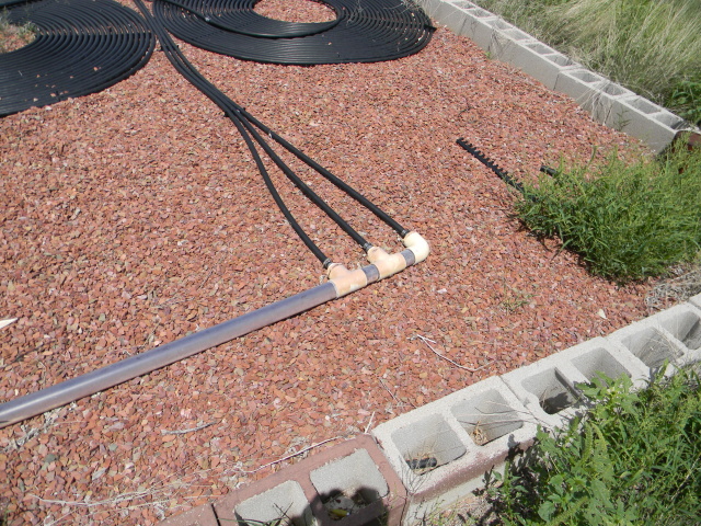

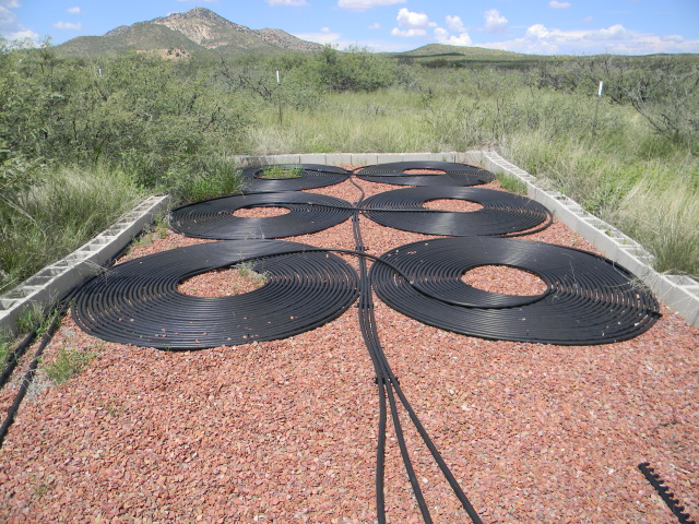

I don't think you have near enough pipe to make much difference. Here is mine there is 600 ft of poly. I think you would get more heat with a large manifold at each end rather than one long pipe.
