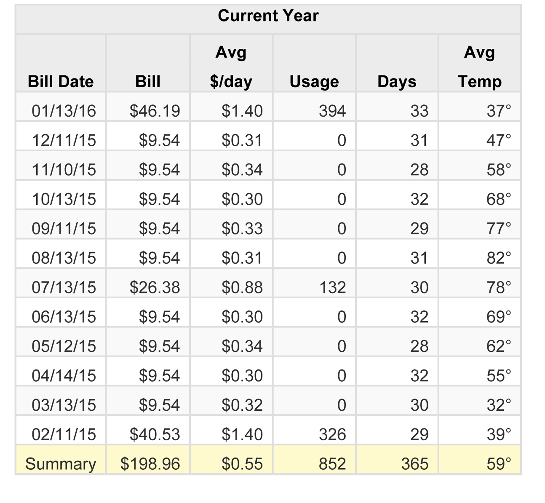

We installed a 25KW solar grid tied system about 3 years ago on our home (now a rental home). Here is our usage for the last 12 months. We couldn't be happier. We paid less than $200 last year for our electric bill, most of which was the monthly service fees.

You seem to be the only one talking physics when the subject is tax subsidies, cost, and return on investment. Pretty much everyone in this discussion agrees that when the wind doesn't blow or the sun doesn't shine, wind turbines don't turn and solar panels don't produce. That's why they have grid-tied systems. They consume the power generated on-site and sell the excess back to the power company. On days when they aren't generating more than they need, they draw from and pay for electricity from the power company. And everyone acknowledges that solar and wind wouldn't be viable without tax incentives at present. No one is saying its free power from nothing. What they are saying is that for X dollars they invest over Y years they are getting Z in return. And Z turns out to be more than X at the end of Y. Therefore, it costs them less over the time period Y, which is a great thing for them. It also pollutes less. Which is a great benefit to all of us.
