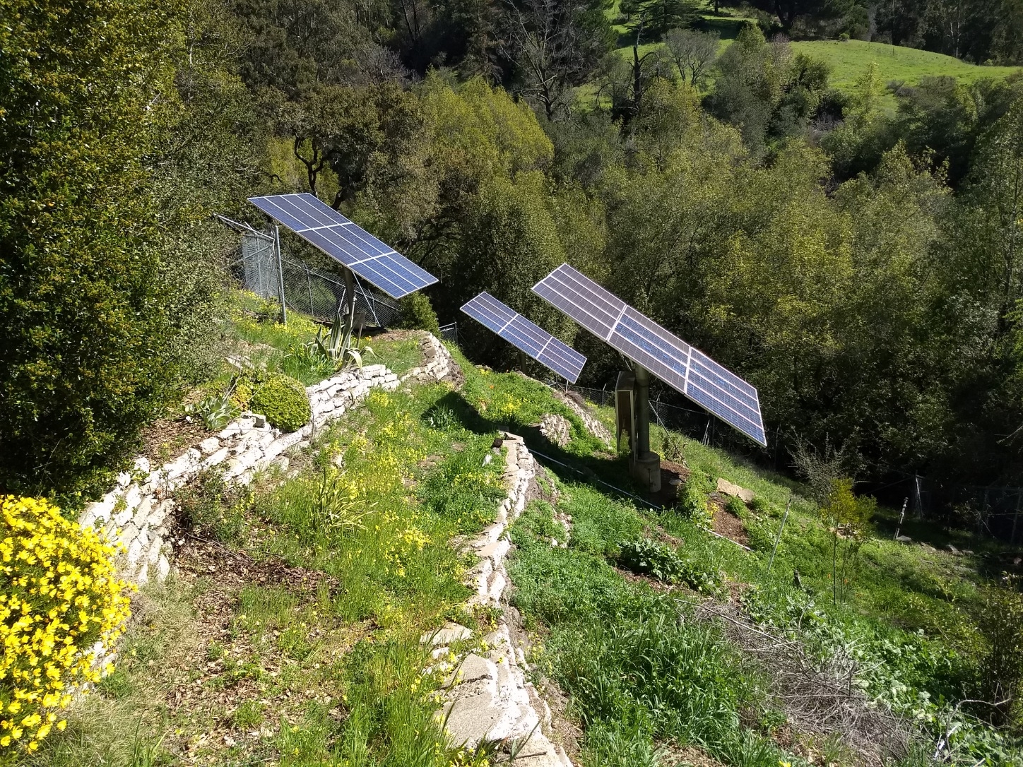

OP here
I dont know where I left off in this thread without going back and re-reading. But after about 2 months of getting information from my rural coop.....which was like trying to herd cats....I am moving forward with a solar install.
The details of my net-metering......
Currently a non-solar customer's bill is structured 3-part
1. service availability charge....$50. Everyone pays this just for the pleasure of being tied to the grid.
2. Generation and transmission....8.6 cents/kwh. This is what my coop has to pay buckeye power to deliver electric to local sub-stations
3. Distribution.....2.6 cents per kwh. This is what pays my coop to maintain their local distribution network from substations to residences
Those last two are always fluctuation a little. But this last bill totaled ~11.2 centes per kwh.
There is also a kva surcharge of $2.15 per kva of allocated transformer size over 10. Literally no one without solar sees this charge. Because a single residence with a 15kva xfmr.....that charge would be $10.75. Meaning if you didnt use at least $10.75 worth of electric....you get charged as if you did. and at ~11.2cents/kwh....that would be less than 100kwh.
Now for solar.....things change. The generation and transmission rates stay the same. But the new service availability charge becomes $57. And the $2.15 per kva over 10 absolutely may come into play.
Now in my case...I have two meters. One at my shop and one at my house. So I am paying The $50 x 2. At the time I built my shop....I was looking at a ~400' run of 350mcm wire to feed the shop, and having just bought the place and possible future plans of a new house on the hillside right where I would have to trench this wire.....and the ~$2500 it would have cost me....I opted for a new service.
Now that things have changed I want to tie the shop and house together and get rid of that $50/mo charge just to have two accounts.
I was originally going to tie the shop and solar to my house meter....but property layout, wire sizing, etc, it makes more sense to tie my house to the shop meter. So that is what I am planning.
   / Solar production. Panel ratings/claim vs reality
#105
Continued.....didnt want a single long post....
So far I have everything ordered and expect panel delivery today.
Details of the system....
30 canadian solar Bifacial 540w panels
7 Hoymiles 4-into-1 inverters
1 Hoymiles 2-into-1 inverter
Those trunk lines will feed into a 100a outdoor main lug load center. Each trunk line can handle 3 inverters. So I'll have 3 trunk-lines coming in to 30a beakers.
The main lugs of that panel will feed a 100a disconnect as required by my coop. That disconnect and main panel will be at the array. Then a ~125' trench to the meter and connected to the grid.
All of that is gonna sit atop a sinclair skyrack with season adjust jacks.
The only thing I have not purchased yet is MC4 extender cables. Given their cost....there are too many variables that may change how many or how long I need. Given that I dont know how long the leads are on the inverters, or how/where I am mounting them, or the orientation of the panels if some, or none of the panel leads will reach....I have opted to wait until I have the array built, and inverters mounted to see the exact quantity and lengths I need.
The panels were ~$4500 delivered. The inverters and trunk cabling was ~$3600 delivered. The skyrack was ~$4600 delivered. And I have other local expenses for URD wire, panels, and boxes.
Current expense to date is $15,300
I will still have ~$500 for MC4 cables, ~$600 for concrete for the posts, and ~$600 for a truck load of limestone for under the panels. (brightest color stone I can think of that may maximize bifacial gain). And once I get limestone coated under....I may look into some of that bright white quartz decorative rock. Probably a waste given limited gains but will look good.
So all in I am expecting about $17k
However, about $1300 of that cost really has nothing to do with solar as it is simply connecting my house and shop to a single service.
Given the 30% fed credit.....I am thinking true system cost to be $10k-$11k.
And with this size, I think I will overproduce quite a bit in summer. At least according to PVwatts calculator. And still be quite short in the winter.
But ballparking the ~11.2c savings and the 7.8 cent for overproduction....I am anticipating ~$2000 yearly savings.
So 5-6 year ROI expected for the solar.
