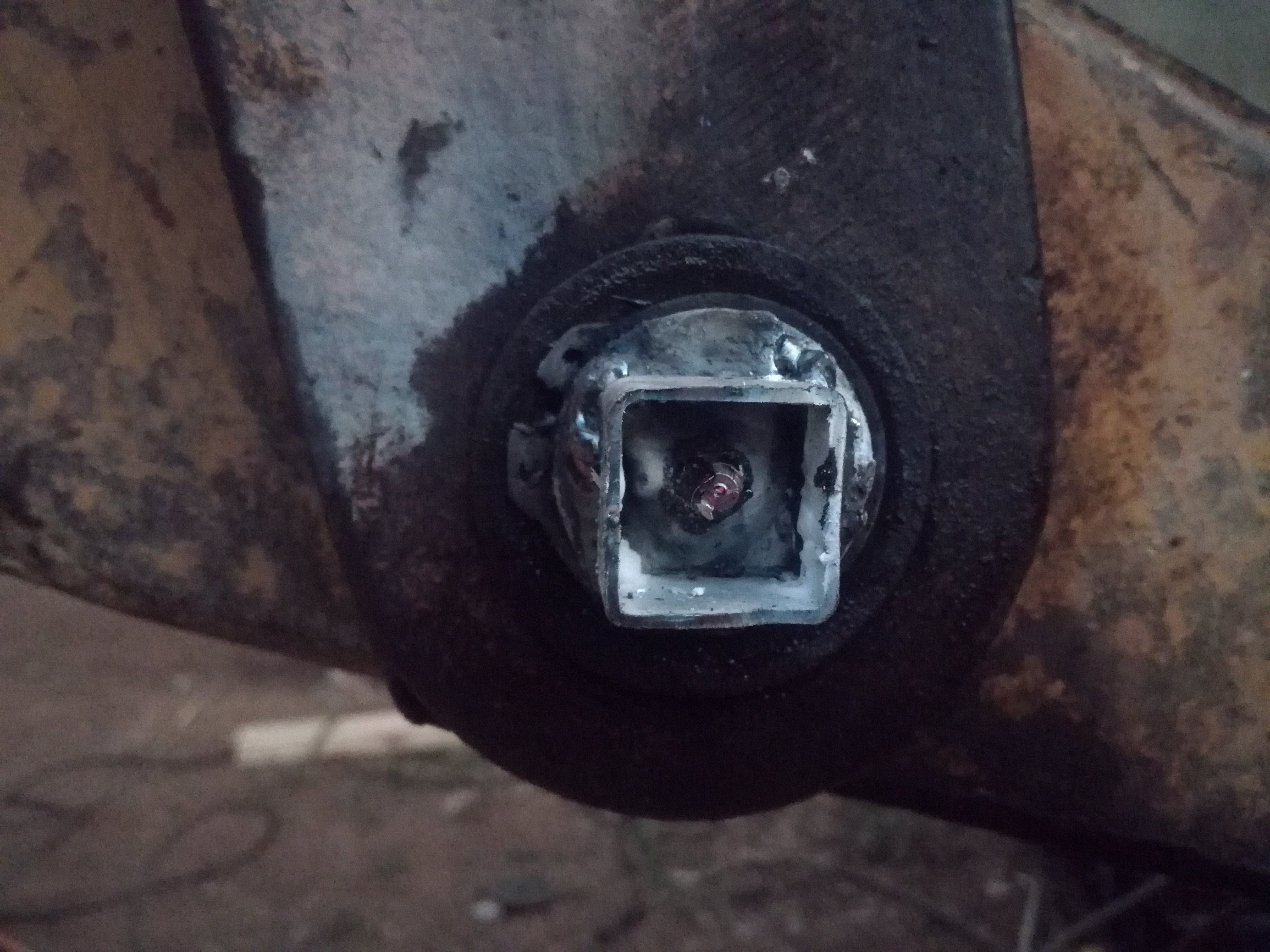

Soldering will not work.
For decades my low tech solution to a stripped thread has been the same. Bung up the internal threads a bit with a thin center punch. Or bung up the fitting threads a bit with a hammer. Maybe both. Now rig up a socket with a nut inside that allows you to put a lot of force on the fitting at the same time as you turn it. That almost always works.
Hola Pat, thats funny cuz I welded on a nut but kinda damaged the threads a little in the process and had to do something very similar to get the new zerk in the welded on nut. There was no metal left in the original hole to do that straight off.
Attached is a pic of the home surgery job, little sloppy but totally workable. After i welded the nut on and ground it down a little I put the piece of square tube around it to protect it a little from rocks and life in general. Did one identical on the other side and now this important pivot has grease in it for the first time since I got this thing going on eight months ago.

Better than factory. Good fix.
   / Solder in a stripped zerk??? #46
I got several like that on my backhoe. Only difference was a large nut was used for protection.
