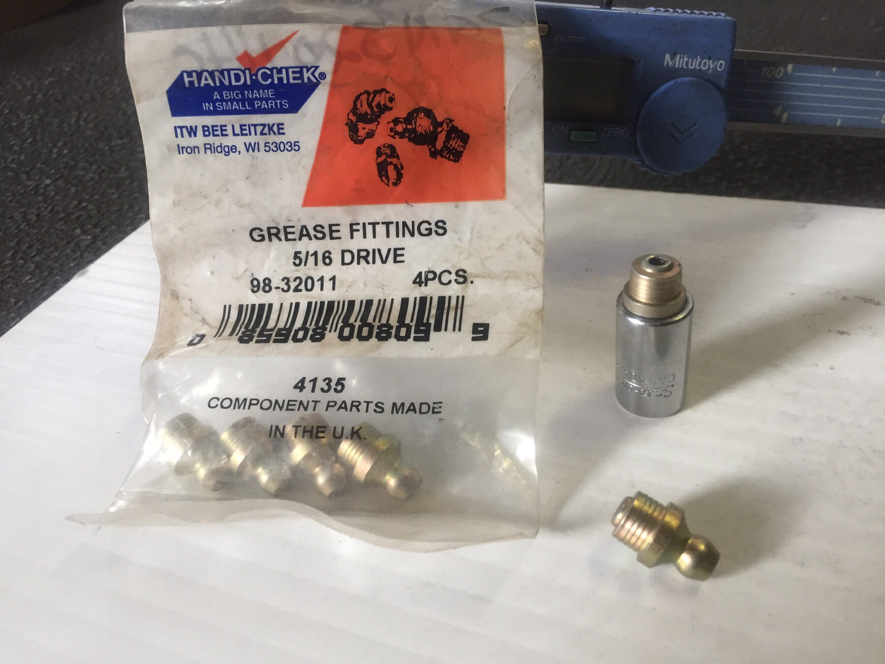

It seems that most of the respondents here are missing the most important part of the OP's issue.
He lives in Costa Rica!
He does not have reasonable access to a tap & die set, he does not have a NAPA, or other parts supplier, just down the road a bit.
The drive in zerks are likely the best idea for him.
Now... where should he go to get them?

OOPS!!! You're right. I missed that and didn't think of what's available in Costa Rica. I'm still not a fan of soldering it. I just think that's a waste of time with a scary chance of some of it going all the way through and into the area around the pin.
   / Solder in a stripped zerk??? #36
Soldering will not work.
For decades my low tech solution to a stripped thread has been the same. Bung up the internal threads a bit with a thin center punch. Or bung up the fitting threads a bit with a hammer. Maybe both. Now rig up a socket with a nut inside that allows you to put a lot of force on the fitting at the same time as you turn it. That almost always works.

bigtiller: Not sure if you were referring to my pic or not but
these are "drive in" zerks (not threaded). The 1/4" socket pictured was for driving in with a hammer if a proper drive tool was not available.
