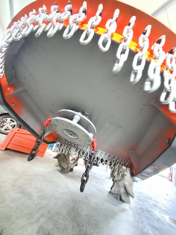

See if you can get the local militia to assist.
...or this :thumbsup:
