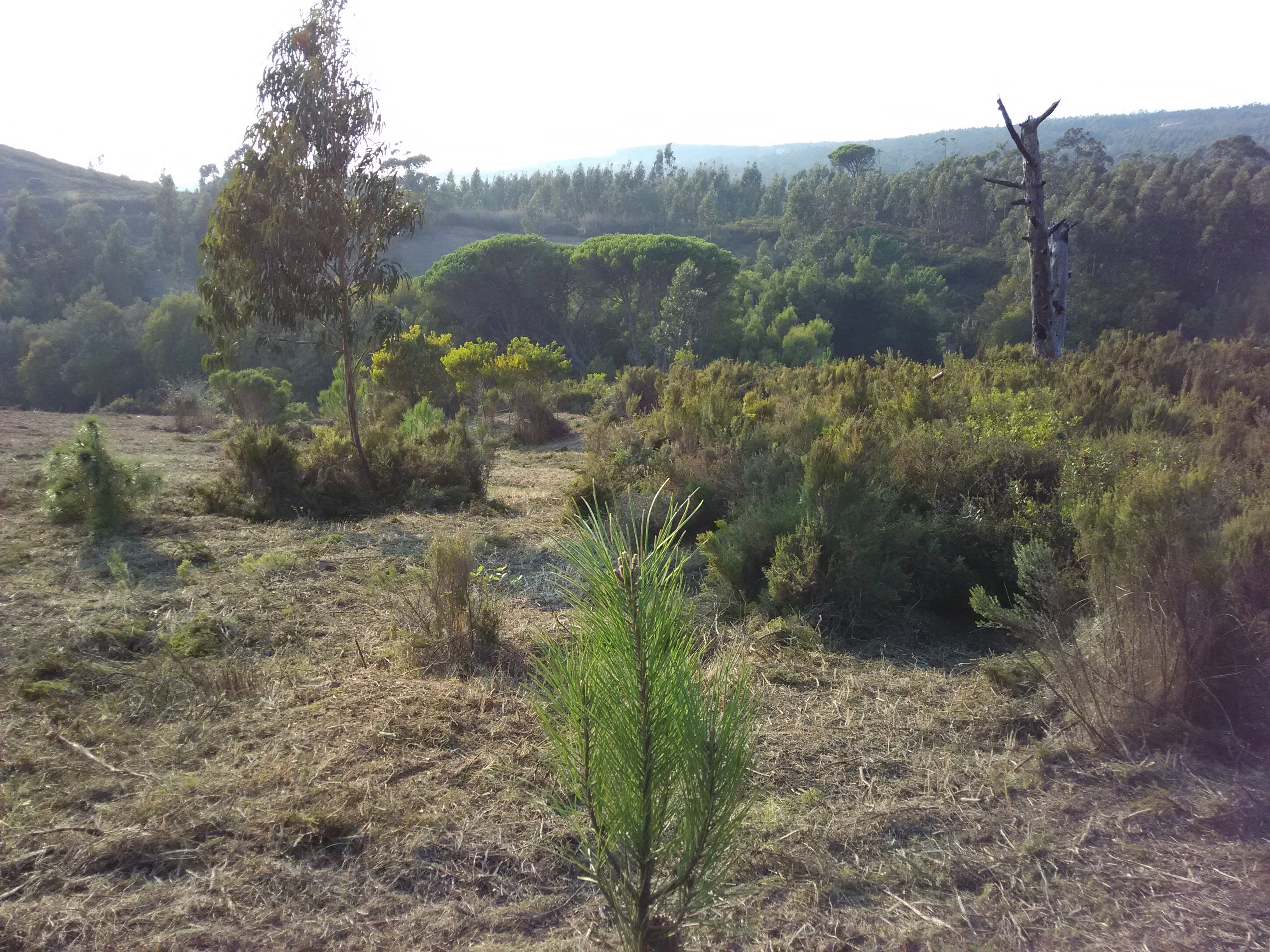

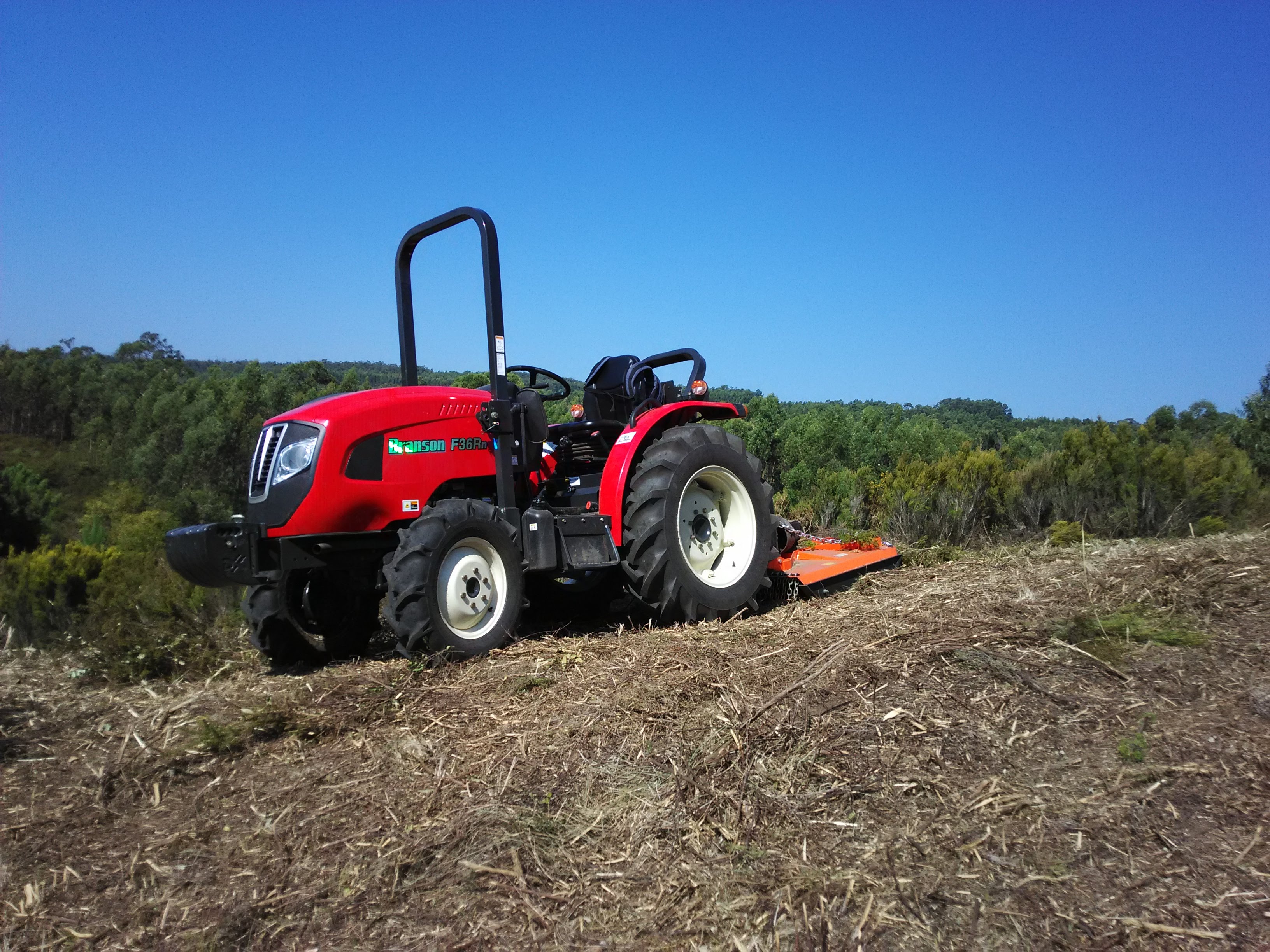

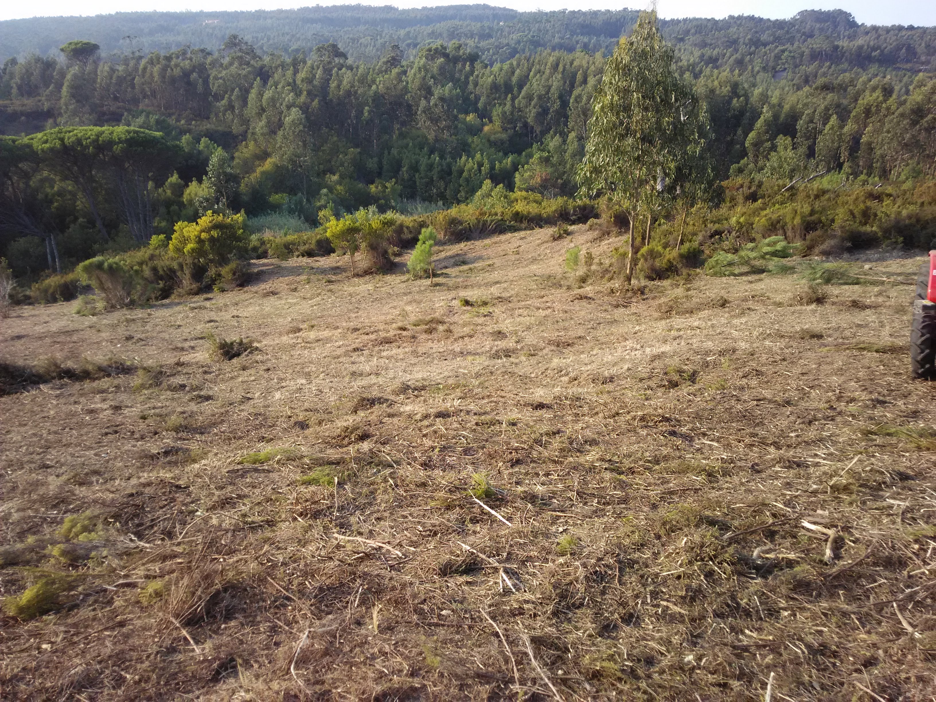

On a personal note, I've dealt with stuff similar to that, just with green leaves on it, with my 35 HP tractor. Actually it was it's break in period. Using a conventional brush mower but fitted with high strength chains instead of blades. These chains can handle thicker brush and rocks or whatever it's thrown at it without getting damaged like the blades would. It would handle that stuff shown by the OP just fine and the mower only cost me $700 new that I can use for all kinds of brush.
Here is a clearing job I did some time ago. The brush is believe it's called gorse bush in English, it's about chest height and at least 15 years old. Took me slightly more time because it's a very steep hill even though it's does look like much in the picture. It was about one acre job.
