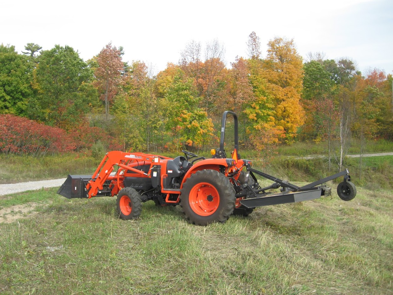

I have a braber/agriease 5' rotary cutter Braber Equipment - Rotary Cutter Its chinese but seems to be reasonably heavily built. 600lbs for a 5' and 725lbs for the 6'. It was a few years ago but it was $800 new and my only regret is not getting the 6' for a bit more. They have a real round stump jumper which the lighter duty name brand ones didn't, and the paint was sticking to it(I guess they are still allowed to use real paint in china?) Some of name brand ones had the paint flaking off at the dealership.
I haven't really bent the back of it yet backing into things and its cut lots of turf. I have a hydraulic top link so I angle it up and back into shrubs, little trees that way, then drop it right down to the ground. You can use grade 2 bolts for the shear pin, but I found they broke to easily and went to grade 5 and only break them when they should. Anyways, the brabers sure aren't HD commercial cutters but for the price and given 95% of the time its cutting grass trails at my place it does the job.

Thanks. I like the idea about the hydraulic top link. Maybe this is something I should consider, it looks like it would make a rotary cutter more usable with tall brush.
