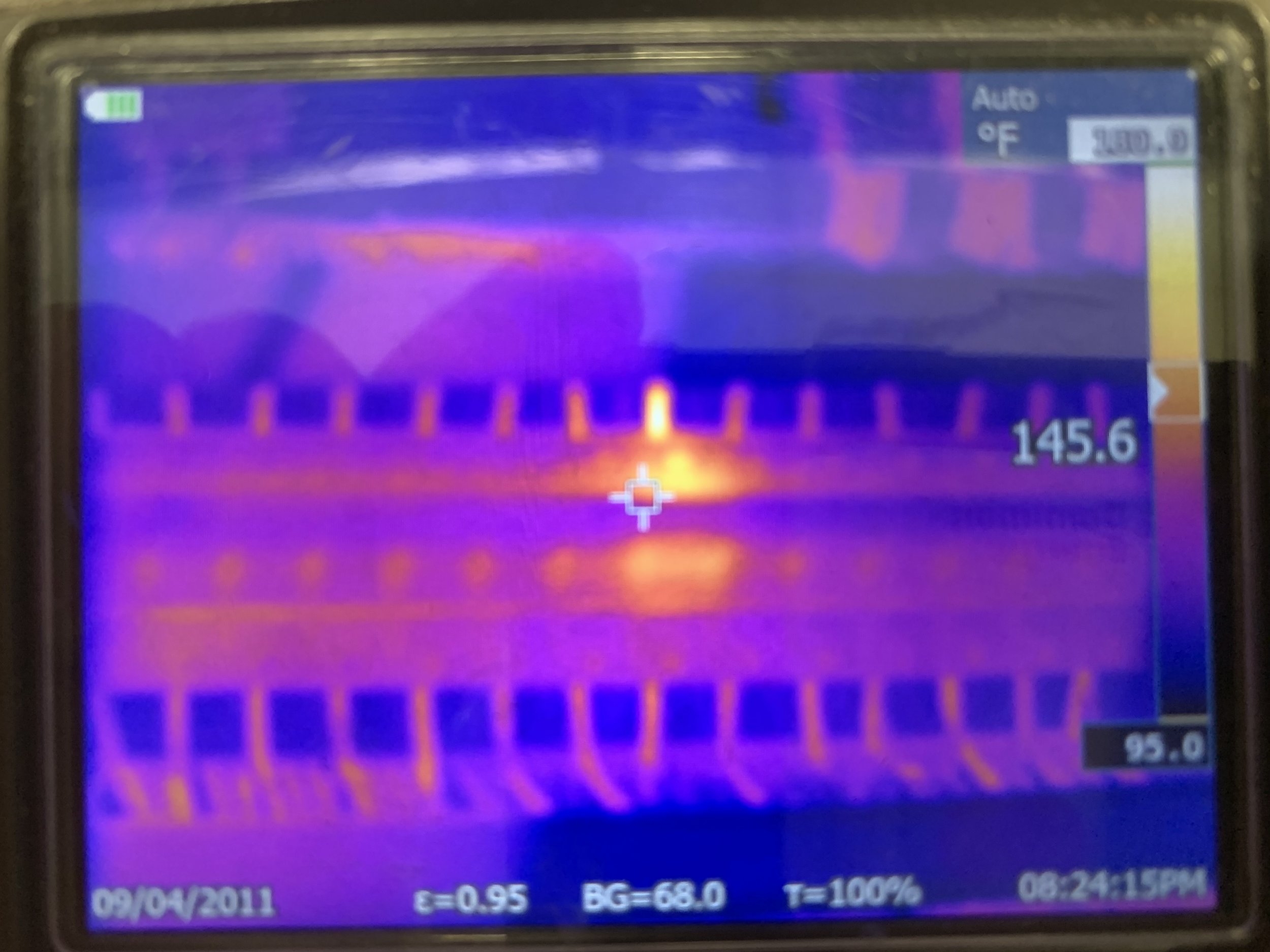

Here's the benefits of a panel thermal scan. The scan shows a loose termination at a fuse holder, reading 145F at the crosshair. The background temp is 68F
Pretty cool diagnostic tool.
