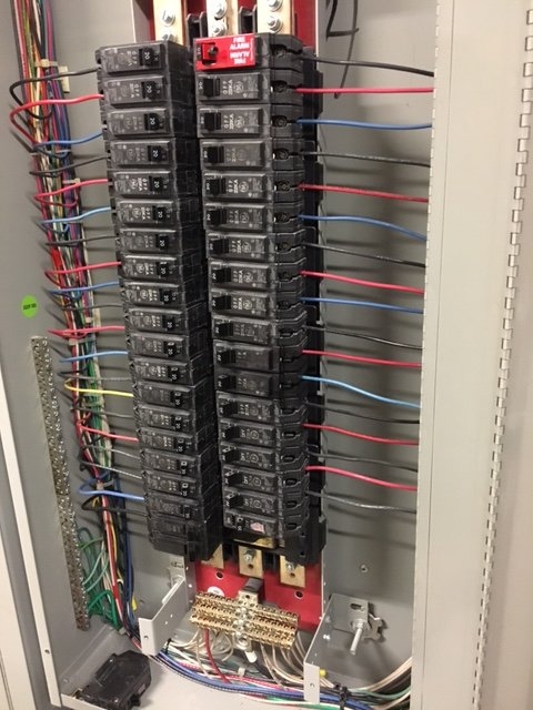

Got a call the operating room corridor hallway lights went dark... this is one of the circuits on the life safety panel.
This wing was built in 1995 and circuit is lighting only... no outlets ruling out something like a heater being plugged in and overtaxing the 20amp circuit.
Reset the breaker and went to investigate and found nothing amiss.

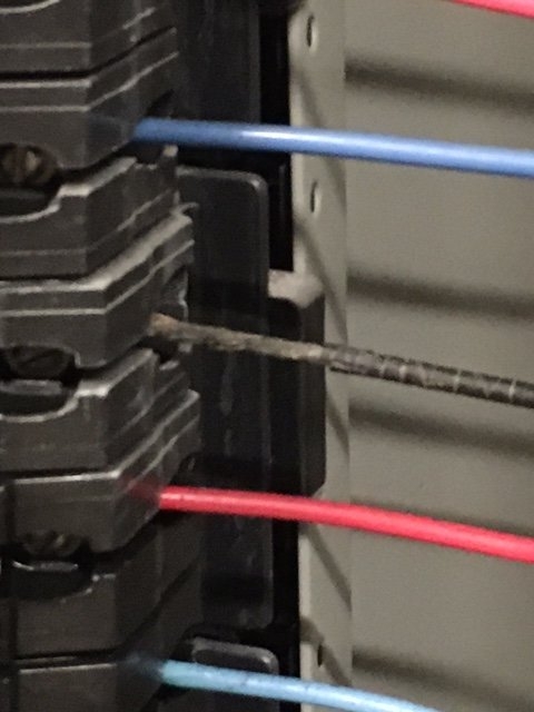

Circuit tripped again an hour later and I opened the panel.
I found a 12ga copper conductor with insulation charred and loose where the wire connects to the circuit breaker. It’s the black wire in the picture.
So for 29 years it was ok until it wasn't
Checked the other breakers and found another with a loose conductor...
The panel has been untouched and I would have been the only one touching.
Sometimes it takes decades for a latent defect to materialize is my takeaway.

Seen it alot of times. Wire was never torqued, so it kept heating and cooling causing arcing. Heating and cooling effects wire expansion and contraction.

Easily 2 dozen panels not counting the big stuff like the 480v panels ..
Job was signed off 1995.
Conduit everywhere overhead with some underground.
The lighting circuit has no off switch as it is intended to be on 24/7
The T8 bulbs were a new energy saving feature back then and the wing was the first large scale application in the city.
The only time a hospital 120v breaker has ever tripped is when a receptionist brought in a cube heater from home.
I have had a few issues when an HVAC compressor siezed up but typically it's a disconnect cartridge fuse that goes.
A lot of institutional building specific knowledge will go out the door when I do... especially being the byword is outsourcing.
This week a question came up for the architect... He did the original designs in 1993... I said let me call him and the Doctors and CEO said you know how to reach him?

For lack of knowing the technical term I just call it snowball effect. The same thing is responsible for many electric problems on cars and tractors. Trailer lights being one of the most common.
If for some reason there is voltage drop across a connection ,resistance grows with each heat cool cycle or passing of time until problem becomes apparent. Had lights been switched off and on every day the same thing would have happened much sooner.

Your panel probably had solid wire, so it would most likely have been due to lack of tightening during termination.
