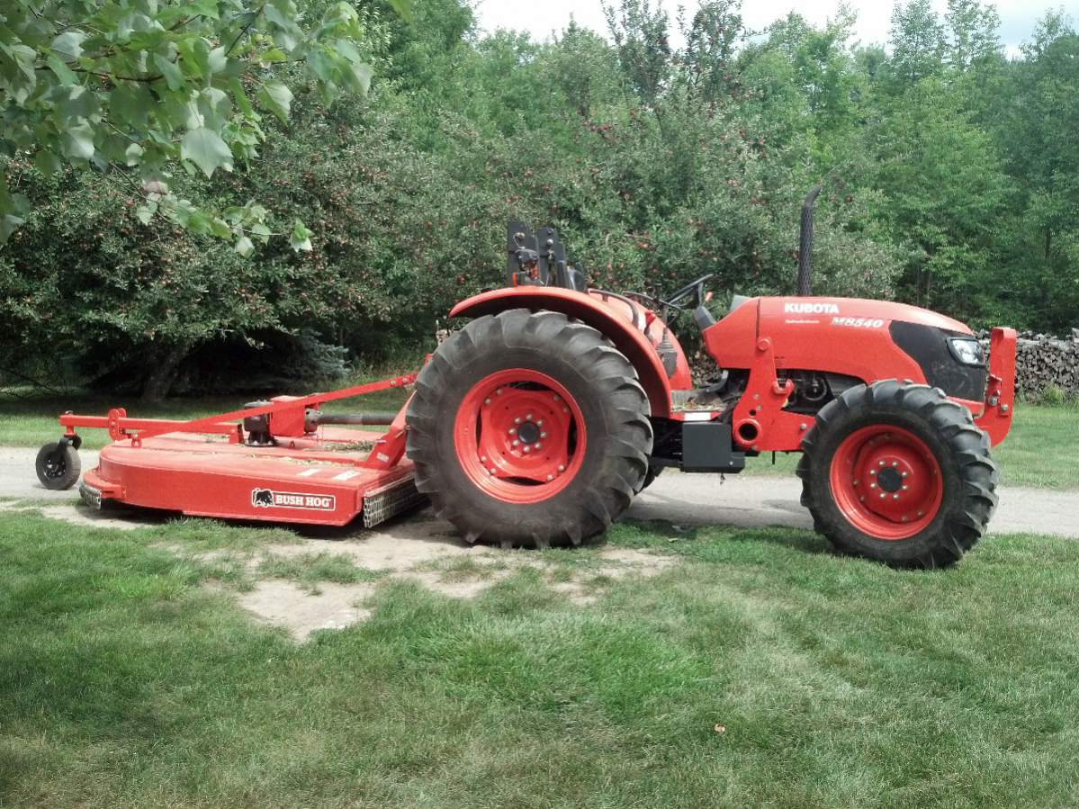

Yep. Land Pride wasn't on stock and I've got BH27
I bought a bh27 last year for my M8540. ive hit some 4 -5" box elder on accident and its held up well no dents. Stuff looked pretty small up 3 feet off the ground mowing in 4 foot tall brush
The one piece made so much of a racket I cringed and shut off the mower and got off the tractor. Expecting to see dents everywhere. Nothing still looked new. The only thing thats happened is that the brackets that are welded on the deck by the tail wheel that connect the struts from the top link connection bent slightly while in transport mode going down the dirt road at 21 mph and hit some bumps. Now that they are in line with the direction of pull I dont think they will or can bend much more
To me BH27 looks better and more robust than equivalent Land Pride unit and I'm glad that it works well for you and should works for me too. Didn't have a chance to try it yet but should soon.
Is there anything specific I need to know about it in your opinion?
Nothing other than the obvious check the gear oil before you mow with it the first time and ever season. Sometimes dealers forget this step in the prep. Keep the zircs lubed on the shaft and check the slip clutch in the spring to make sure its working. Its pretty much plug and play. Oh yeah try not to take out any fence post trees etc when turning it feels like it sticks out about a mile behind the tractor.
