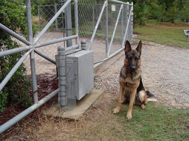

The gate into my place is always closed, unless a friend has called or there is a delivery. So, no one wanders in and there's no excuse. It's a secure feeling. (However, I don't want to be lulled into a false sense of security, I know).
Anyways, back to Deere755. I think someone was casing his place and got scared off by the dog. The deputy said the crook may be back according to the first post in this thread. I think the deputy is right. Most folks said to keep things locked up and put up a camera and wire a horn system. I think you should also keep your gate locked...if you have one. And it may be worth the money to get one of those gate openers where you have a clicker and don't have to get out of the vehicle every time. Then it's easier to keep the gate shut all the time. You should expect them to come back and plan accordingly. And even if they don't come back, you will be in a much better position in the future. And I agree...death to anyone who kills my dogs...
