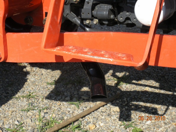

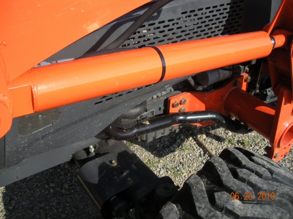

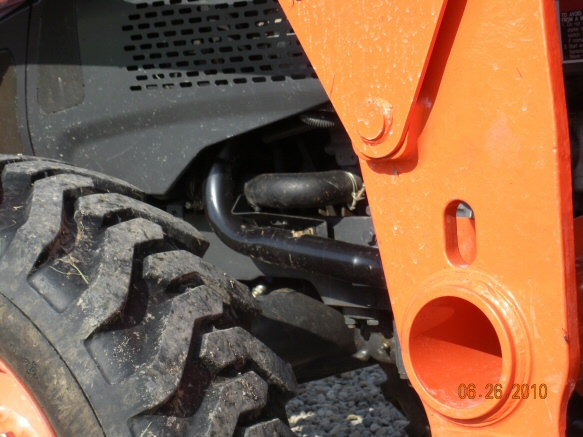

I took my L5740 to a local shop that had a tube bender. In about an hour they made this piece up for me. Ever since I got this tractor, I have been aggrevated with the soot on the FEL. I think I finally got it fixed. Hopefully the pictures work.

good idea that soot makes it look like something is wrong with my tractor. I think I will steal your idea.
   / Soot on my FEL #33
Aren't you going to have soot on your step now? What about smoke in your face since its so close to the operator's station?
Just curious.
   / Soot on my FEL #34
Just curious.
No smoke in my face, as it blows down and out. It is just below the step also, so no soot there.
I could have taken it straight back out the back, but I like to see it smoke when it works, so all I have to do is look down now.
I have a lot of bush hogging to do in the next couple weeks so I can share an update then. As cheep as it was, if I have to redo it it won't be too bad. Why Kubota did it like they did is simply beyond me. That must have been a Monday morning design.

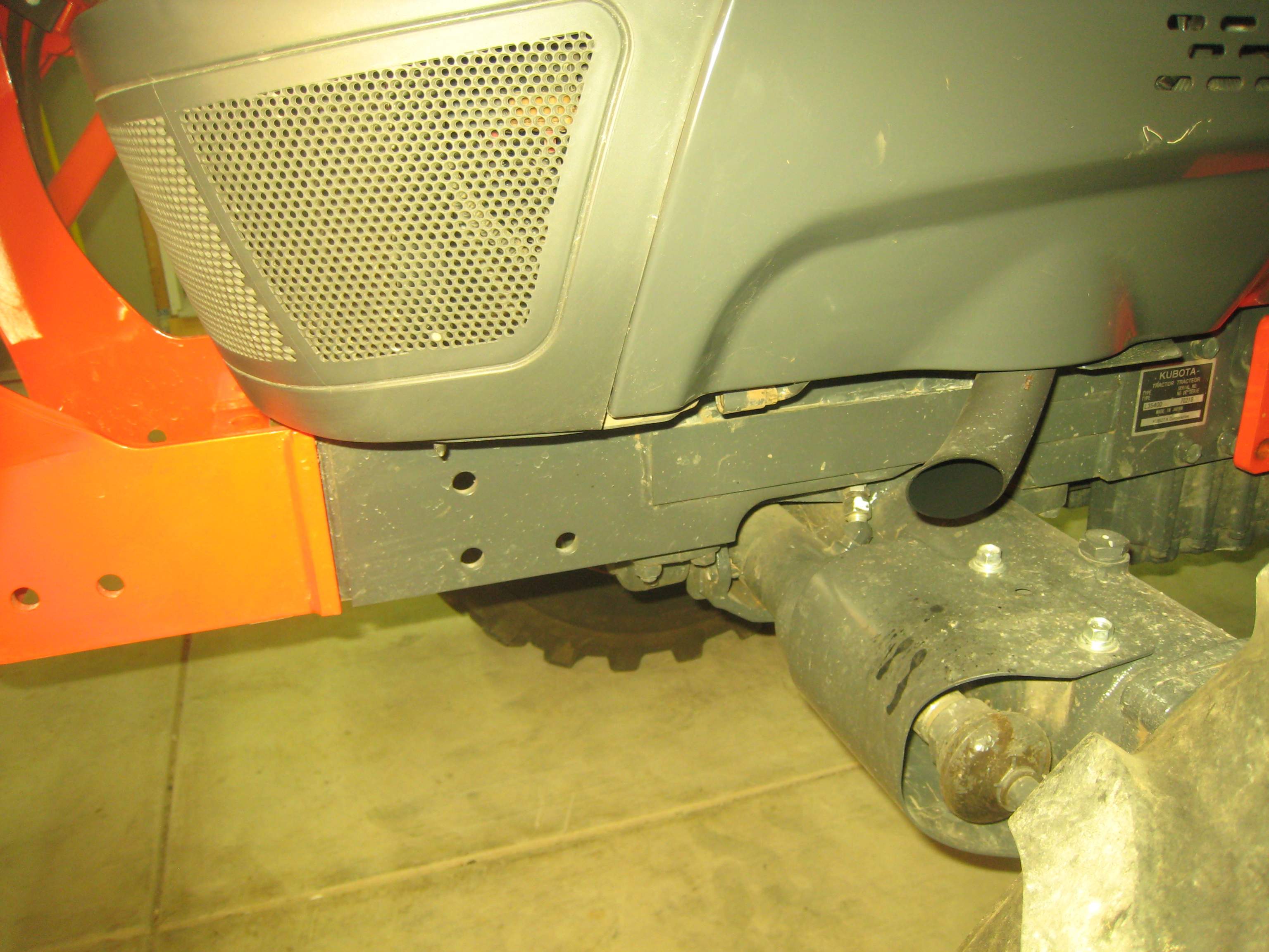

Paul,
Looks like the engineers have been reading your posts! I'm getting ready to do an exhaust mod and was dreading having to drill my frame for the support bracket. To my surprise, there were already 3 pre-drilled holes to choose from. I guess you must have inspired somebody at Kubota engineering! See photo!

Thomas it's funny you said that. When the Kubota road show came to town a few months ago I was introduced to the guys running the show and they told me hat my threads posted here and other places including my Youtube vids have been emailed around the kubota world. The one question that they did specifically did ask was how I got the reverse beeper to work. I gave them the related threads and they told me they need to make a kit for the beeper because they have many requests for it.
As for the holes in the tractor. Mine had one and that's the very one I used. All that being said IF I never had the cab model I wouldn't use this design because you will get fumes coming back at you. I would go with a stack or go the way I did but follow right out to the back of the machine with a tail pipe. Just my 2 cents worth.
