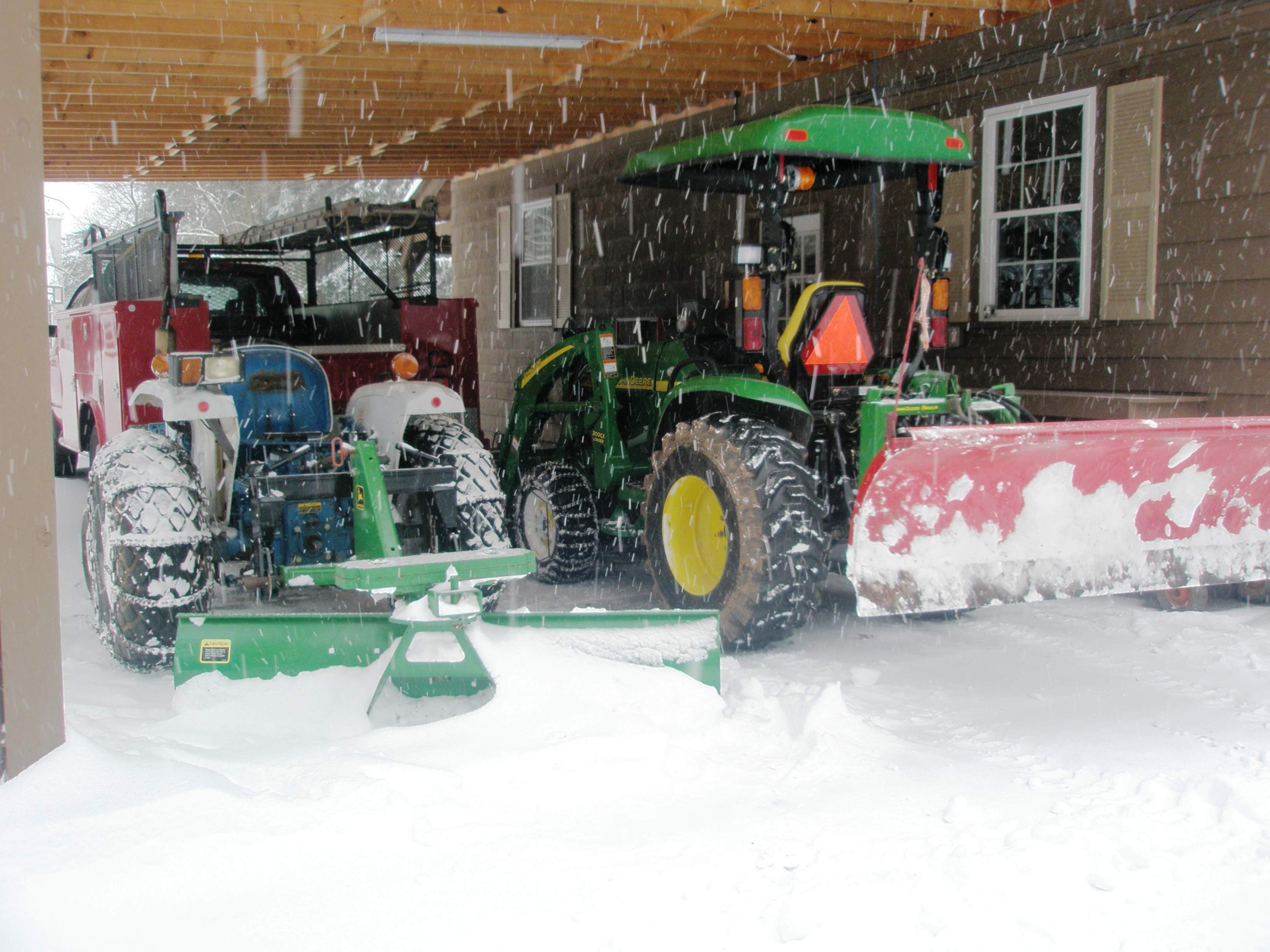

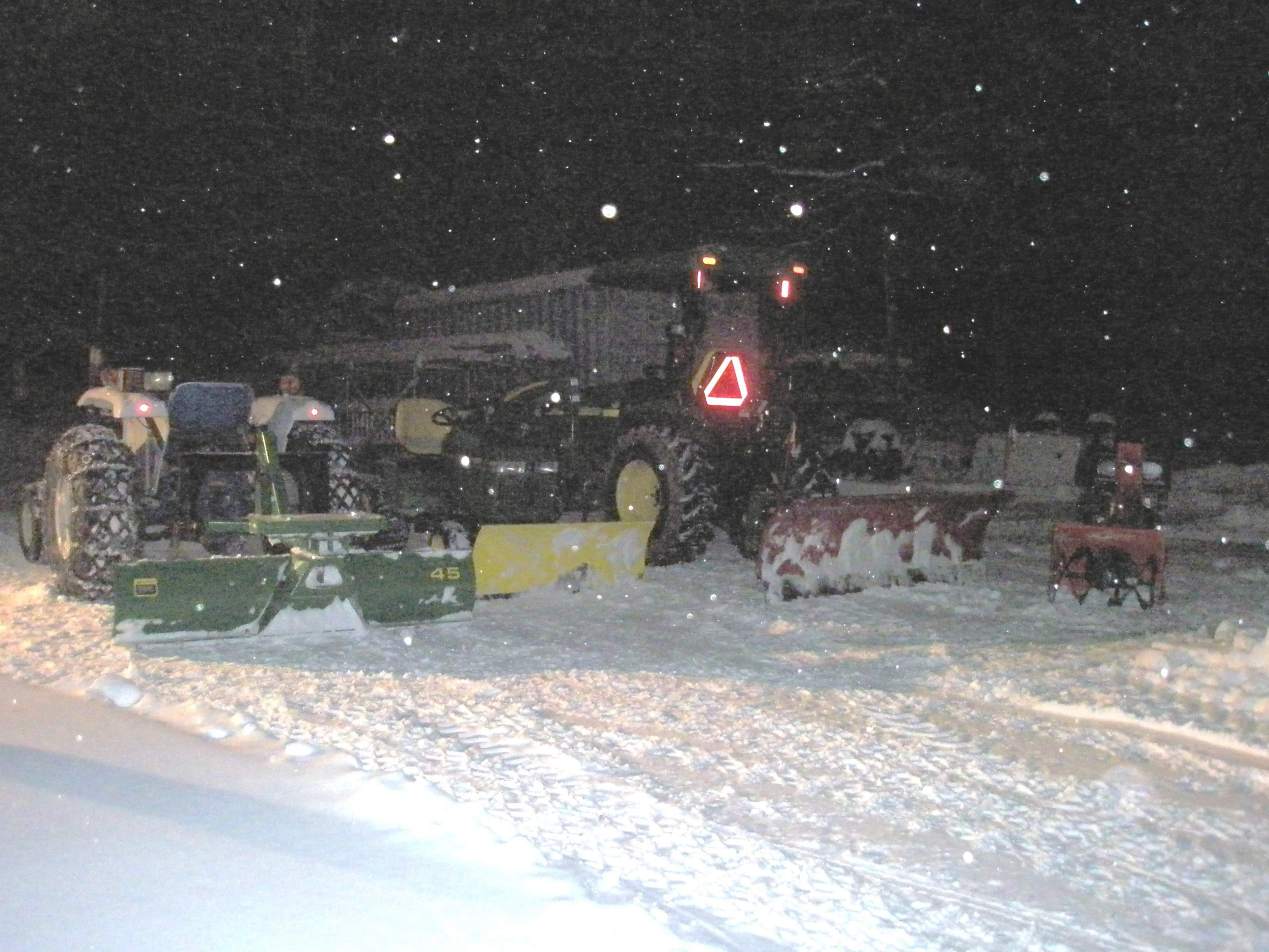

Not sure how much is much but we do get snow, and I am concerned about it, it's only been up for a few years, last year it had over 2 ft built up, I did shovel a few paths to let the water drain in case it rained on it or melted fast, but it never did, just melted slowly.
I didn't get an engineers stamp of approval that's why I said don't follow my specs, I simply looked at other similar sized structures and made mine heavier or the same as the others I'd seen. The heaviest framed one I saw with the same overall dimension was on a town owned maintenance facility, pretty much copied it. Figured if it's good enough for Govt it should be good enough for me.
Actually saw a 20 ft wide carport on a house framed with 2x6 rafters, I know that's under built but it's been up for 20 years, I'd really be afraid with snow on that.
The light weight of the rubber is a benafit but it's more about how water/weatherproof it is, especialy on low pitch roofs where shingles could not be used.
