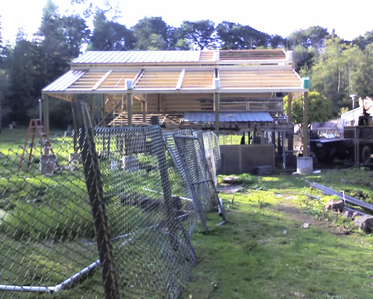

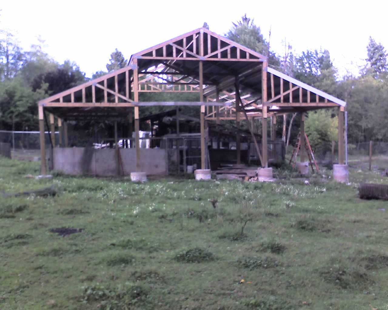

Around here, 12 foot spacing between engineered trusses (done by truss co) is common. I had 12 - 12 ft half trusses and 6 - 18 ft standard trusses made. Here are a couple of pix.

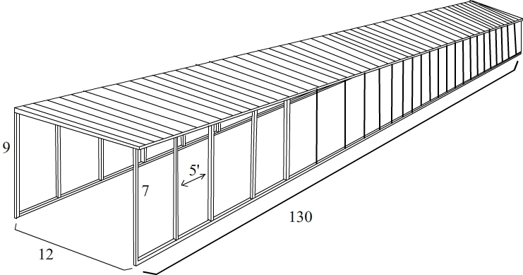

There's this shop I know of in pioneer, ohio. They'll make a steel framed lean-to 12 wide x 30 x 10 with a 12 ft peak for $2490.00 installed. You wouldn't have to do labor, I found out if you wanted to pick the kit up your self you could get it for 10% less. For that, I'd just let them build it. They use 2.5"x2.5" 14 gauge galvanized with 29 gauge sheets. I did a sketch in paint to show you what it would look like roughly. There's comes with local code snow load guarantee. That's a good deal in my opinion.

here's that sketch I did a while back for a friend of mines barn

I'm sure they can fabricate a building system wider than 12. It was my understanding that it starts to get expensive when they do.
The barn was 130 ft long and 12 ft tall at the eve. He planned on having this free standing lean-to on the side of his barn. He was going to put 15 ft header bars every 20 ft, so that he could access his tractor attachments.
