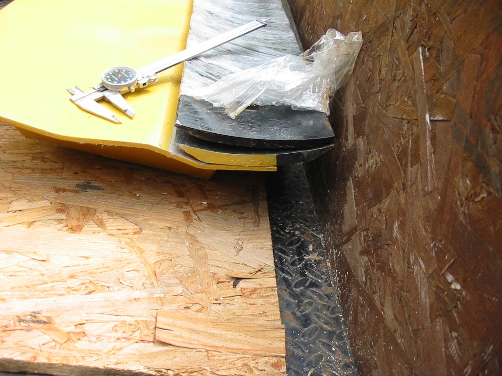

There is a place called Behlin Country that has them. $99 plus $29 shipping. The only thing is they are only 3/8" at the thickest point. All of the 6' Behlin Country 3 point attachments use this so it must work.Who knows how it holds up to hitting rocks and such.I would be using the Land plane for gravel drives so hopefully most large rocks will have already been dealt with.
It looks like the 1/2" version weighs 58lbs and the 3/8" version is 39lbs. so it can be shipped by UPS as opposed to needing a trucking company. I ordered 1 to see what it looks like and I will use it maybe for the rear blade or just pushing snow. I noticed when you order 2 the shipping goes up to $160! So you have to buy them 1 at a time or the shipping kills you.
I have attached a picture to show how they look side by side. Again any help thanks in advance!

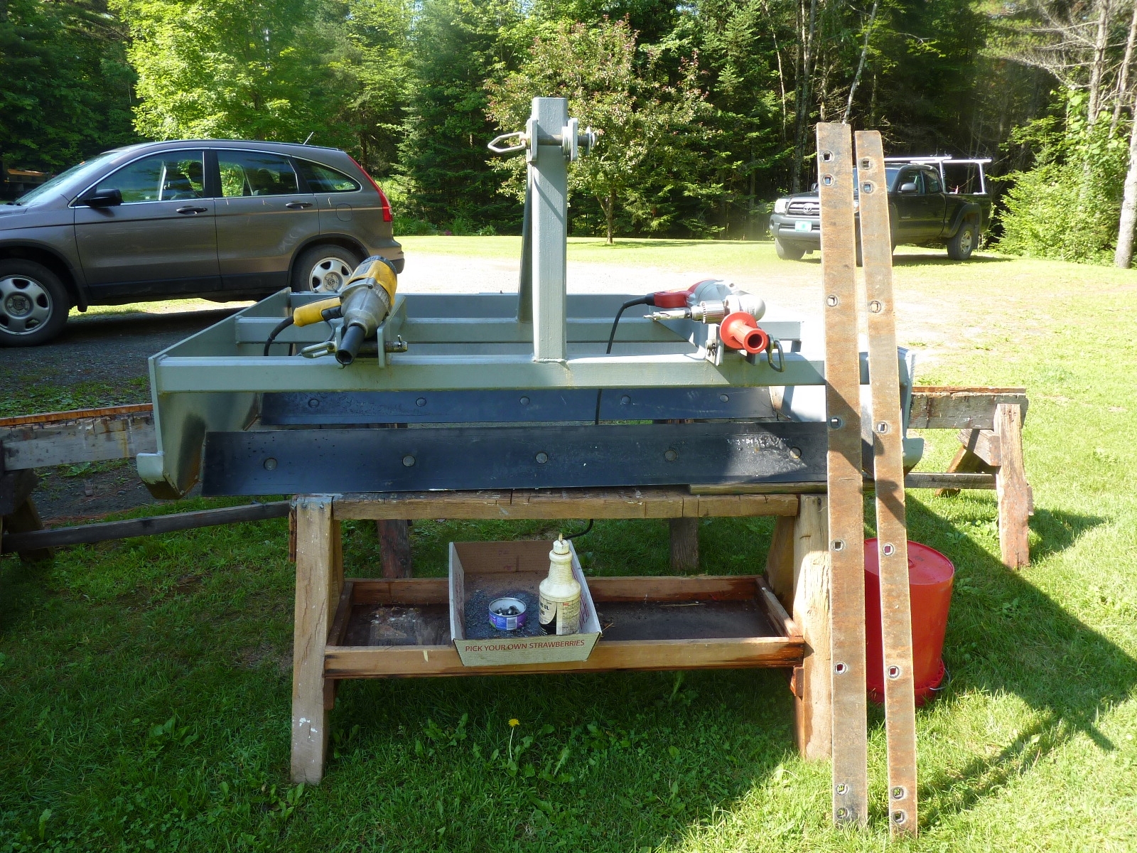

As you build your land plane consider blade wear. My Road Boss LP has the blades mounted on an angle. The angle is mounted in slots that allow downward movement to compensate for blade wear.

DTLS - you mentioned 3/8" cutting edges. When I first built my LPGS I found some new 3/8" edges used on a light duty LandPride rear blade. I had to replace them after 4 years of use on my gravel drive/road. That was in 2014. I replaced them with standard 1/2" cutting edges and after 9 years they are still good and I haven't flipped them over yet. So IMO the 1/2"ers are worth the extra money.
New and old edges from 2014.
gg

Just in case any of you building your own pull behind land plane want to look at a few pictures of mine, there are a few posted...
David from jax
Due to Photobucket doing what they did, these may only be available to you as thumbnails pictures.
