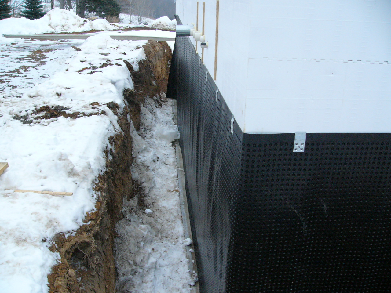

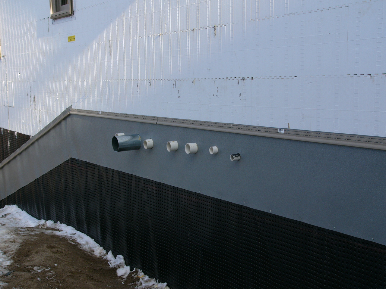

The foam below grade will be coated with a fiber mesh inbeded in an eslatomeric base. This is really just a secondary water prevetion. The key to a dry basement is an unobstructive path for the water to fall straight down to the footing drain. I will back fill mostly with a clean drainage gravel. Since the basement hole is mostly in sand stone, I will have very little dirt pushing or infiltering ?sp to the gravel.
Hydrostatic presure is the issue.

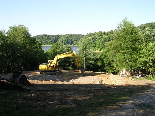

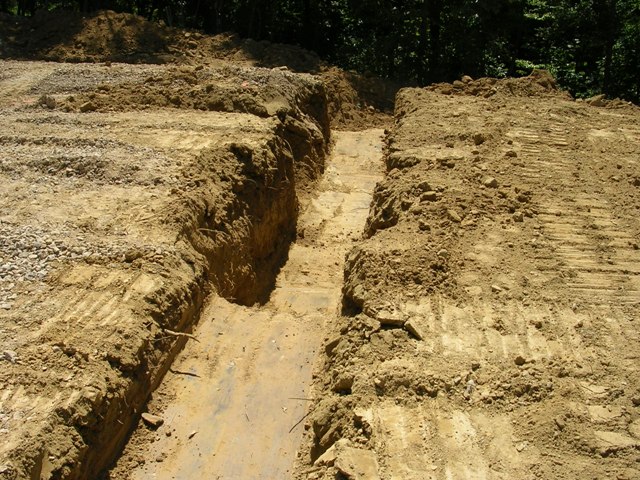

I was out at the site while the step footers were being dug. The home is on quite a grade and needed steps. Also, here is the view we will have of Lake Monroe
Patrick T.

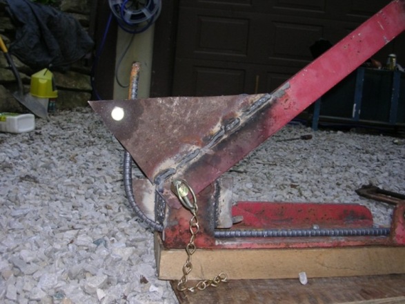

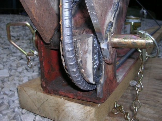

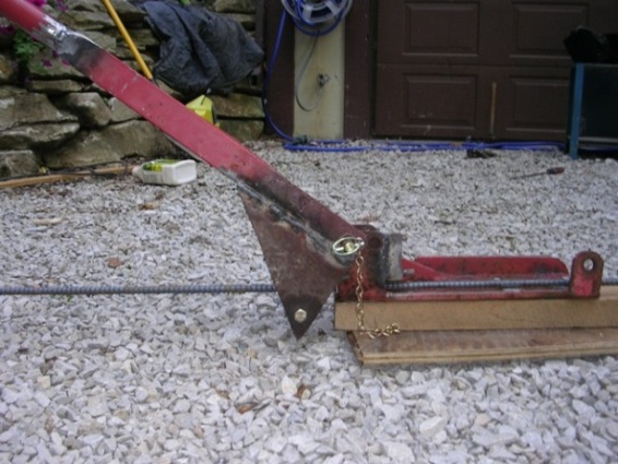

I needed to have a Rebar bender for this project and just made one. Funny, I used an old Ford FEL section. Good solid hing point. Soundguy would likely recognize it! First I made a mandrel with the correct raduis. Also, I made a grove so the Rebar would tract nicely. Then, using the old Ford FEL part I welded the set of leverage points, the triangles, on to the lever arms.
Works good with 1/2" rebar. I would have tried 5/8" but Lowes did not have it
Patrick T.

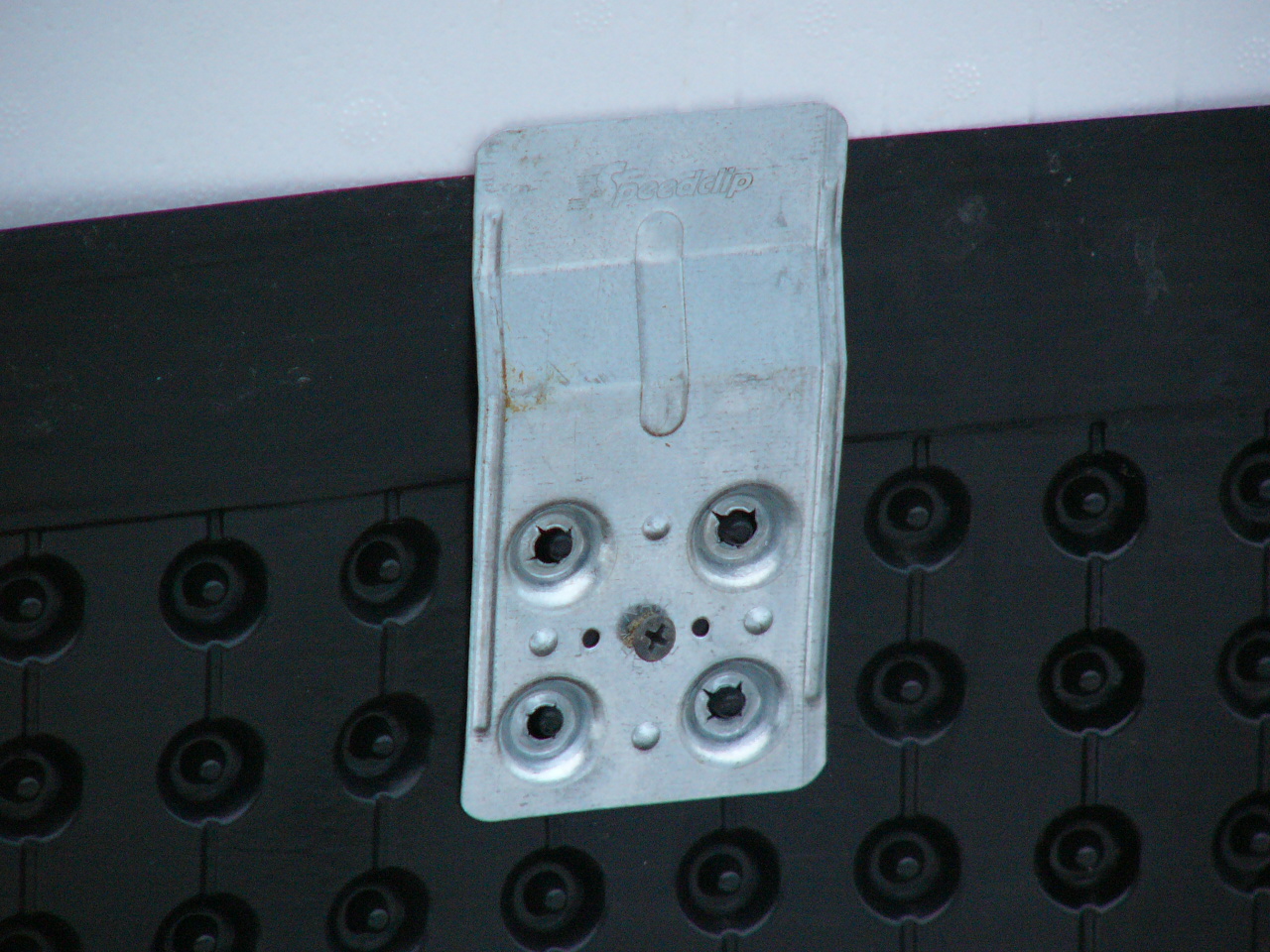

Here is the protective barrier that was installed on my ICF home.

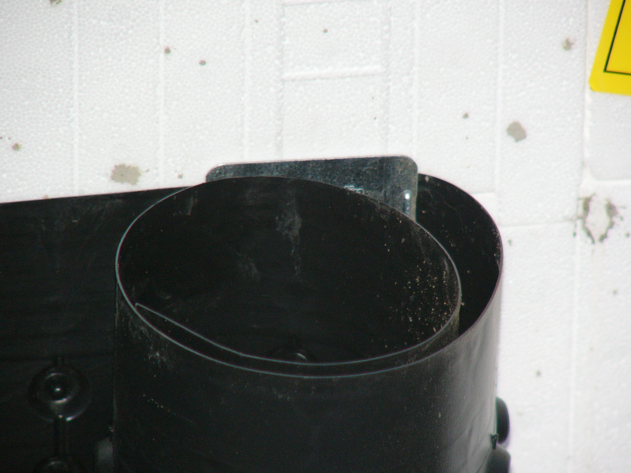

The previous post was of protective layer below ground. Here is a shot of the covering that was used below the siding to protect the ICF in that earth/siding transition zone. It was a fiberglass looking product, it had a hard glossy/pebble finish to the exposed side. It came in a roll, I think 18" wide 50ft.
