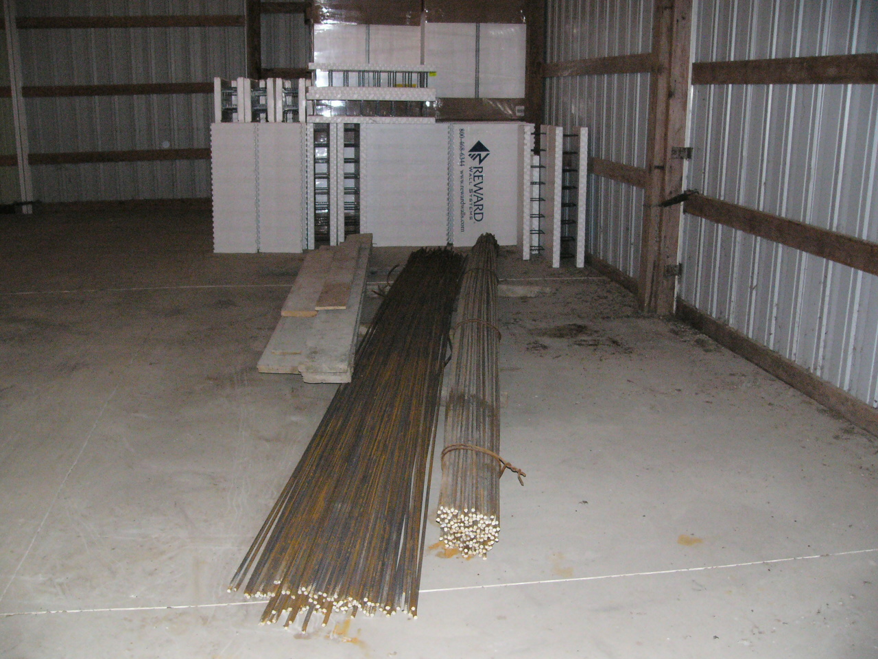

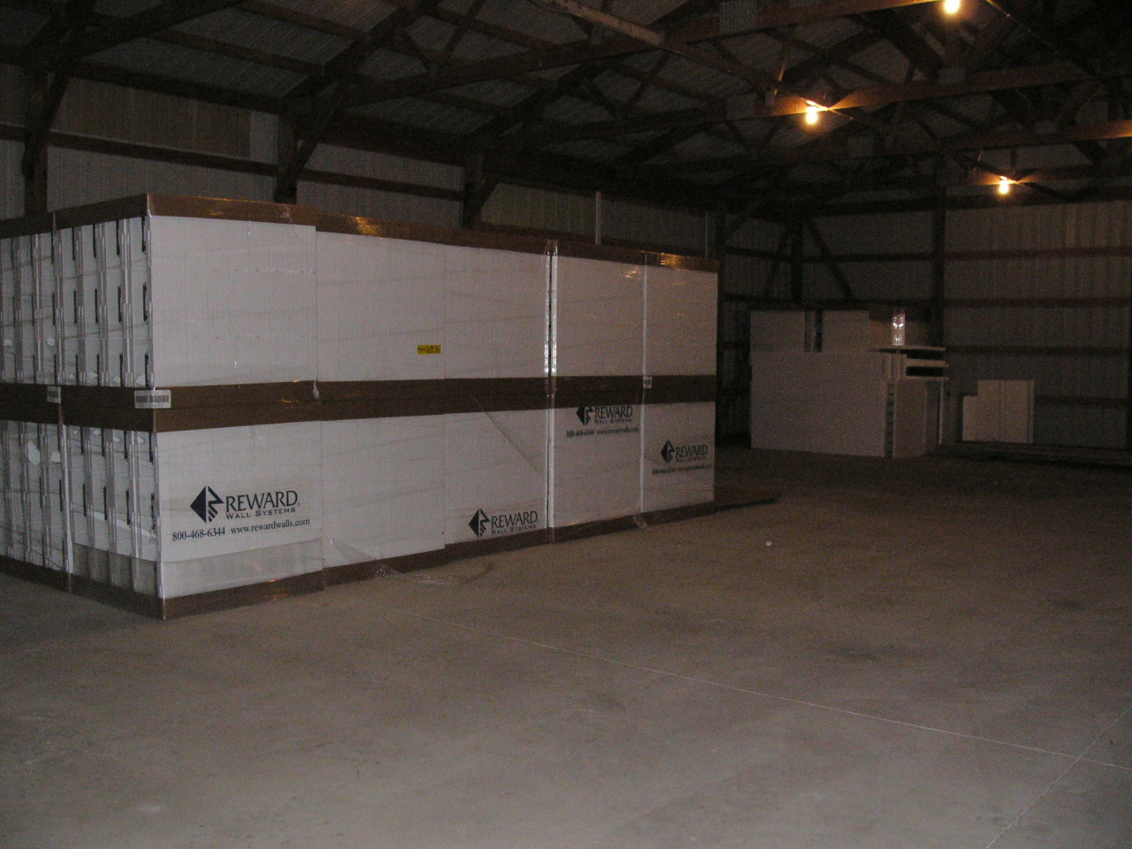

Here are some shots of the materials in my pole shed before they started. The rebar used (4000lbs of it!) was 5/8" every foot horizontally and every foot vertically.

ding2520,
Thanks for the material up date. Looks good. Are you finished? The "dimple" material I saw while at the Las vegas World of Concrete show in Feb. I will be back filling with mostly gravel to insure a very good drainage. Also, the basement hole is mostly dug in stone so not much dirt!

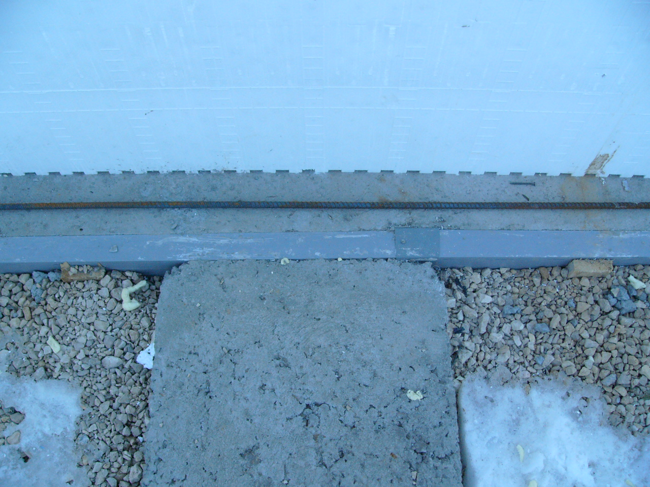

My Inlaws are a RewardWall dealer in southern Indiana and we did a RewardWall basement for our house. They use that same protective barrier that was pictured above. Arm-Tec I think it's called. We used it on our basement but we had some special screws for attaching it that had some kind of self sealing washer on them. They screwed right into the plastic 'studs' in the RewardWall.
They use Form-A-Drain for their footers. Form-A-Drain is basically a hollow perforated plastic 2x6. You connect each piece, level them, and use them as the forms to pour your footers. Then you've got a drain set around the footer of your basement. It does very well in keeping your basement dry. We've not had any problems yet.

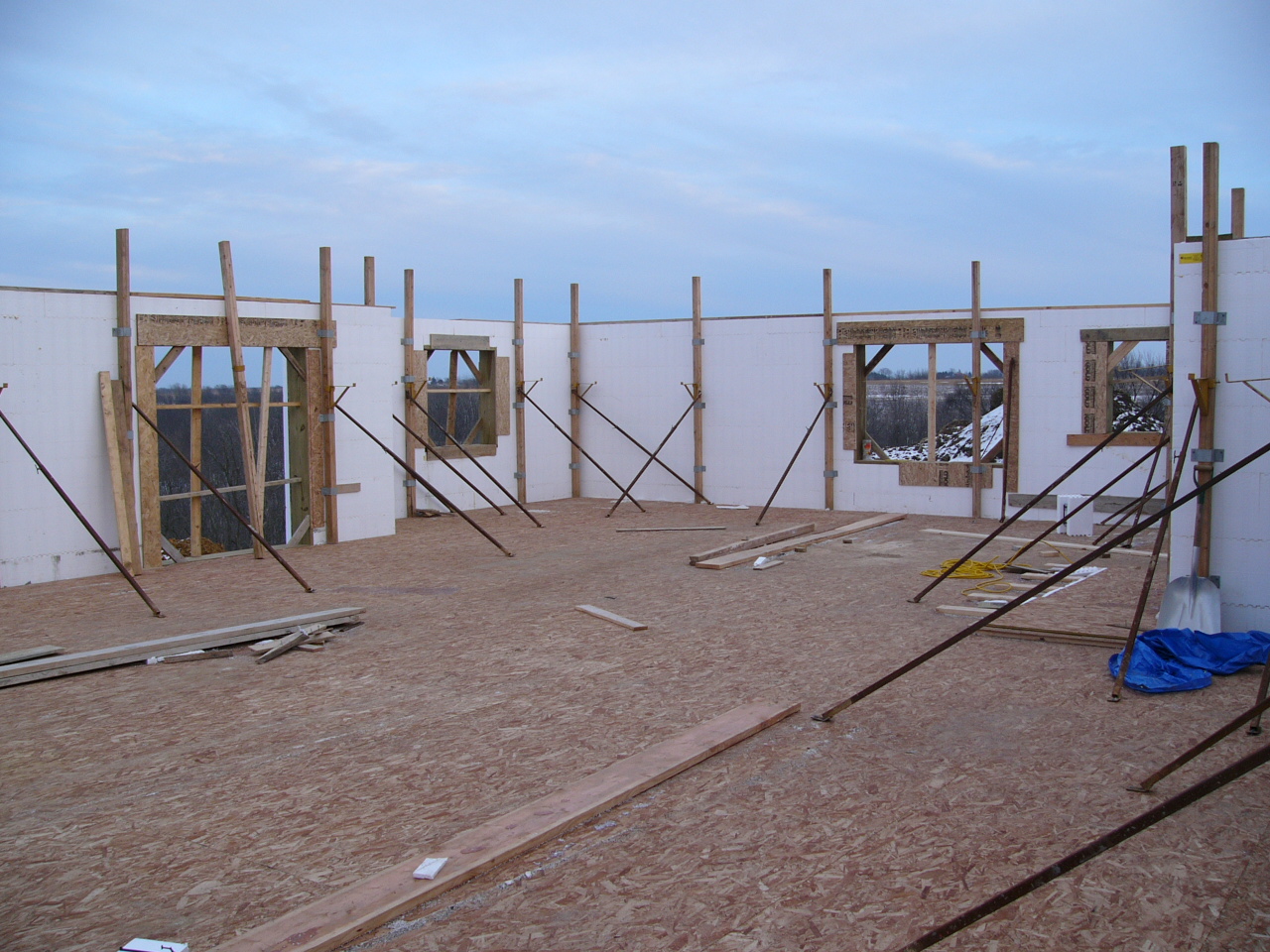

Here are what was used for supports for my walls while pouring and a shot of the PVC form/drain that you were talking about. The shot shows a footing for an internal wall in the home and the form/drain is running along the outside wall footing.

3RRL,
Are you building an ICF home as well? A word of advice to anyone building an ICF home, always use electrical PVC when coring through the ICF. Even if you don't think that the pipe will ever get used for electrical. Inspectors think that electricity can't find it's way through anything but the gray stuff.
Put in more access pipes than you think that you will need. Add the extra one for the gas fireplace your wife may want in the future. You can cut them flush with outside wall of the ICF and install siding over top of them, pack them full of insulation and slip a cap on the inside. I ran a 4 inch PVC pipe from an outside wall, 34' under my garage slab into my utility room for that corn burner that may be in the future.
